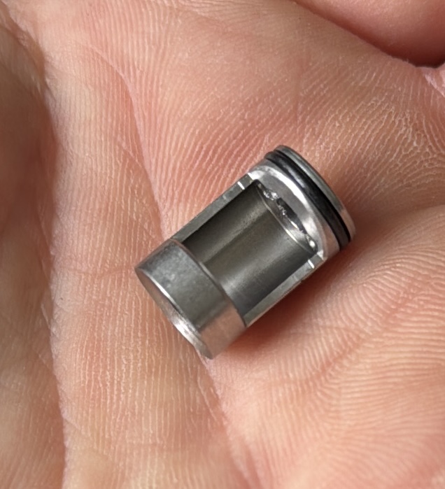

Check the valve seat. It can rotate and choke off the transfer port. My friend's panthera had this happen spontaneously for some reason.
