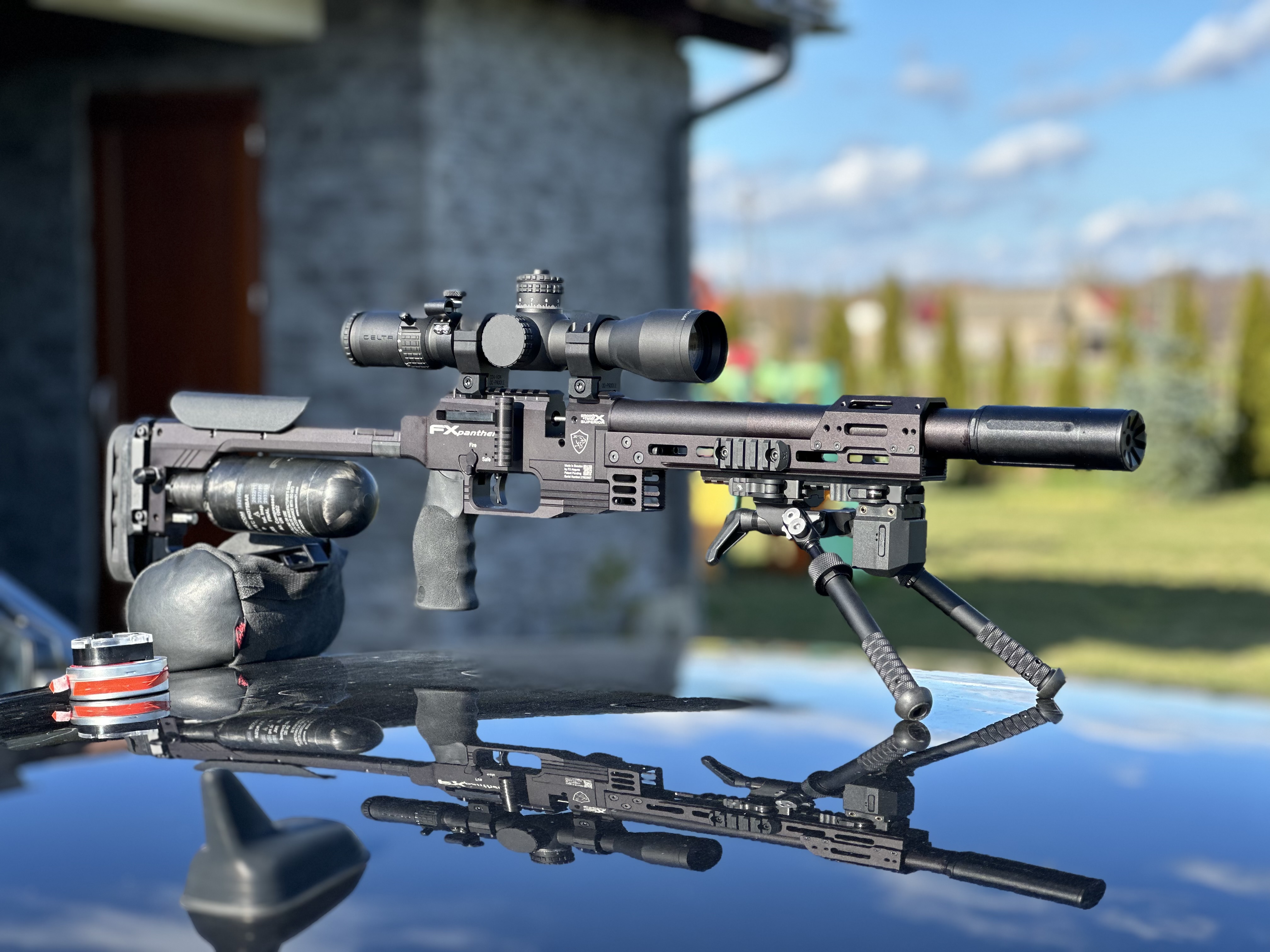

Hello guys,
I'm looking to buy a Panthera Compact.
It comes with the bottle on the front, under the barrel.
My idea is to buy the fx short arca rail for the panthera and change the bottle to the stock, like seen on the "regular" size pantheras. Making it like a stubby version of the panthera.
Does anyone knows if the threads are the same on both "holes", the front and the stock?
If I can just switch the positions of the bottle screw and the tapping plug? So the bottle goes on the back and the tapping plug on the front?
Thank you in advance for your help!

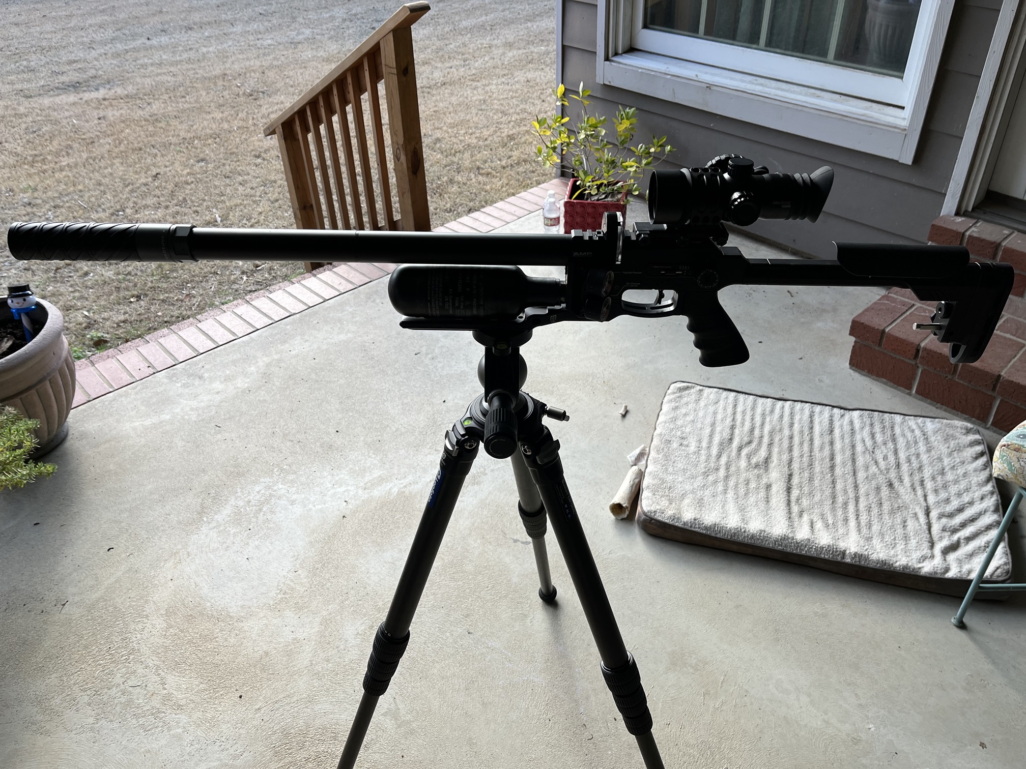

The black raised/rounded factory plug on the rear stock will thread and block off the front, but it isn’t flat or countersunk. Using this will prevent the compact rail from sitting flush and cannot be installed. You will need the bronze block off plug that is specific for the front.
Reactions: farmerjoe99
Here is picture showing the rear black block off plug installed on the front. Notice how it doesn’t sit flat/flush. The (full) compact rail (w/barricade stop) could not be installed with this plug in place.
Here is picture showing the rear black block off plug installed on the front. Notice how it doesn’t sit flat/flush. The compact rail could not be installed with this plug in place.
Let me clarify, if you want to use the FX compact rail, it comes with the barricade stop which is a separate piece from the compact rail itself. The rear block off plug as shown will prevent installation of the barricade stop or another compact rail such as the KL compact rail which is an integrated design.
