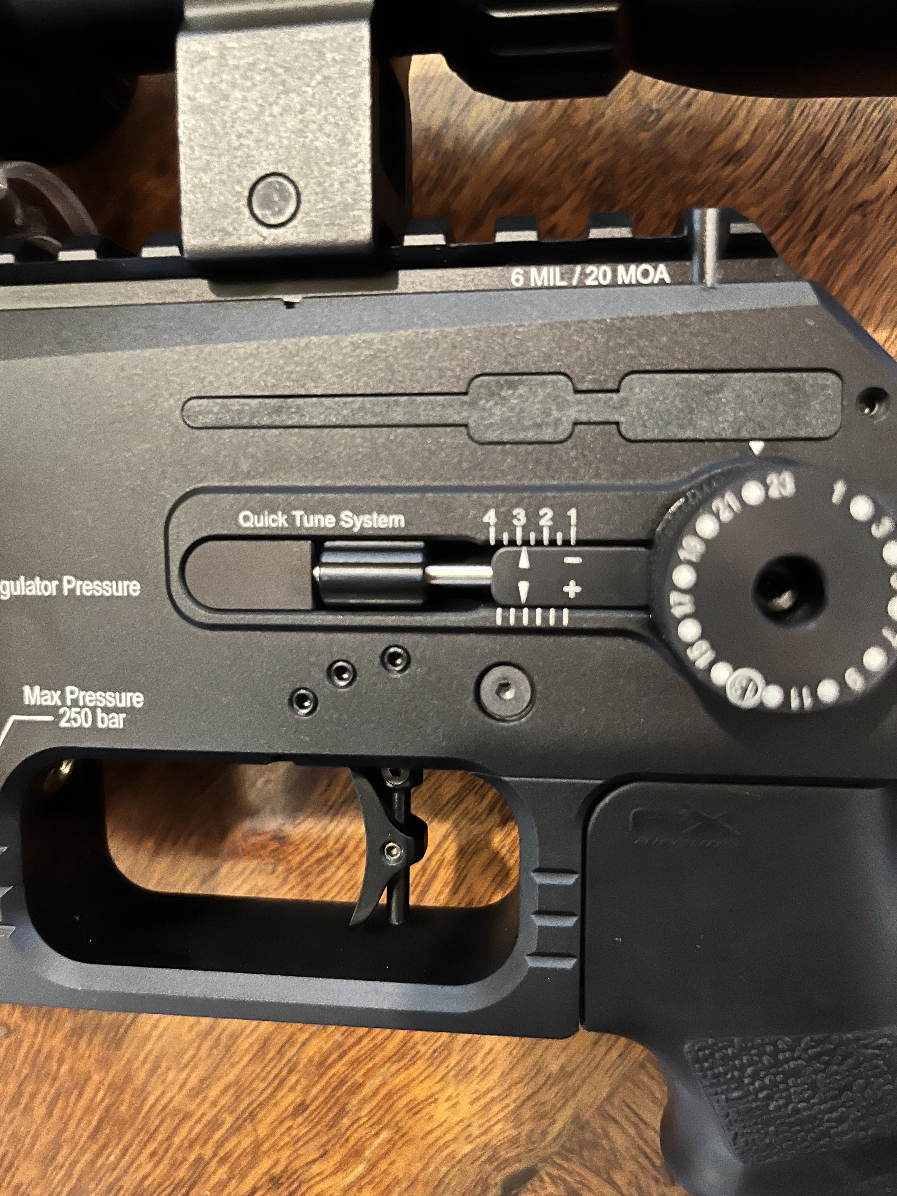

Micro adjustment arrived at 2.75 aprox.

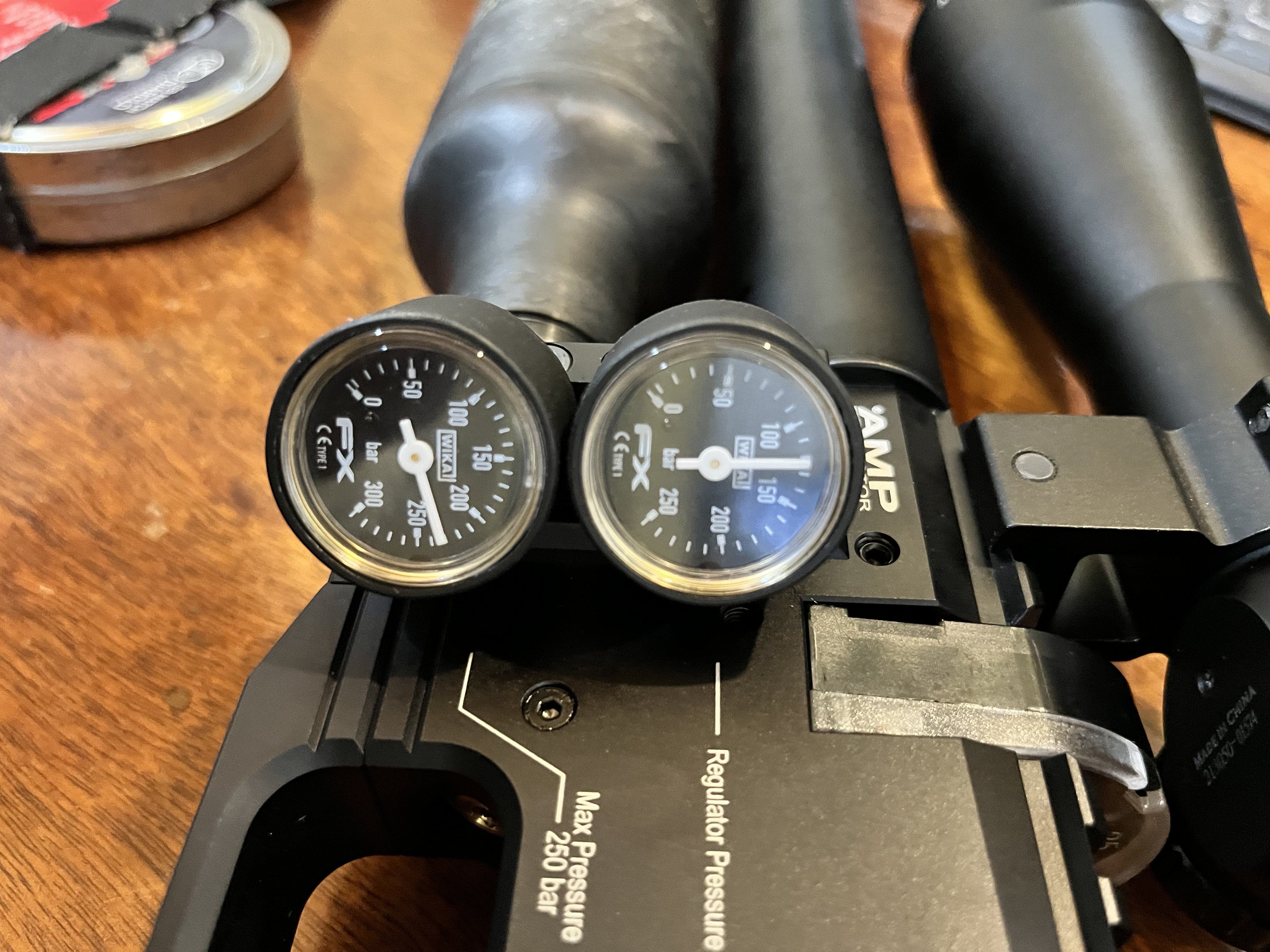

Tank manometer arrived at 150 bar and regulator manometer at 122 bar.

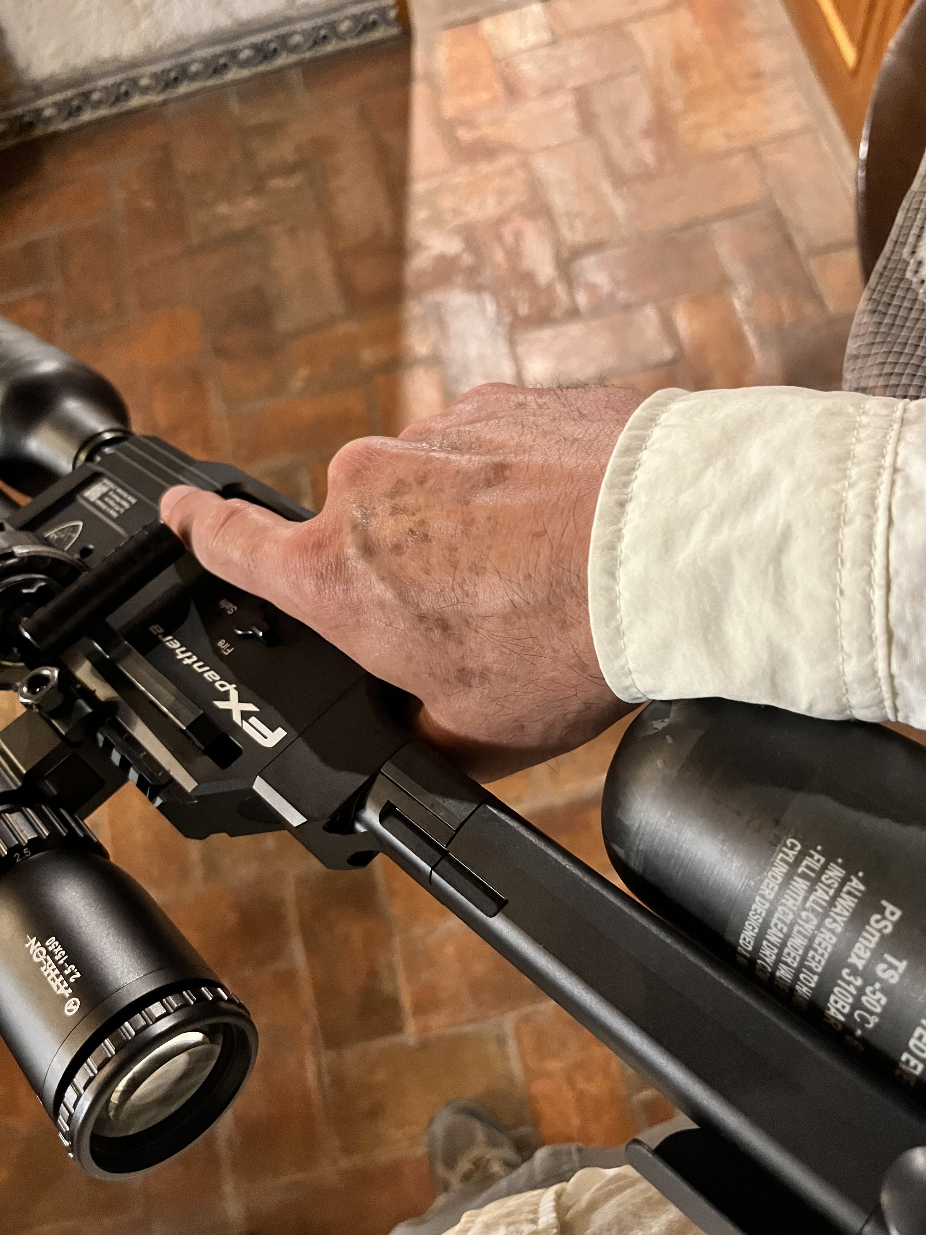

When the right hand is in the grip, the right wrist is touching the rear bottle.

After the chrony I think I should dial the macro weel lower in order not to force the tension of the hammer.
Nop….. What I just did is to make the 13 number of the macro adjustment to match the 2.75 of the micro adjustment. Now the macro adjustment weel shows show as 13 the 2.75 of the micro that worked perfectly.

This is how the wrist is in contact with the rear bottle when the hand is in the grip:
A panthera with a rear bottle needs a straight grip, not the angled grip. That's why your hand is making contact with the bottle. Whoever set up your rifle should have known this.

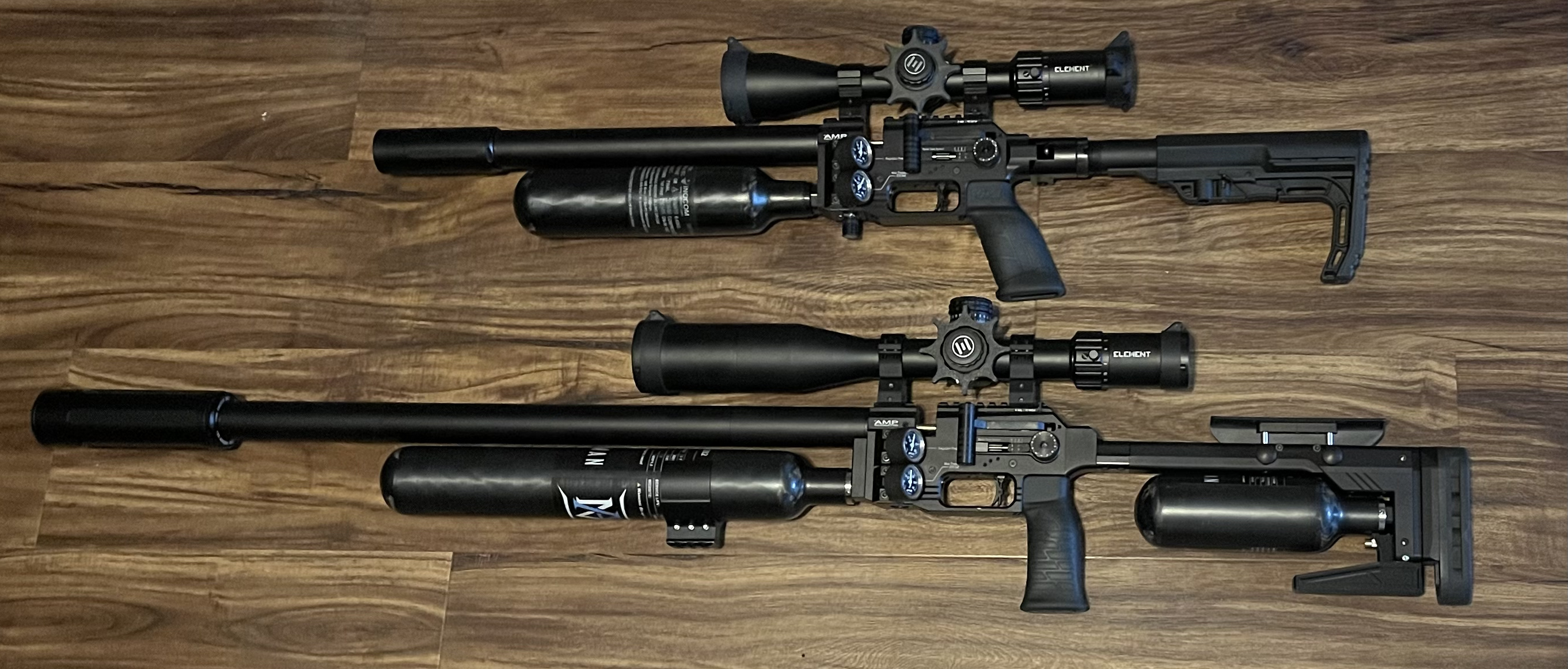

Here is a photo of my .22 compact (with folding stock, no rear bottle) vs. my 500mm .30 cal Panthera with dual bottles. Notice the difference in the grips.
What'd the OAL of the 2?
@GA_LeadHead, those two Pantheras, particularly compact? Super sweet.
.22 is shorter than .25
