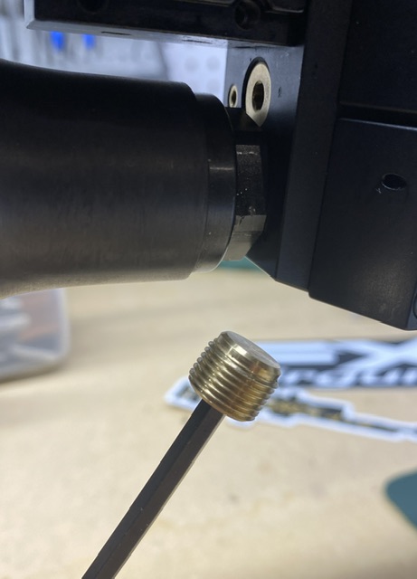

In this video there is some explanation on internals of FX Panthera.1) remove rail
2) remove brass plug
2) install bottle adapter and bottle
3) fill with air
4) shoot gun
FX USA told me that FX Sweden has not yet provided a schematic so I ordered the Crown/M3 bottle adapter and washers.
I believe the upper brass plug in pic is the valve location.

Hate to say it, but at this point, I would not buy the 19659 adapter. I found it is not sealing on the face of the block, so I need to get some answers. So if you were thinking about the front bottle system, I’d hold off for a while or research on your own.are the same parts as the impact mk2
