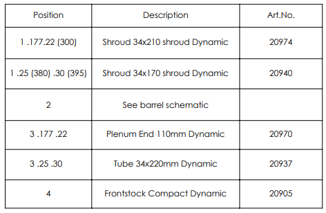

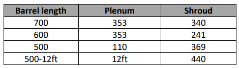

From the FX drawings and parts list PDFs. Hopefully this helps.
I've been thinking about mixing and matching some different sizes plenums and shrounds. For example I'm thinking about using the 220mm .30 hunter compact plenum with the .22 210mm shround so I can use a 700cc bottle in front with the heavy duty huma-air bottle conversion but still have the the barrell long enough to fit a moderator and not hit the bottle.
