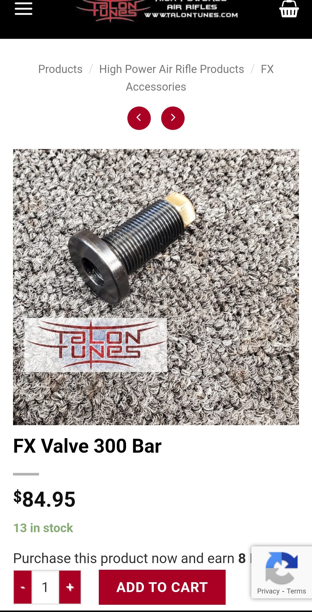

With an alsafe .7l tank and an m3 valve. Is it safe to fill my panthera to 300bar? Thanks
My M3 did not come with a 300bar valve on the bottle.With an alsafe .7l tank and an m3 valve. Is it safe to fill my panthera to 300bar? Thanks
When you fill that high the front regulator has to fail before anything to worry about on a m3 panthera I'd stick to 3600 psi as well as most impacts even though I've seen a few fill higher really its not neededOk, was just curious. I don't plan on filling that thing ever that high. My king came with a 310b 480cc.
