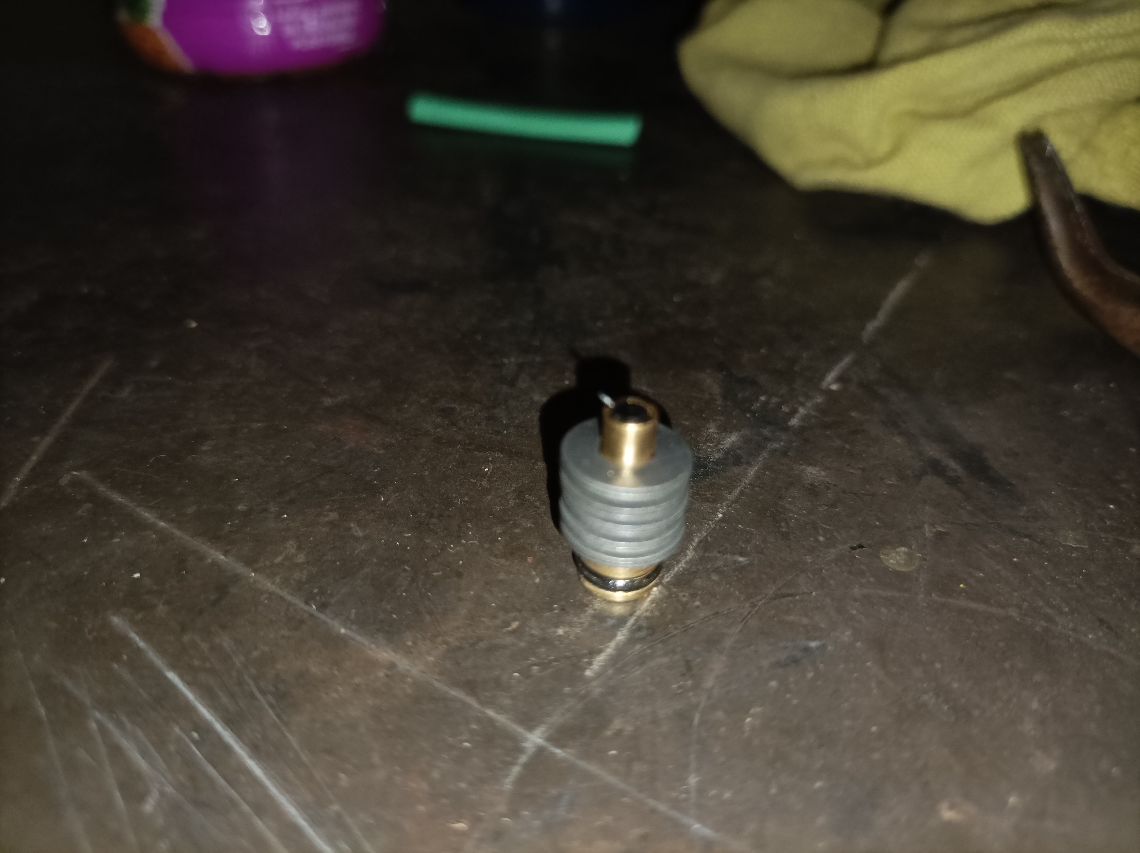

most problems are in the regulator. check it if the landing surface on the bottom is well polished as are the springs. it also depends on which version of the regulator you have, if it is still made of plastic or brass, or the latest version is brass with a piece of plastic in it, see photo.
I had a piece of that plastic just like a hair and it was causing me problems.
and as another thing in low pressure setting it does it more often than at higher pressure it stops doing it for me when I set 150 bar at 145 bar it rises only slightly.
