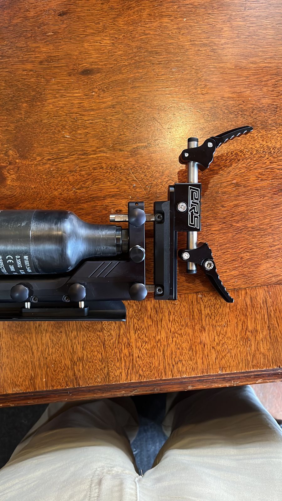

After making a recrown and making wider exit hole of the shroud now my Panthera Compact Hunter is super accurate with H&N Baracudas 30.8 grain.
Mine has a slow leak. I do not know from where it is leaking.
Configuration of mine with a big bottle in the front and a 300 cc in the rear makes it a super configuration for hunting purposes.
I was really angry with accuracy and invested A LOT of pellets before the recrown and the bigger hole on the shroud.
By first time in my life I had to change the Butt Pad, the original one is too cheap and affects accuracy because it is very easy to slightly change the place where you hold the rifle in your arm.
At this very point I already have a table of how to compensate at every distance up to 190 yards. This rifle in this moment just changed from being a rifle in process to a rifle in full functionality (but I do know not for how long time I will need to accept that slow leak - that do not affect my huntings).
Have you sprayed all leak points? If so stick the end of the barrel in some water, if you get bubbles now you know where to start
Confirmed, no bubbles by the barrel.
After that test I was able to tighten a little bit the front bottle.
I may not know if that was the problem. But after tighten front bottle, there are not bubbles on any of the bottles.
I just refilled the rifle.
Tomorrow morning will check if after tighten more the front bottle the leak stops.
I suppose that if there are not bubbles in the barrel then the valve is not leaking.
