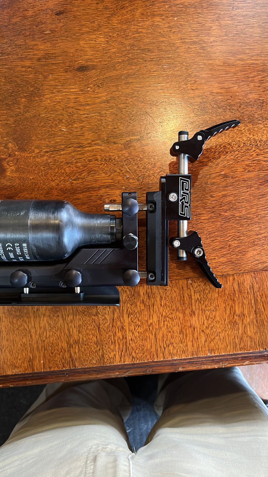

If not fixed, squirt a drop of shaving foam around the gauge connectors and the reg. Those are the other common spots and easy to fix with an oring.Confirmed, no bubbles by the barrel.
After that test I was able to tighten a little bit the front bottle.
I may not know if that was the problem. But after tighten front bottle, there are not bubbles on any of the bottles.
I just refilled the rifle.
Tomorrow morning will check if after tighten more the front bottle the leak stops.
I suppose that if there are not bubbles in the barrel then the valve is not leaking.
