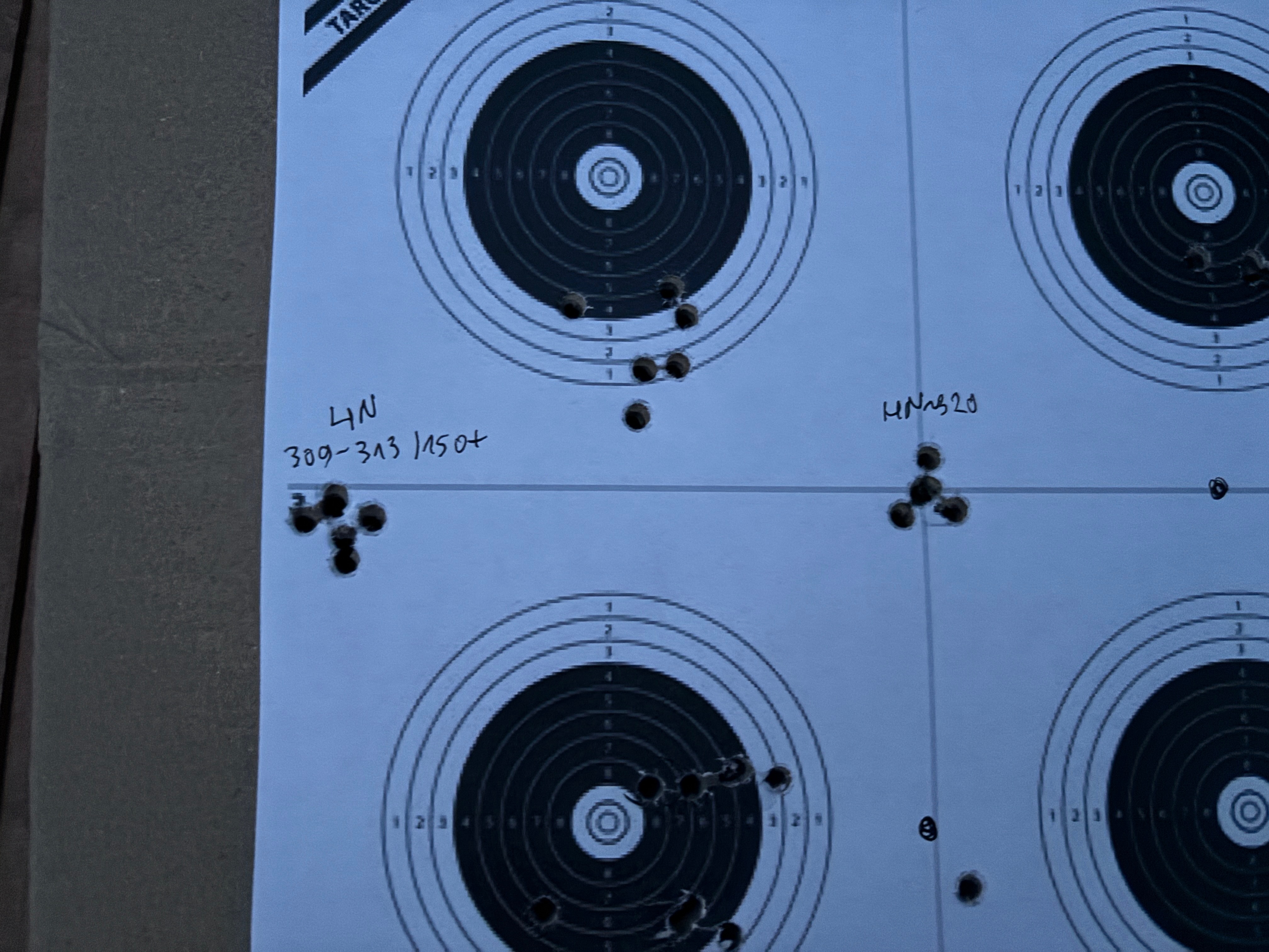

30m, 5 shot groups from sub 12fpe 300mm .177 Panthera all can be covered with D15mm coin
