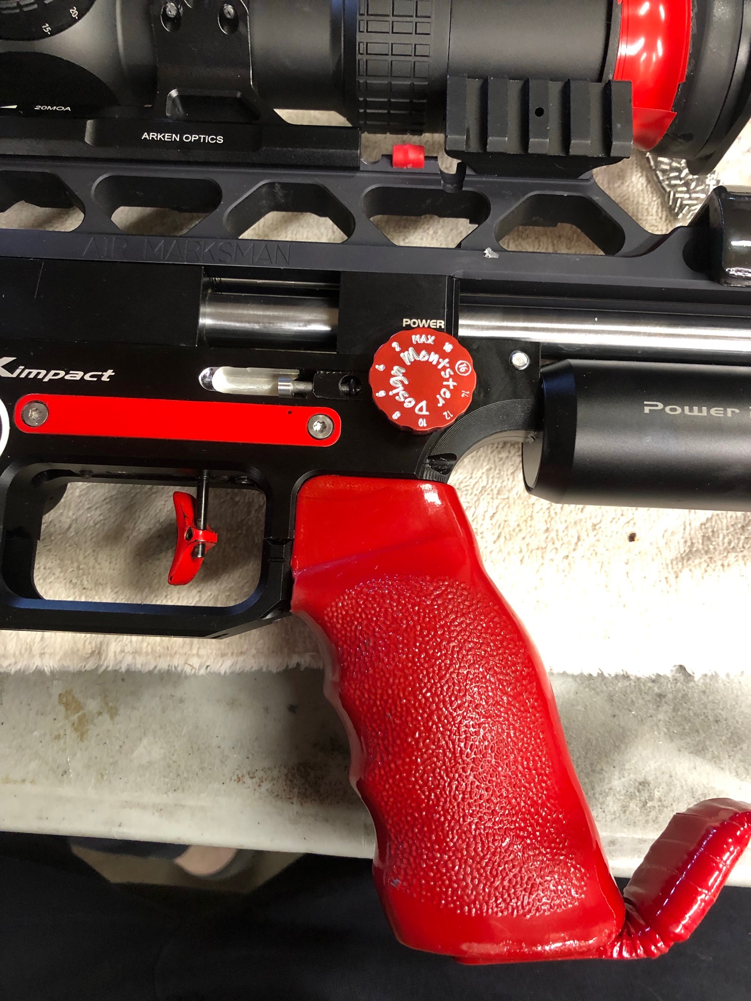

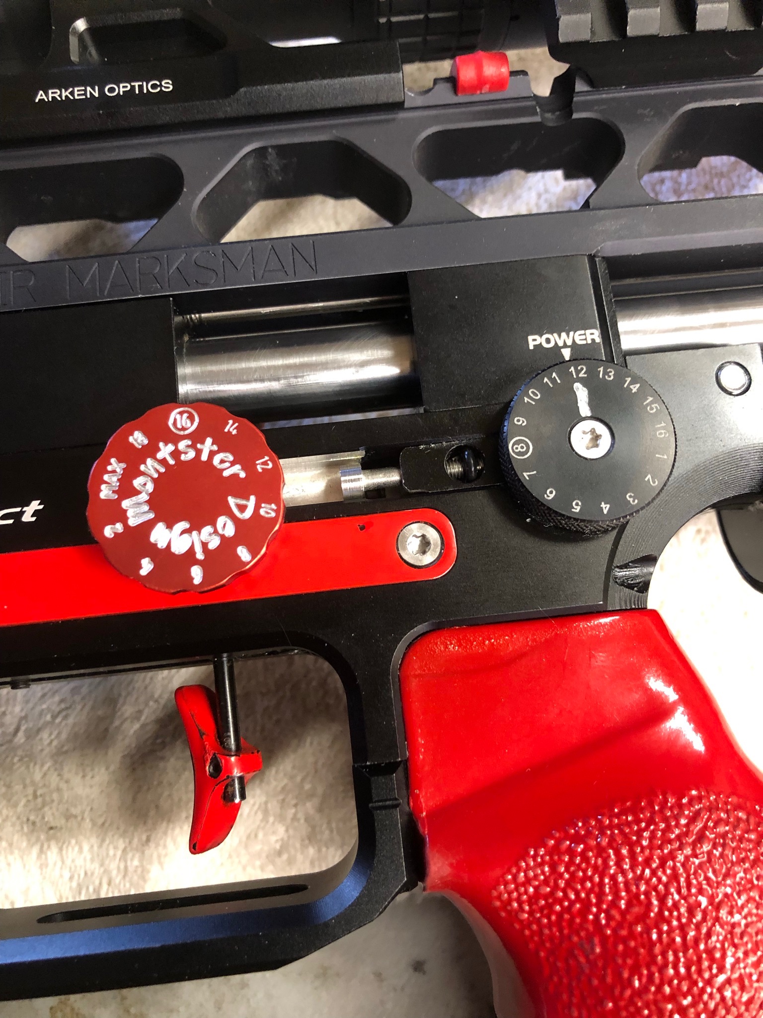

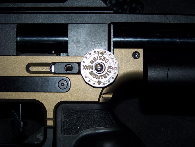

I have MRHOSTED’s power wheel on both my MK2’s, and not only does he offer more settings, it’s design will never loosen the center screw, it is “knobby”, meaning a pleasure to grip, it looks great, and best of all, no track marks from the hammer tension screw gouging into the side of the cam. So glad I listened to QBALL as he highly recommended that upgrade to me
Looking at the Panthera Schematic you will find the Power Adjuster wheel is "Part#19908 Power Adjuster Crown". Yep, same part as on the newer Crown MkII. That is with the 23 click stops and the continuous curve stop (about 0.2mm of spring compression per stop by the way). The Impact M3 schematic shows "part # 10310 Power Adjuster Impact M3". In the schematic the Impact part seems not as thick, though it uses the same screw to attach it as the Crown and Panthera "part # 2508 M3x10 screw". It appears that the M# only has one spring and ball bearing to act on the detents where the Crown and Panthera have two.
