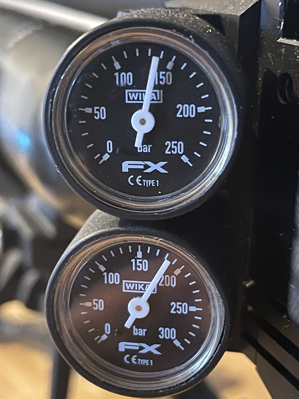

500mm .30 Panthera "Magic Tune" as I refer to it. But open to suggestions if anyone has any.
This same tune shoots 44.8 Atomics at 915fps and Hybrids at 910fps. Same Zero on the scope.
Plenty of power and extremely accurate and consistent.
Reg at 135
Hammer at ~3.75
Using stock hammer weight.

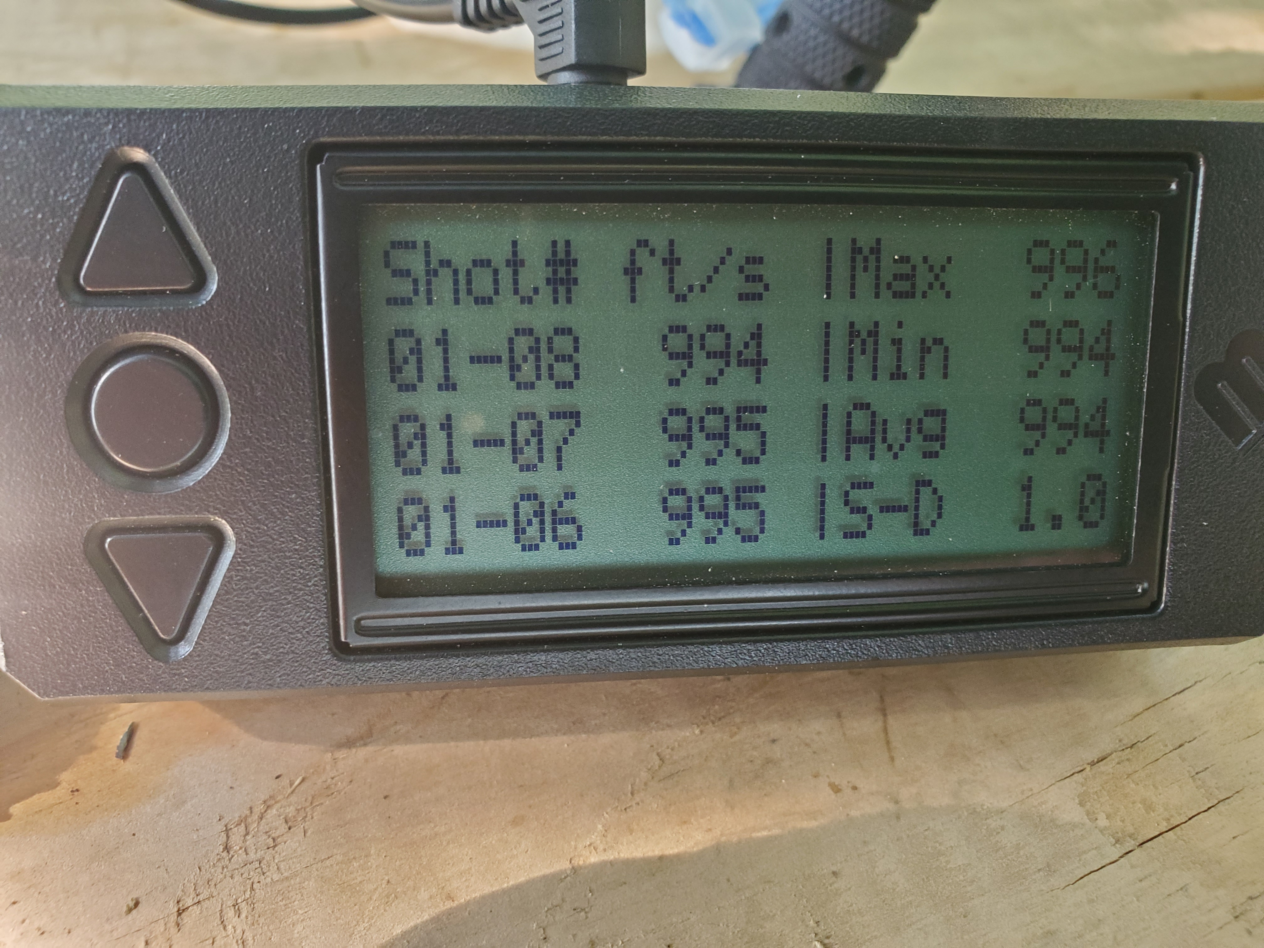

Is there a big panthera tune thread?
Just got my panthera 700
34gr javelin gen 2
From factory:
145bar, 2.5 micro, 23 macro.
Shot 900fps, 10 shots es around 50, sd 15. Was disappointed, i understand it wasnt broke in.
I made a single adjustment as a guess and left reg alone, 3.0 micro, 13 macro.
Shooting 996fps with es 4 and sd under 1. Very awesome.
Not Shooting groups as tight as my rimfire but not bad. will do more tuning.
