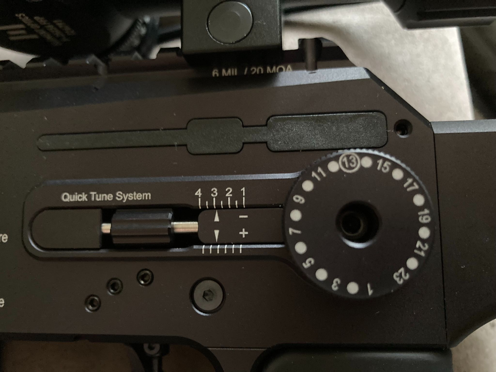

Seems a lot of hammer spring tension. My Panthera 500 is also set at 115 bar for 34gr FX pellets but the macro wheel is set at 13 and micro just under 3.

I will first add a remark with no offense : we don't care about the position of the Macro Wheel :) only the position of the micro wheel is useful.
So you can have you macro at 23 or 1 ... if your micro is still on the "3" then you have the same setting.

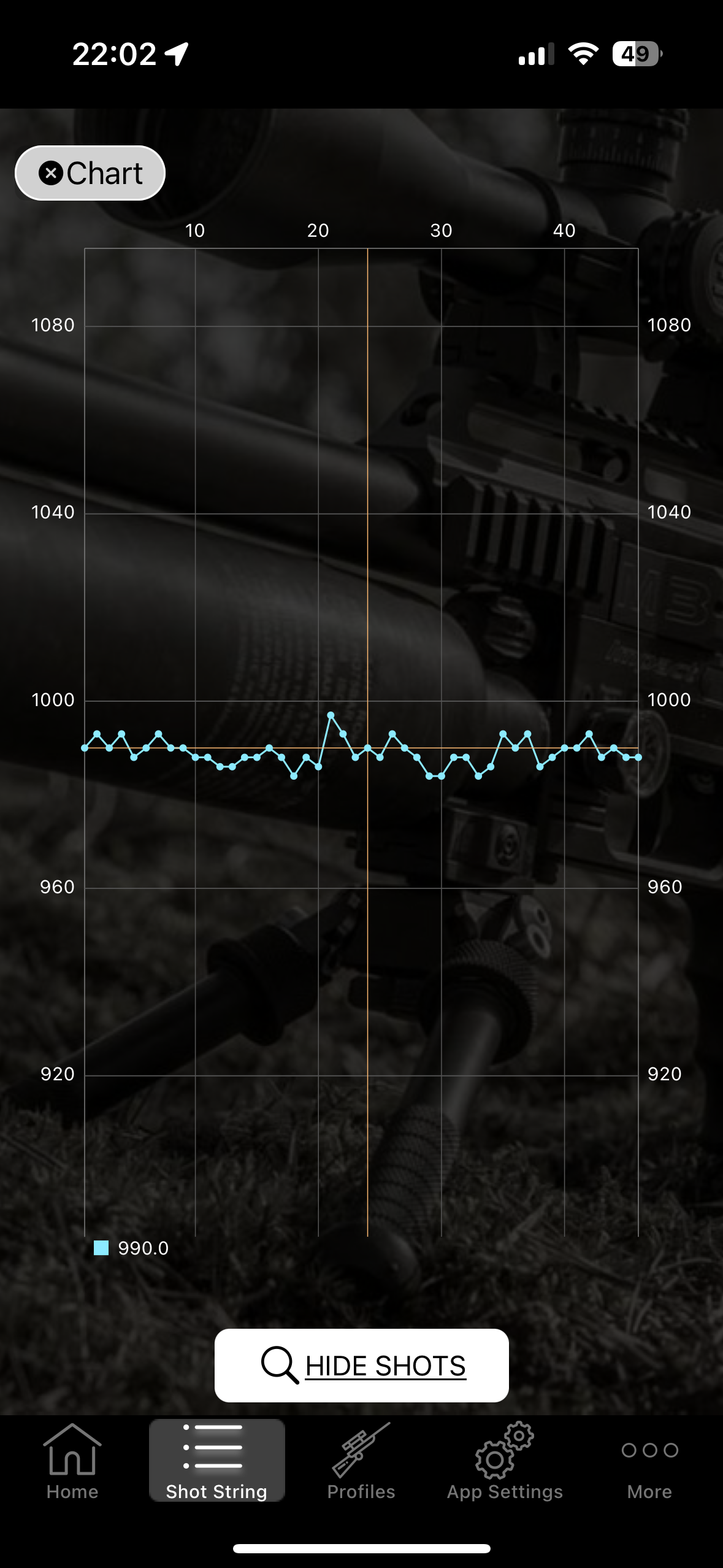

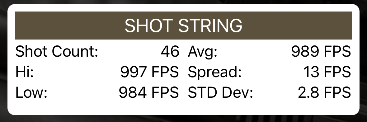

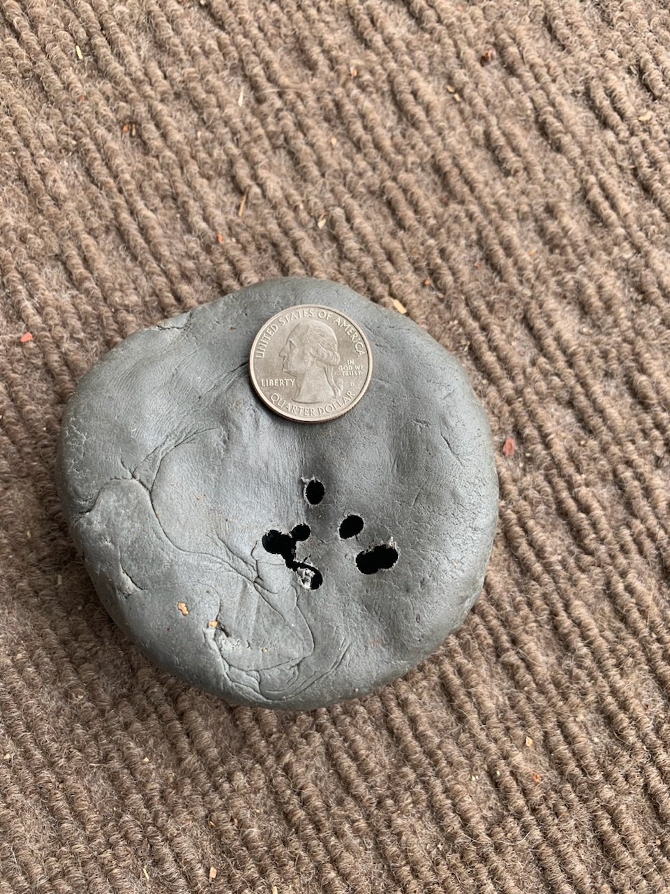

Panthera 600 22 shooting Altaros 32.3grain (0.18 BC!) slugs at 895fps with blow-my-mind accuracy:
140bar reg, 3.2 micro.
They’re collecting dust now, but this tune also worked well for Javelin 26g 218s at 1000fps.
Gun is a pussy cat at this relatively low power level.
110y with Altaros slugs:

Just got my brand new .22 Panthera 700, set the reg at 150 bar wheel at 19 and micro at 3.9 same setting as tedholdover when he was shooting cans with 34gr at 1000 fps, but I’m getting only 630 fps what’s wrong ??
is the transport screw on the right beneath the magazin entry removed? There should be a hole visible to the other side? Where did u buy it?
Little Update: I ended up achieving 1000 fps with the PW at 23 macro at 4 reg 150 bars using 34gr javelins. I removed the screw when I first got it. Just realized each one of us achieve that 1000 fps (34gr slugs) with different settings, thought I would copy and get the same results but it looks like each gun is different from the other.
