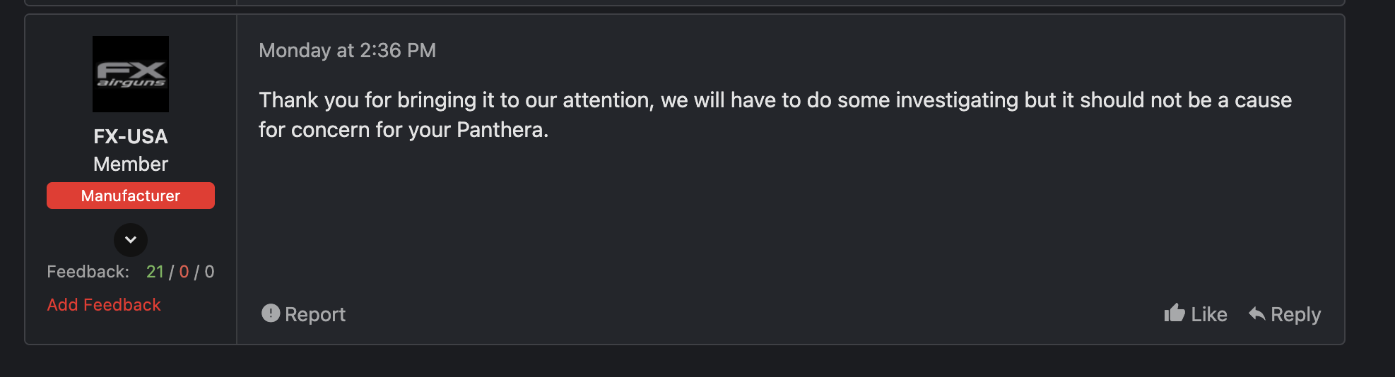

I messaged FX on this forum with a link to a thread about the valve pin issue and I'll attach their response below.

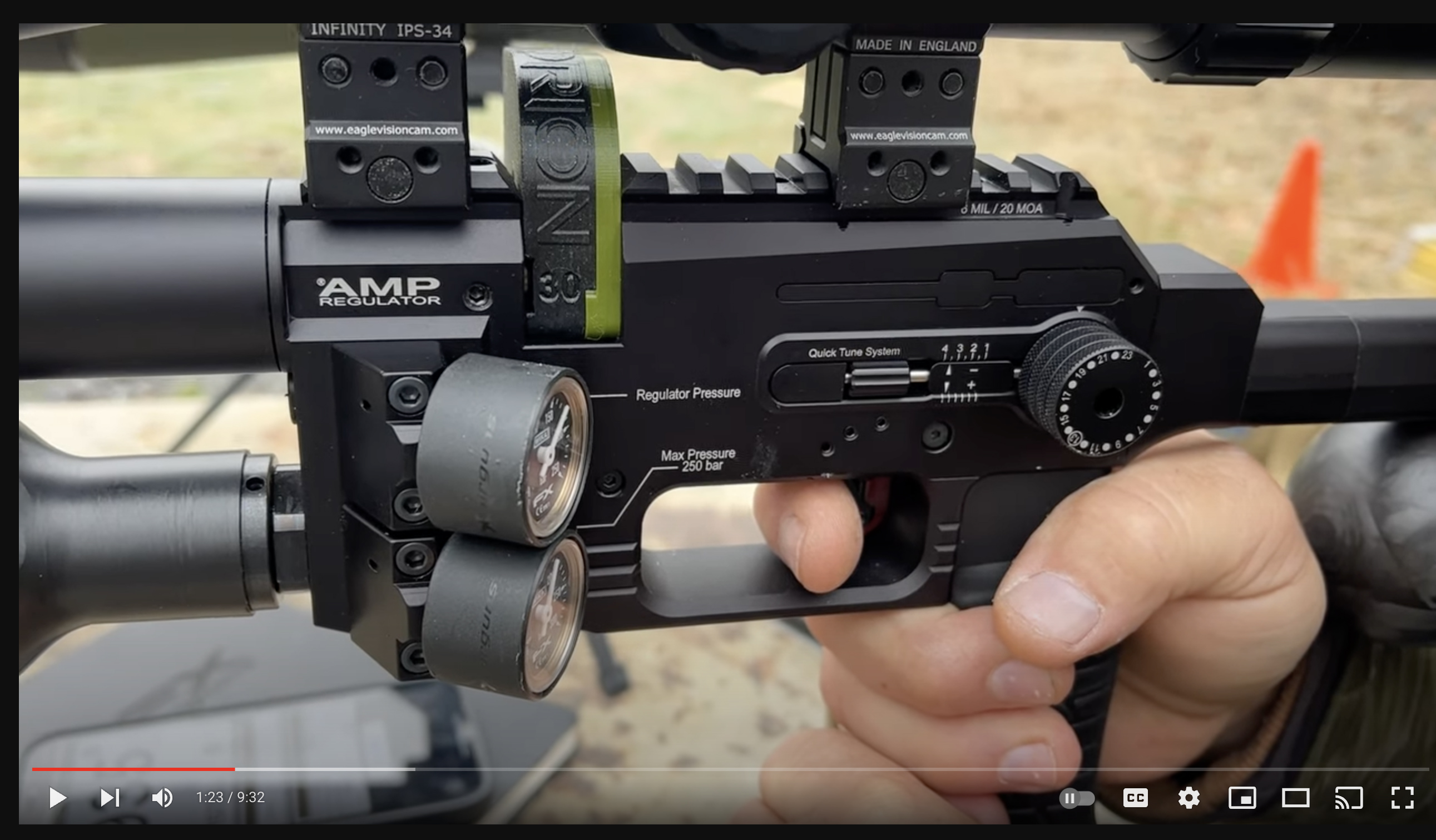

Shooter 1721 has a recent video shooting “his” .30 Panther 500mm “maxed out” with very high reg pressure and nothing negative was said…
FX, despite the post above, of course knows about the bent valve stem issue. Perhaps they’ve even taken care of if for recent guns from the assembly line….
Saw that. He replied to a comment that his reg was set at 168, but if you look at this screenshot I grabbed, the reg is set much higher. Looks like it closer to 180? At that pressure he would surely have to be using the 8mm hammer weight and not the stock 4mm?
Major error of parallax there...
You can't tell anything from that sideways pic! Have see the gauge from straight on.
Rick wouldn't say it was set at 168 if it wasn't!
And that gun was set up by Ernest so I'm sure it is up to snuff in every way!
I'm sitting here looking at the gauge on my panthera and at that angle I can tell he's DEFINITELY not at 168 and much higher.

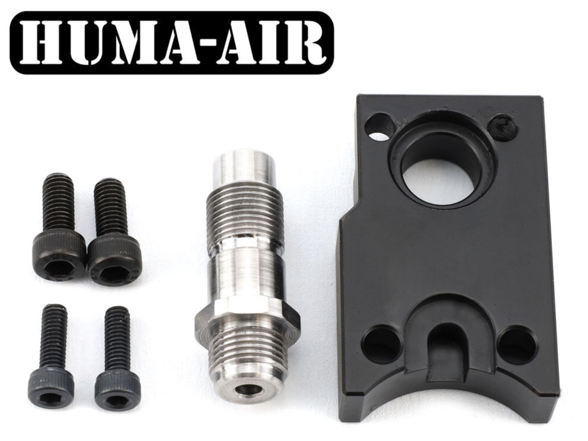

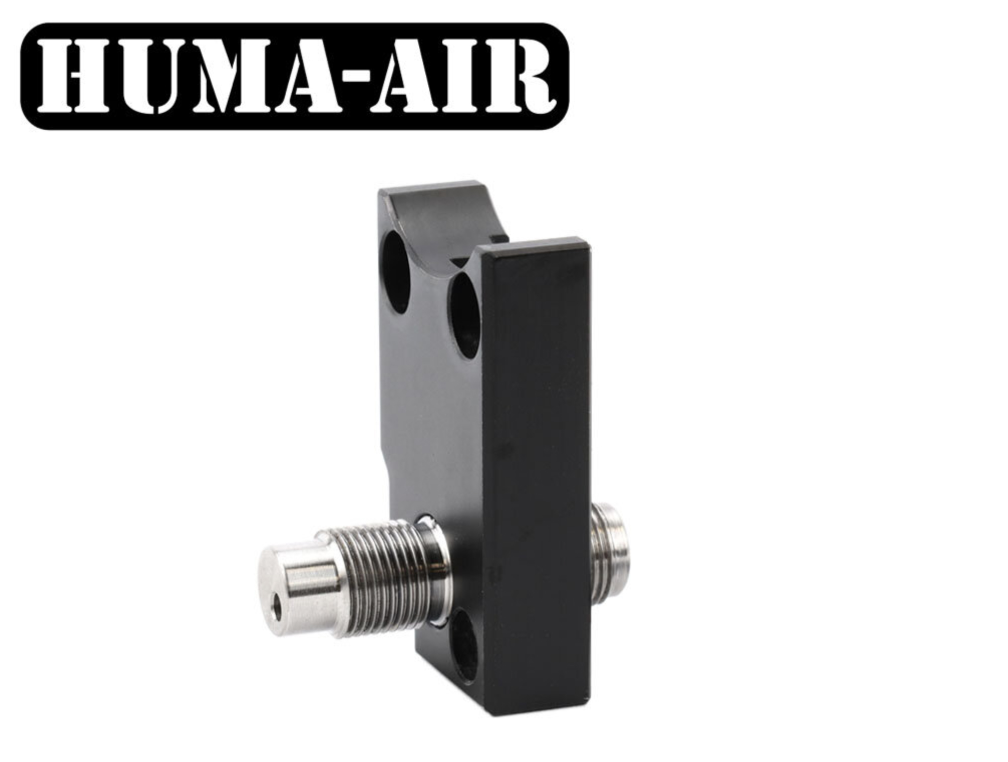

I ordered from Huma today their "heavy duty" reinforced double bottle adapter. Pricy, but I think I would feel much more confident in this design. It looks as though it will offer protection to the valve pin.

Reactions: Nords
