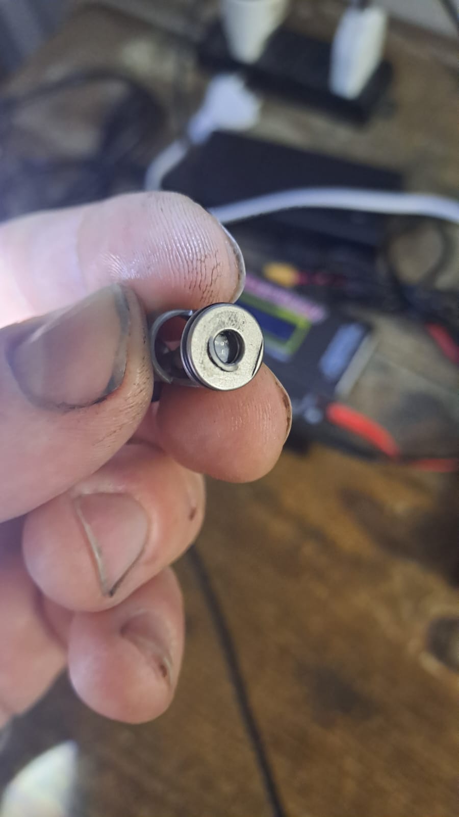

it is the third time this problem has happened to me, the first time due to a shot with the rifle without pressure and the O-ring x1-2 broke, old version of the valve, the second time the same or O-ring broke without particular causes, and the third time I attach the photo, the valve is destroyed
the rifle is one year old, now I'm waiting for the cap, valve stem and seat

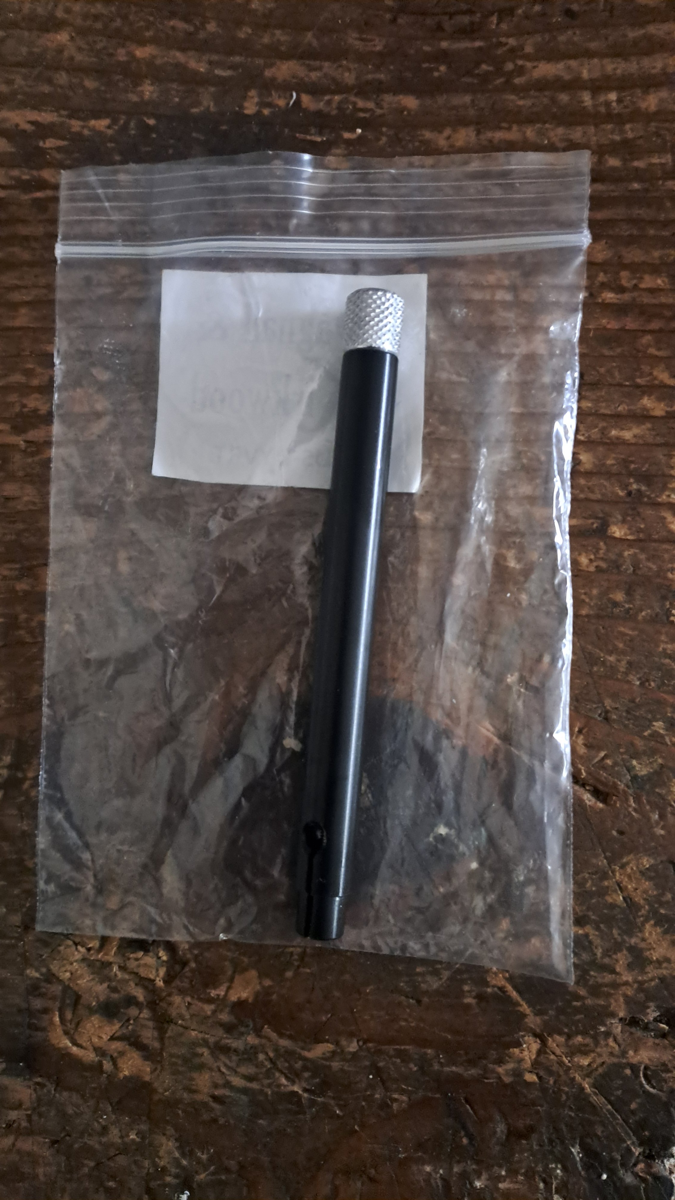

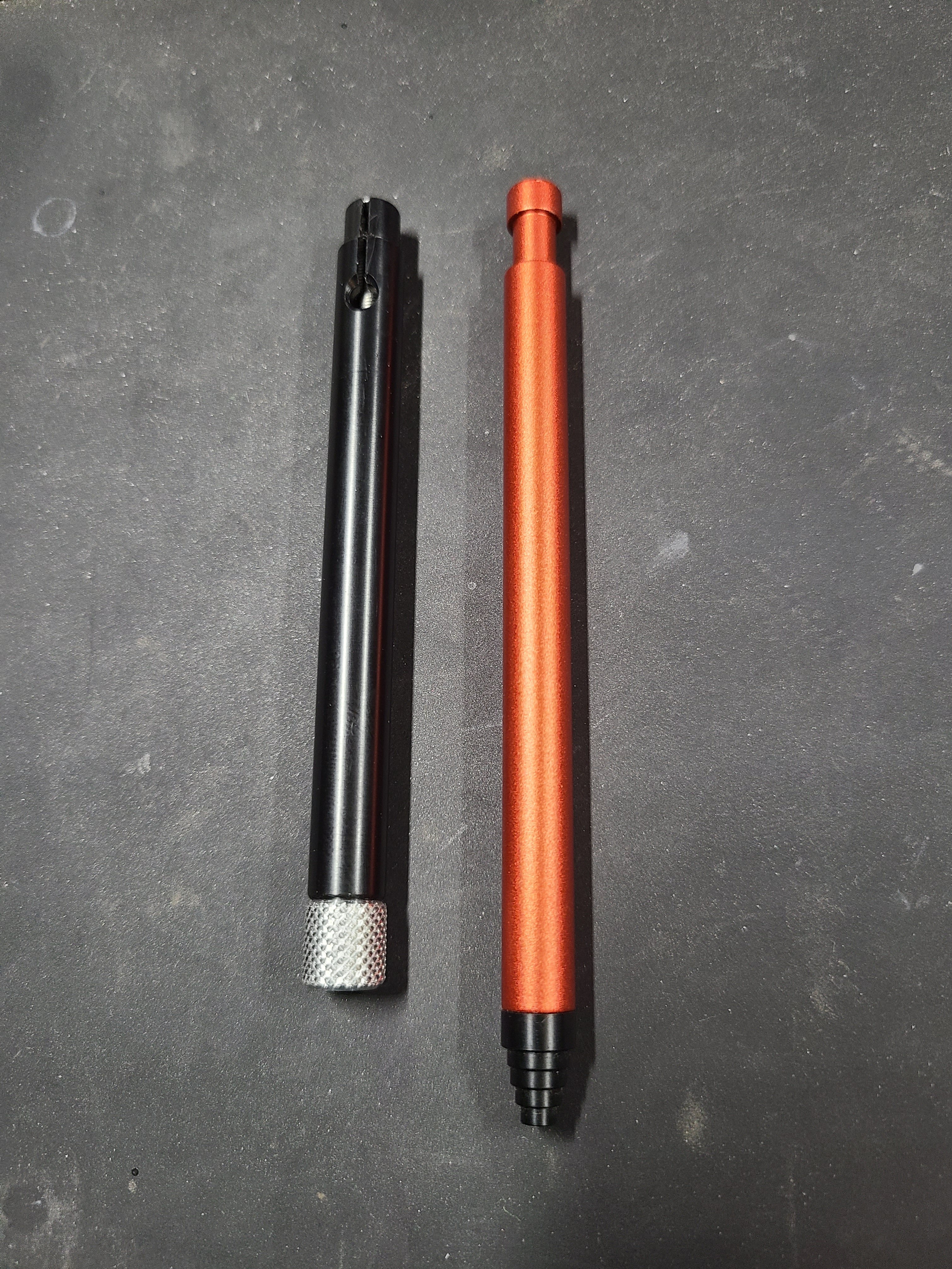

I had to buy the specific tool to remove the valve, I'll put it in the photo, you could try using a wall plug of the correct size
