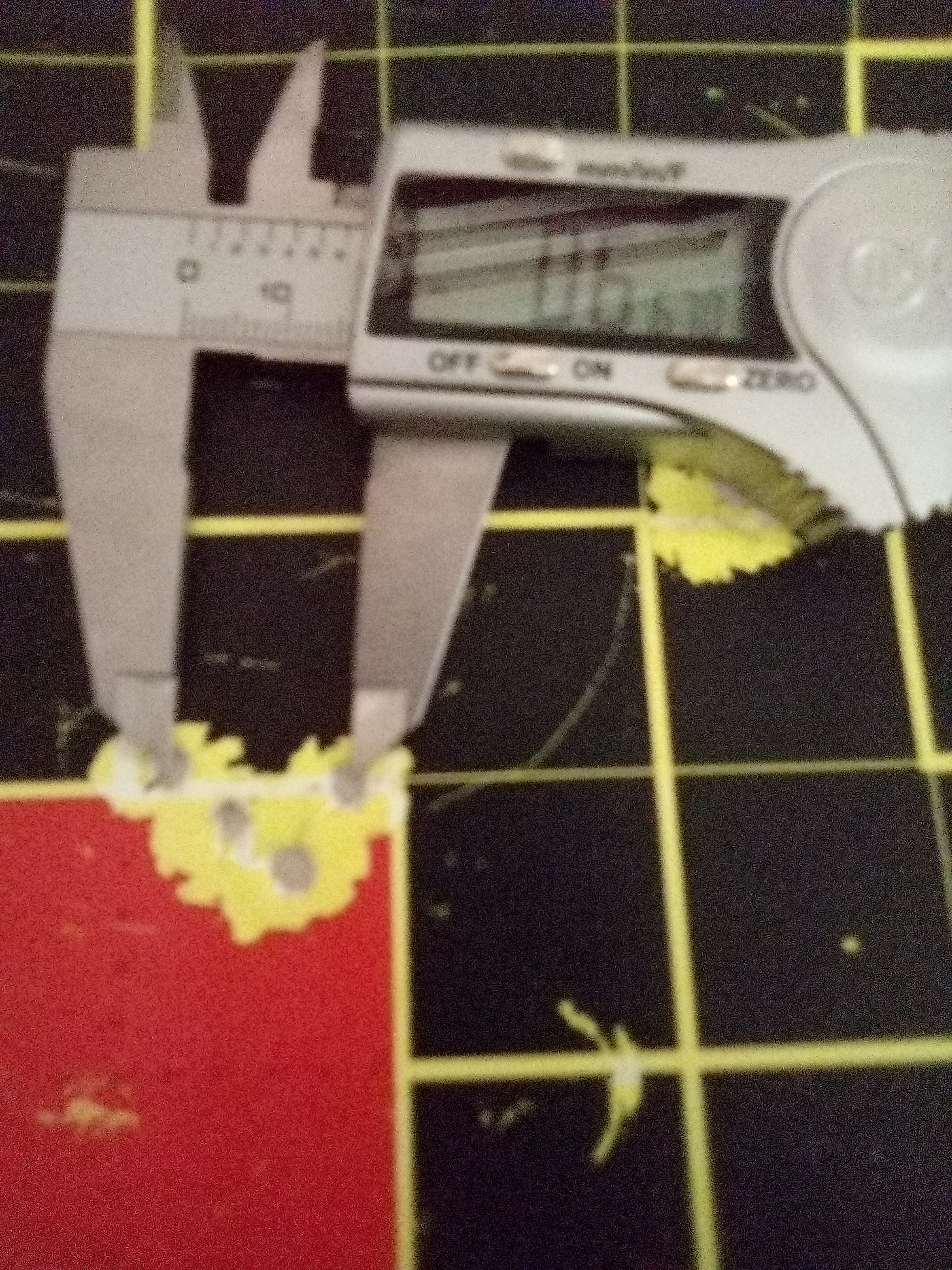

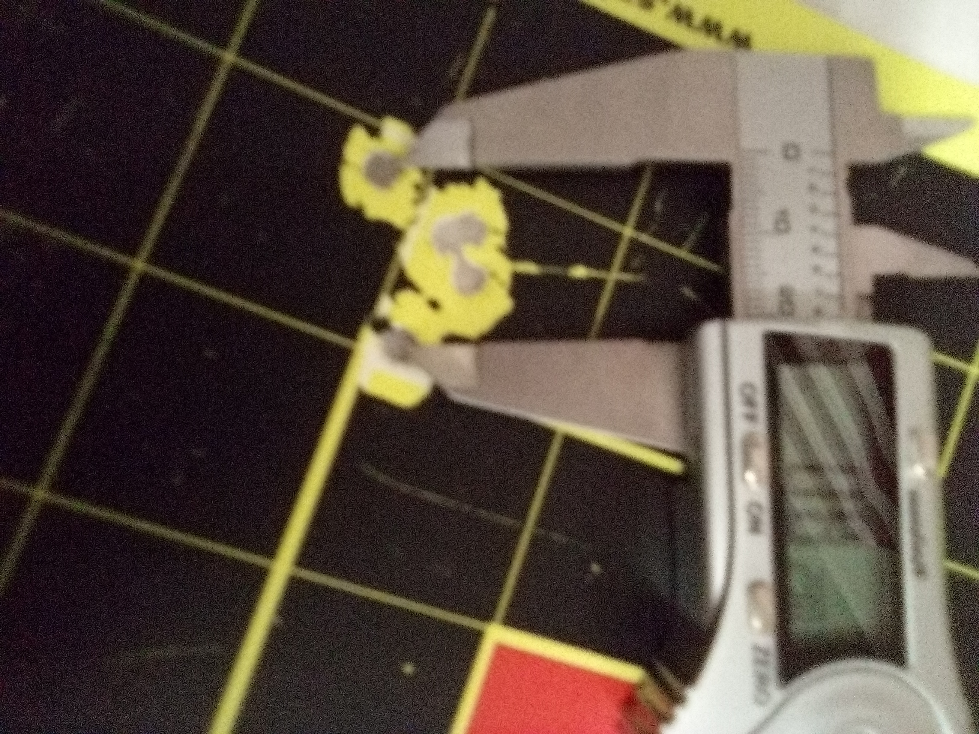

I don't know a ton about the subject all I know is that it made my shooting much more consistent and my groups half the size but mark and sam after work is where I found the video titled parallax (for a better group) and what I learned is amazing maybe I sound stupid because this is shooting 101 but I've never heard of parallax error until now and I'm blown away by how much of a difference it makes these are 2 of my 5 shot groups from earlier today at 100 yds
