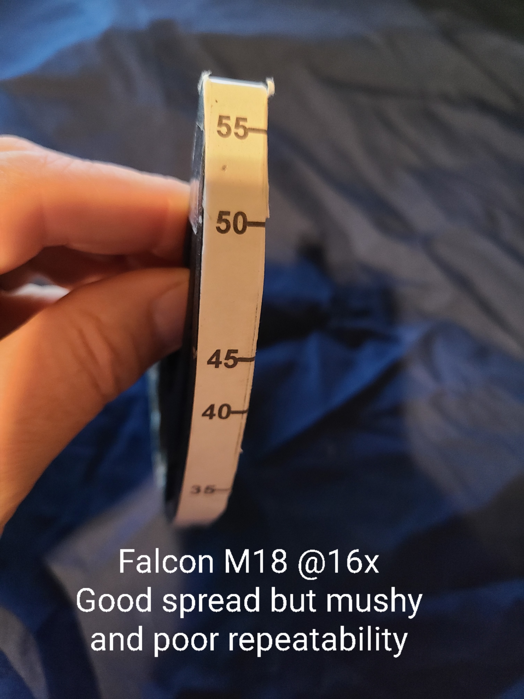

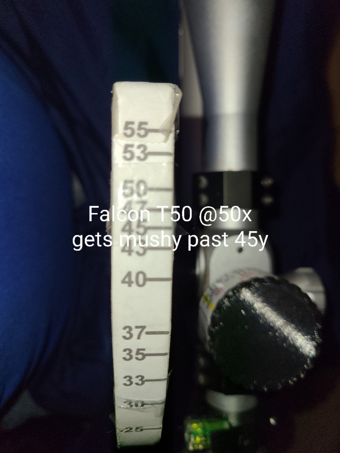

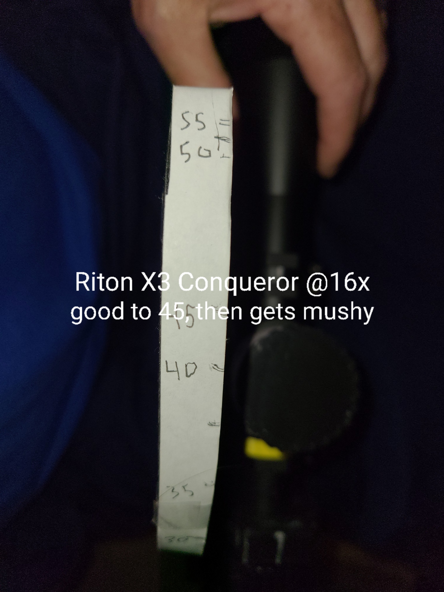

A bigger diameter helps, but each scope is different. I print my own wheels and they are all the same shape, but the distance marks are different, even on the same model of scopes, or even changing the magnification on a scope. I guess it's time to stop being lazy and post some pictures of my wheels. In the photos, I say that some of the scopes are "mushy". What I mean by that is that you might have an object at 52 yards. It will come into focus on the scope at the 45 yard setting and go out of focus past the 55 yard setting. So the focus area on the scope wheel is large, which makes it hard to range find accurately. If I recall correctly, this is called having to much depth of field. "Snappy" scopes that have a narrow focus range have a shallow depth of field and are better for rangefinding. So the scopes pictured below that are setup for 16x have nice big spreads, but they don't actually range find very well at longer distances because of the large depth of field. They would be great for hunting, assuming you have a range finder. And the Riton scope below is the Conquer, not Conqueror.

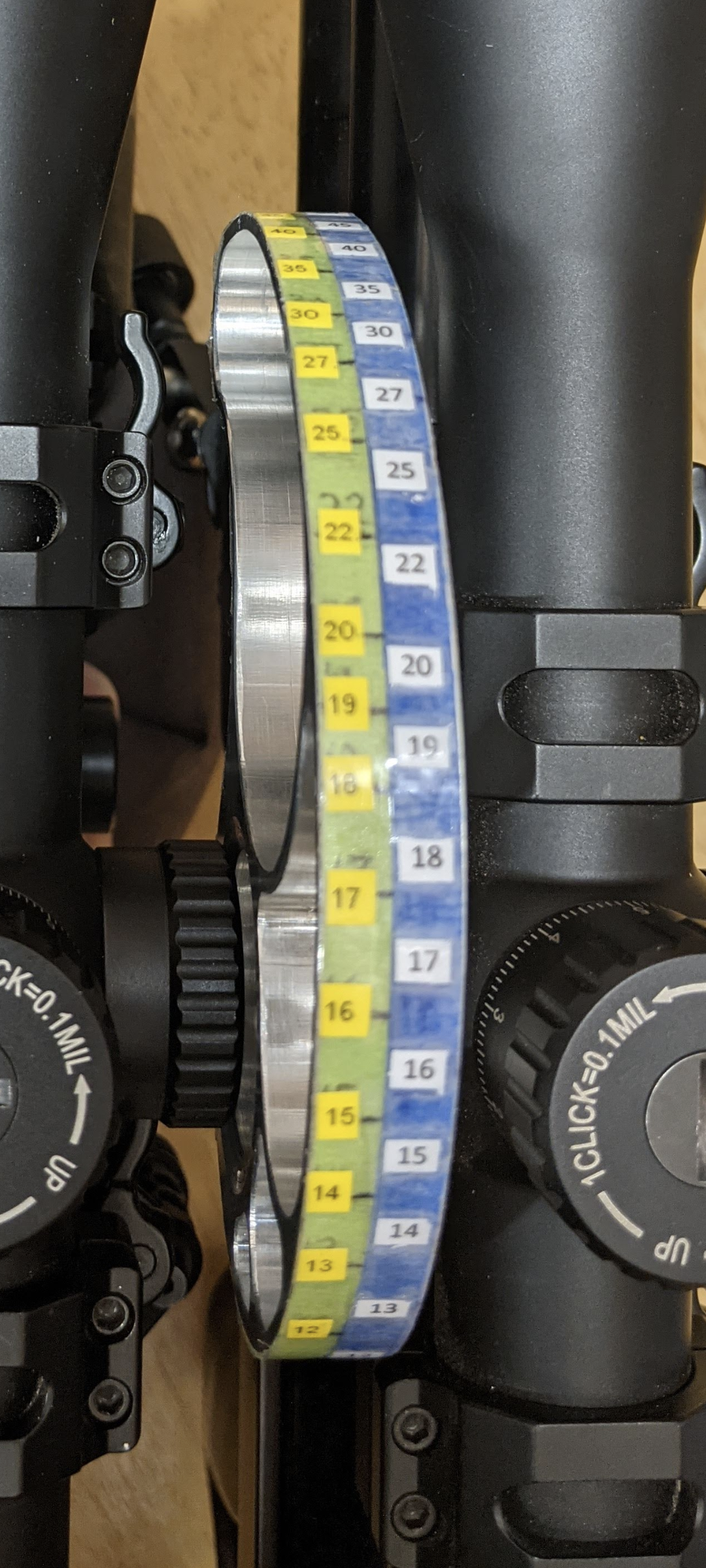

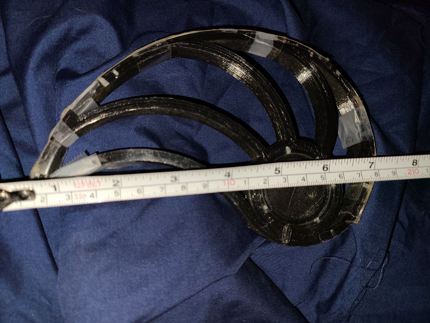

I guess I‘m a little annual and some of my tape colors have to match my gun 🙂 these 3 wheels are all from JD and they are nautilus wheels and all on Athlon scopes. The silver wheel is from scope-werks and is a nautilus, the pistol wheel I printed myself on a Sightron . I hand do my tapes then transfer the dimensions on a program for scope-werks and it prints out real nice. The cool thing about the program, you can save all the tape dimensions and alter them when things change.

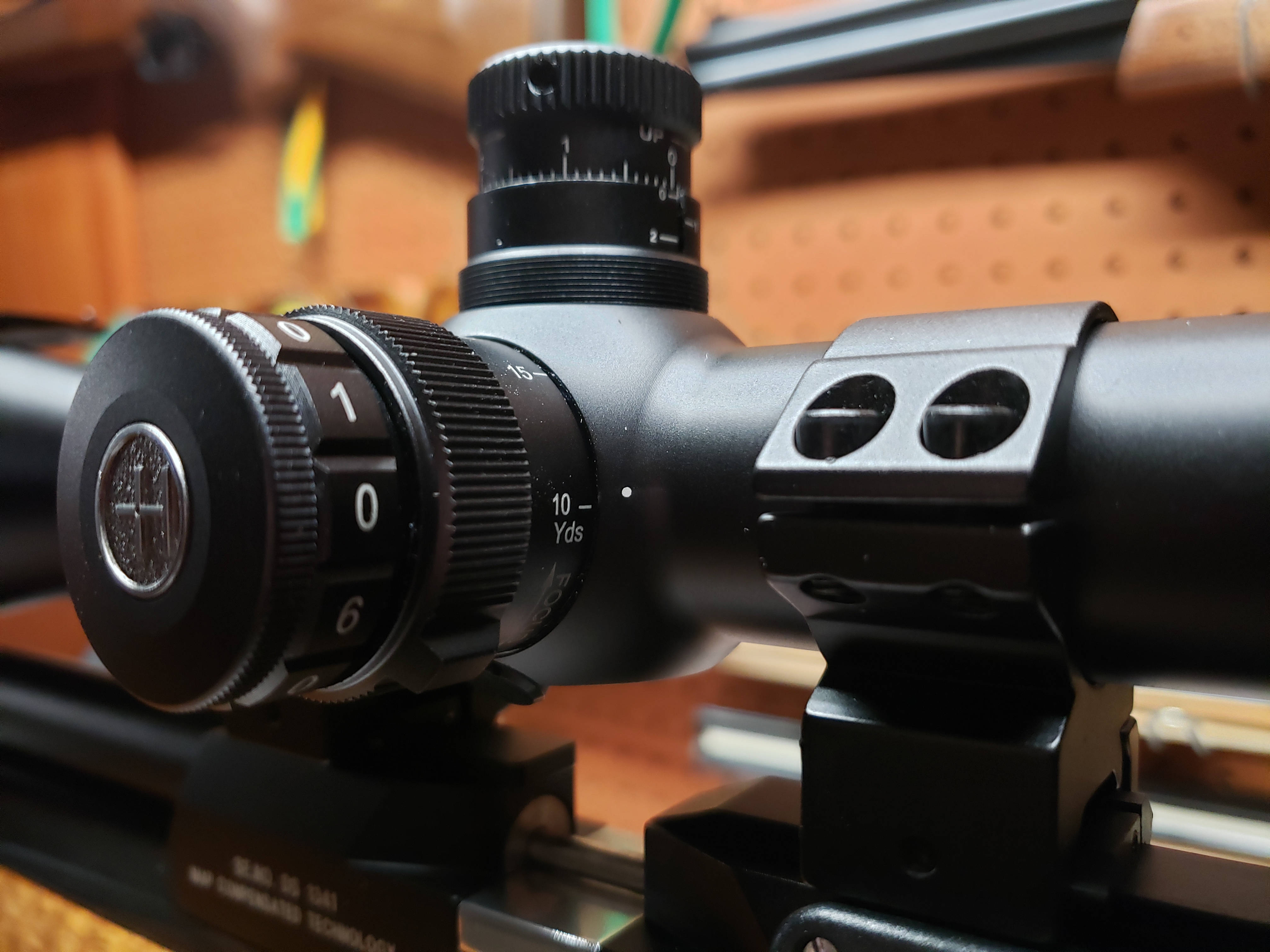

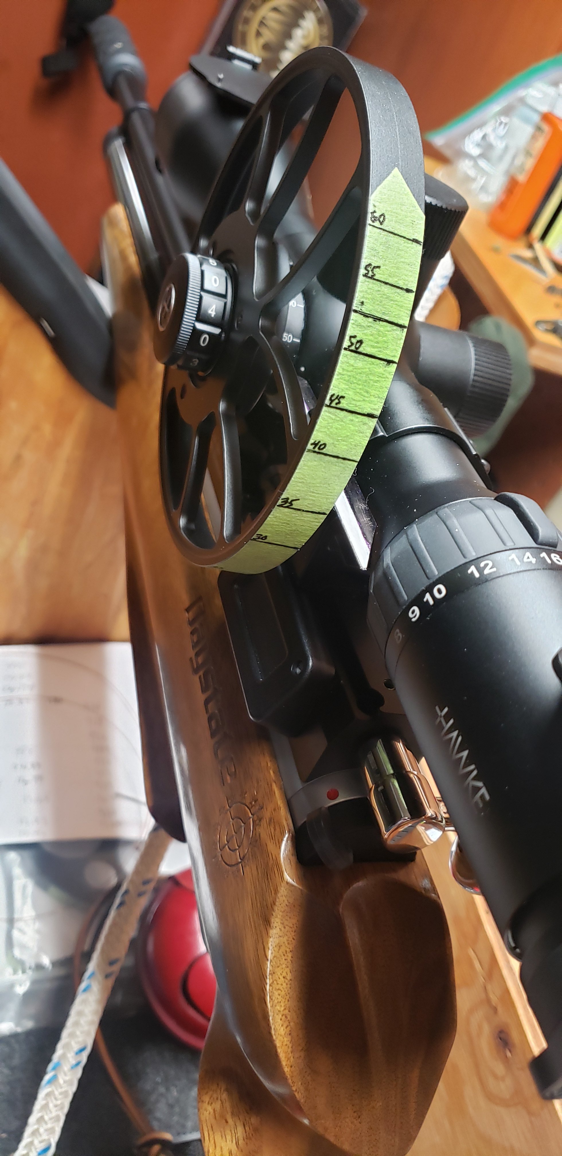

This is my new Hawke Airmax 8-32x50 with a Scopewerks sidewheel. I did the ranging in our shop at work so I still have yet to really test it out. Preliminary sighting seems promising. It has about 170 degrees of rotation from 11 yards to 55 yards. The bummer is that it only focuses clearly to 11 yards at 16x with my ocular setting. 10 is blurry. I asked Hawke about this and they were kinda wishy washy with a reply as to whether there was an issue with the scope. Plus the parallax knob marks don't quite line up for 10 yards. I'm going to try it out first before discussing it further with Hawke Optics.
