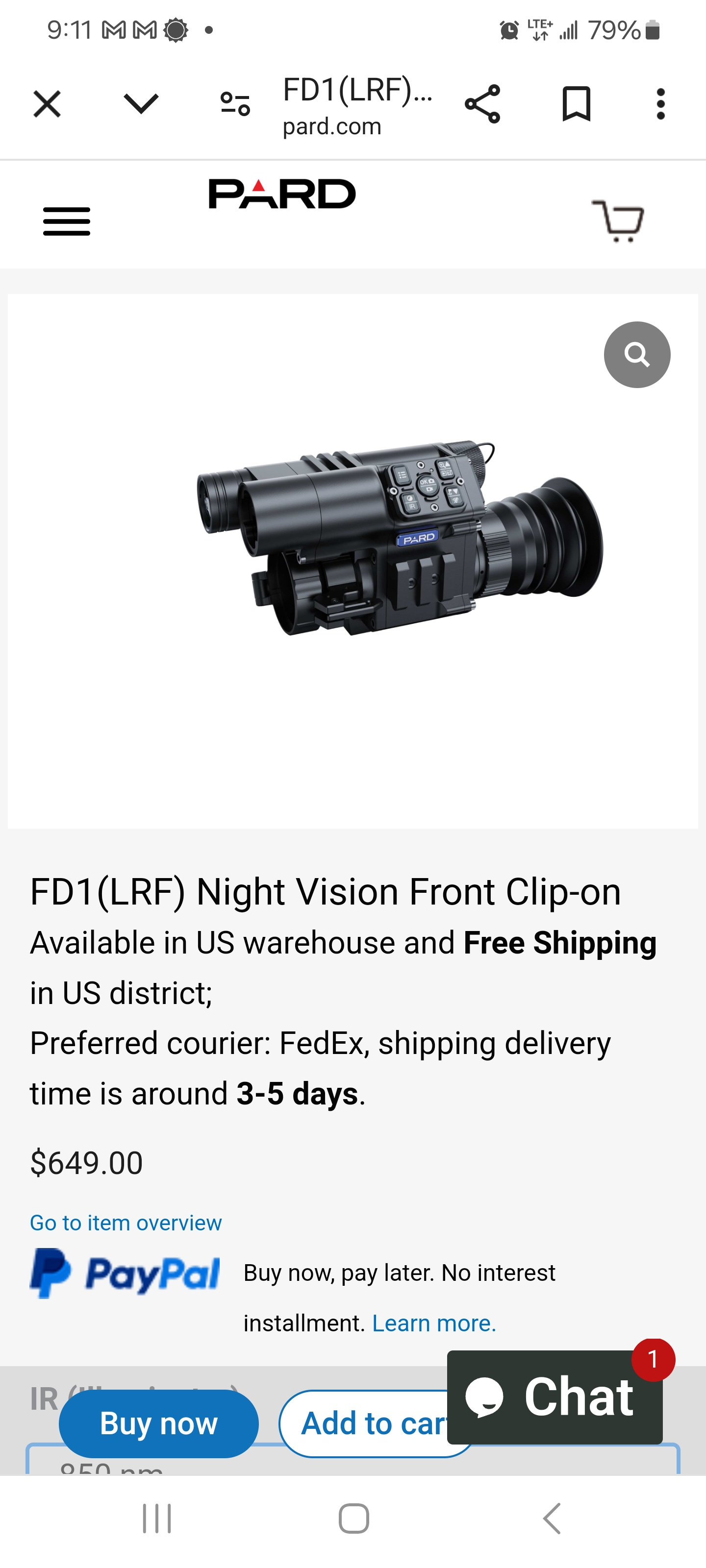

so i was just looking into night vision and u was looking to pull the trigger on nv008sp2 but how does one go about shimmiming rhe scope?they also have this clip on with the lrf. any input on this one?? see included screen shot
@TonyP Two shims came with my NV008s. I made more. There are links to a thread and a video discussing this very topic within the “All Things Pard Master Thread.” https://www.airgunnation.com/thread...-vision-thermal-optics-master-thread.1290790/
