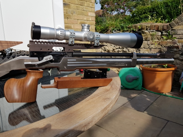

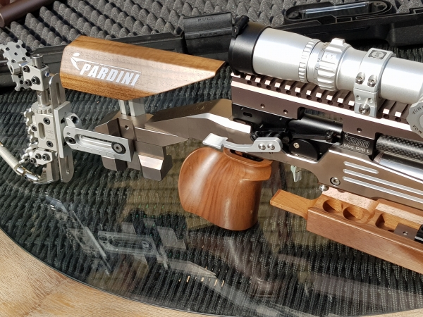

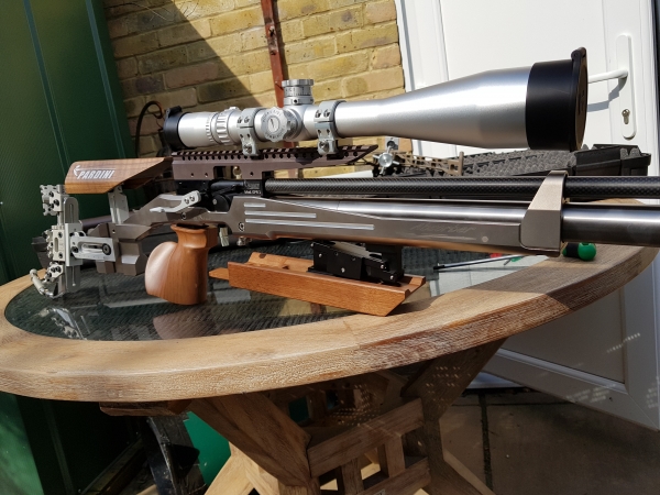

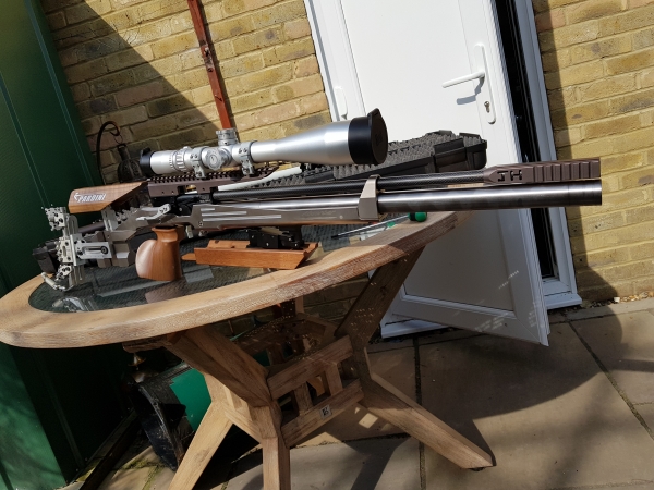

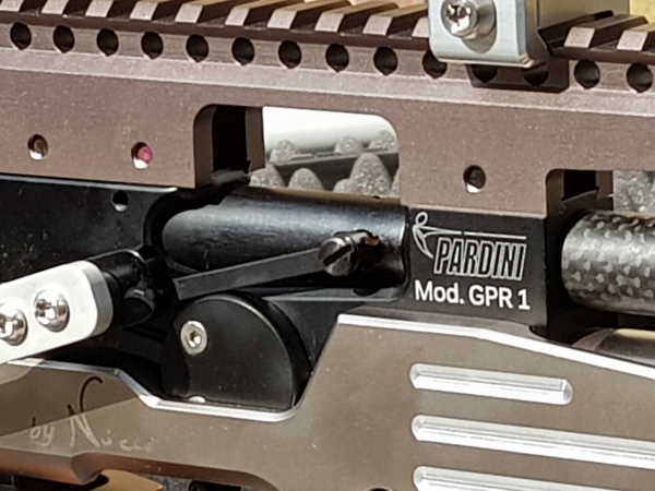

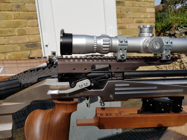

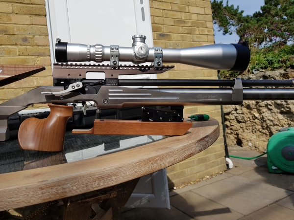

Only 1 person on the planet - is able to pull off something like this...The UK's Premier Guru & Living Legend - who has the skills , engineering know how, talent and experience - to make the 2nd conversion even better than the first.. Jon Harris. Congrats to the new owner who was really, really, quite patient... but well worth the wait
Some words from the owner: "Air rifles don't come much better than this. Much lighter than No1 for a number of reasons - titanium air cylinder,carbon barrel shroud, not least that amazing scope. The work Jon has varied out is absolutely stunning right down to the colour I wanted. The list of what he's done is endless, to many to list. Have a look at that hamster riser, it's a work of art. If I don't want to use the scope I can revert back to diopter sights no problem. Scope rail and swing out bubble are a master piece. I can go on and on about this rifle. As for accuracy it's good .The reason I just say good is I'm still getting to grips with adjusting the scope, so the inaccuracy is down to me and not the rifle,which is shooting fine, it was running a fraction hot, but that's sorted now. Accuracy out to 55 yards is promising to say the least. Might revert back to JSB 4.53, just to see if it makes much difference. Is it different to Pardini No1, well yes, in so many ways, you can get it to fit do well, just like a glove."

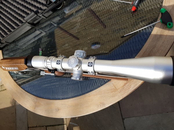

"Hynzie"that looks like fun do we know the scope brand?
Sure ...that's a March scope 8-80X56 - 2nd Focal Plane. Many are used in Field Target , primarily as they focus down to 10 yards, and are Japan optical glass...most if not all benchrest F class powder burner shooters shoot with a March scope. For Field Target - most will go for the March10-60X52 or 10-60X56 models....as they seem to be more accurate when ranging (using sidewheel) at 50 yards parallax mark as opposed to the 8-80 . Downside is the killer $ price tag; next best option are the Sightron SIII 10-50X60 (or Nikko Stirling Diamond) just around the $1K mark and a few bills...
March scopes USA > http://marchoptics.com/second-focal-plane
