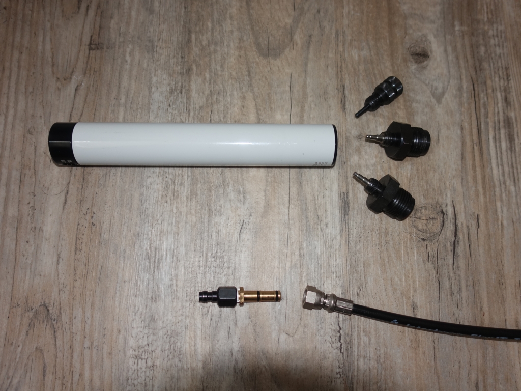

Pardini K12 and Hill MK4 pump
End of the hose has a 1/8" BSP fitting
Need to somehow fit it into one of the adapters on top
Well at least your gun fill probe looks like a male foster so you need a female foster quick connect for you pump hose end.
Pyramyd Air, Air tanks for sale, plus many others will stock it. Some places may sale you a foster with NPT threads and it does work but I would get the British parallel pipe also BSP as that's what it's designed for, NPT is tapered threads a BSP is not.
