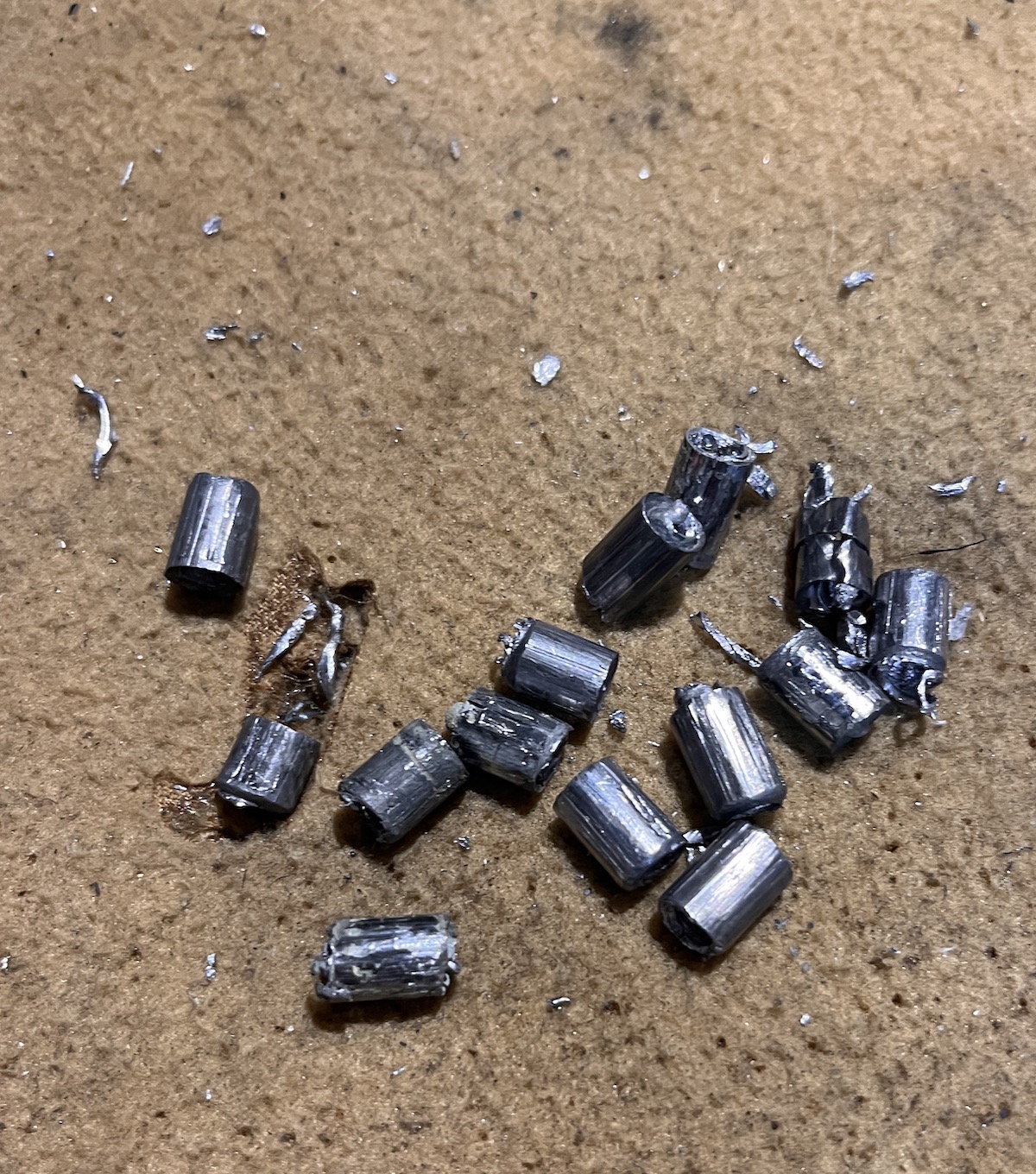

Boys.. If you hear different sound from the gun or you do not see or hear impact - Please stop shooting and reloading !
This is just a part ot all slugs i removed from a barrel:
That is brutalBoys.. If you hear different sound from the gun or you do not see or hear impact - Please stop shooting and reloading !
Not meYou kept shooting 14 times ?
LOL..the gun is with 760mm barrel.. He could use some more slugsDid that back up to the breech?![]()
With a lot of effort... it was hard.. I used a very long wood screw with thermo hose around it so it did not touch the barrel but just the projectile.. I screw in the bolt and pull hardHow did you get them out?
This is what happens when you leave your wife unsupervised!!!Boys.. If you hear different sound from the gun or you do not see or hear impact - Please stop shooting and reloading !
My opinion - because the man who did this will not admit - he loaded some slugs (maybe 3) and then made a shot...@shaman Which gun were these jammed in? Are these commercially available slugs or slugs that you or the gun’s owner made? Cast or swaged slugs? Which caliber?
@shaman I guess he figured, “I’ll just shoot out the jam.”My opinion - because the man who did this will not admit - he loaded some slugs (maybe 3) and then made a shot...
The gun is Hatsan Factor Sniper L with 76 cm barrel with choke. The slugs jamed just before choke.. Then he shooted 15-16 times![]()
No way...like how?? You would think you could feel 15 slugs slamming into each in your barrel. How do you not just stop to check? Specially if your shooting 60gr slugs. I was thinking it was a custom barrel for a semi auto/full auto air rifle.My opinion - because the man who did this will not admit - he loaded some slugs (maybe 3) and then made a shot...
The slugs - Javelin 60 grain as i remember
