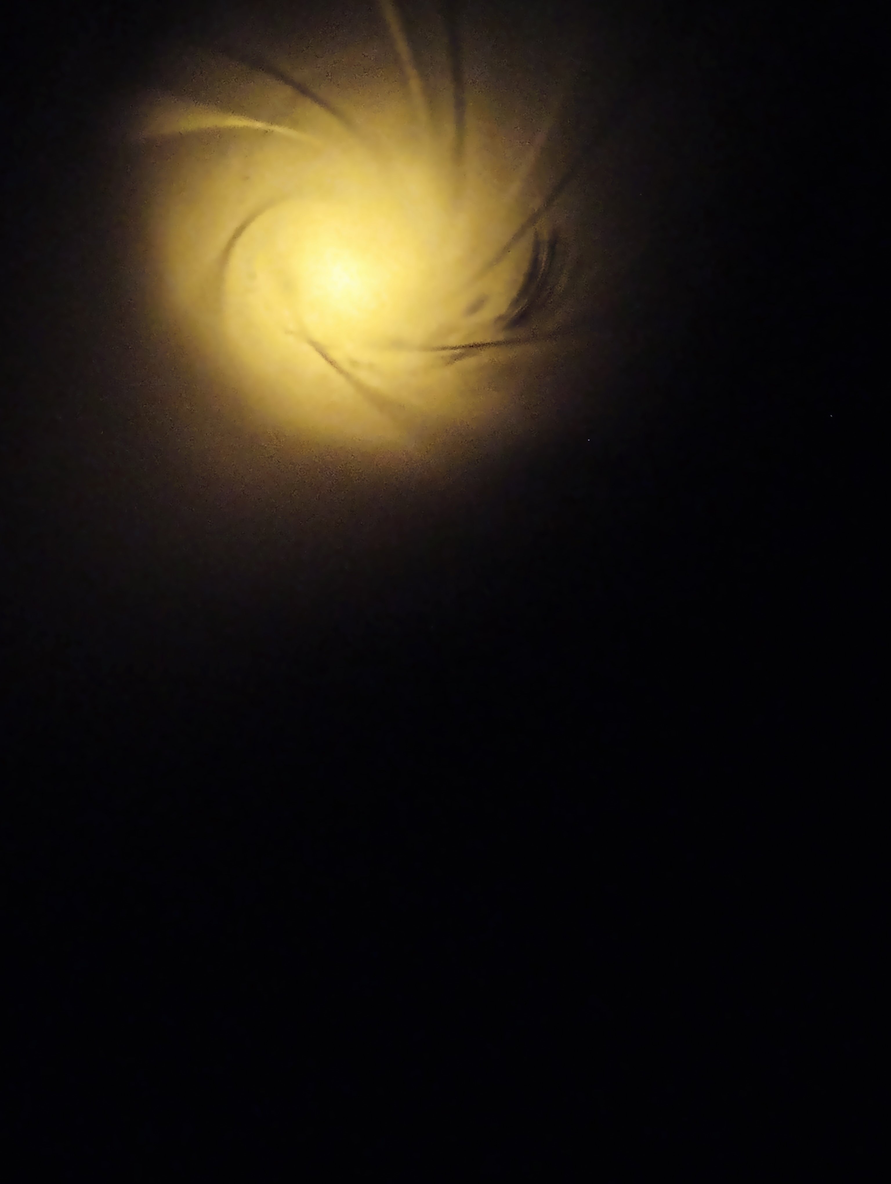

I got a .457 pbba and there's this little knick or scratch in the barrel in the first few riflings on the chamber side will it still be accurate?

How do I do that?
Several ways. I think the best is to use a slug cast to your barrel and then used as a jag that you put the lapping compound on. The easiest might be to just use a .457 jag and tight cleaning patch with lapping compound. It may take 50 - 100 passes through the barrel to polish the scratch, but it may take the edge off enough to help any accuracy issues. Lapping a barrel is usually a good thing anyway.

You could also try lapping your barrel to try to remove any sharp edges on the scrape.
Terry Tate suggested steel wool and gun cleaner to remove the burr and then it won't scrape the bullet making lead come off and making it super dirty in the barrel and not accurate I think it will work!

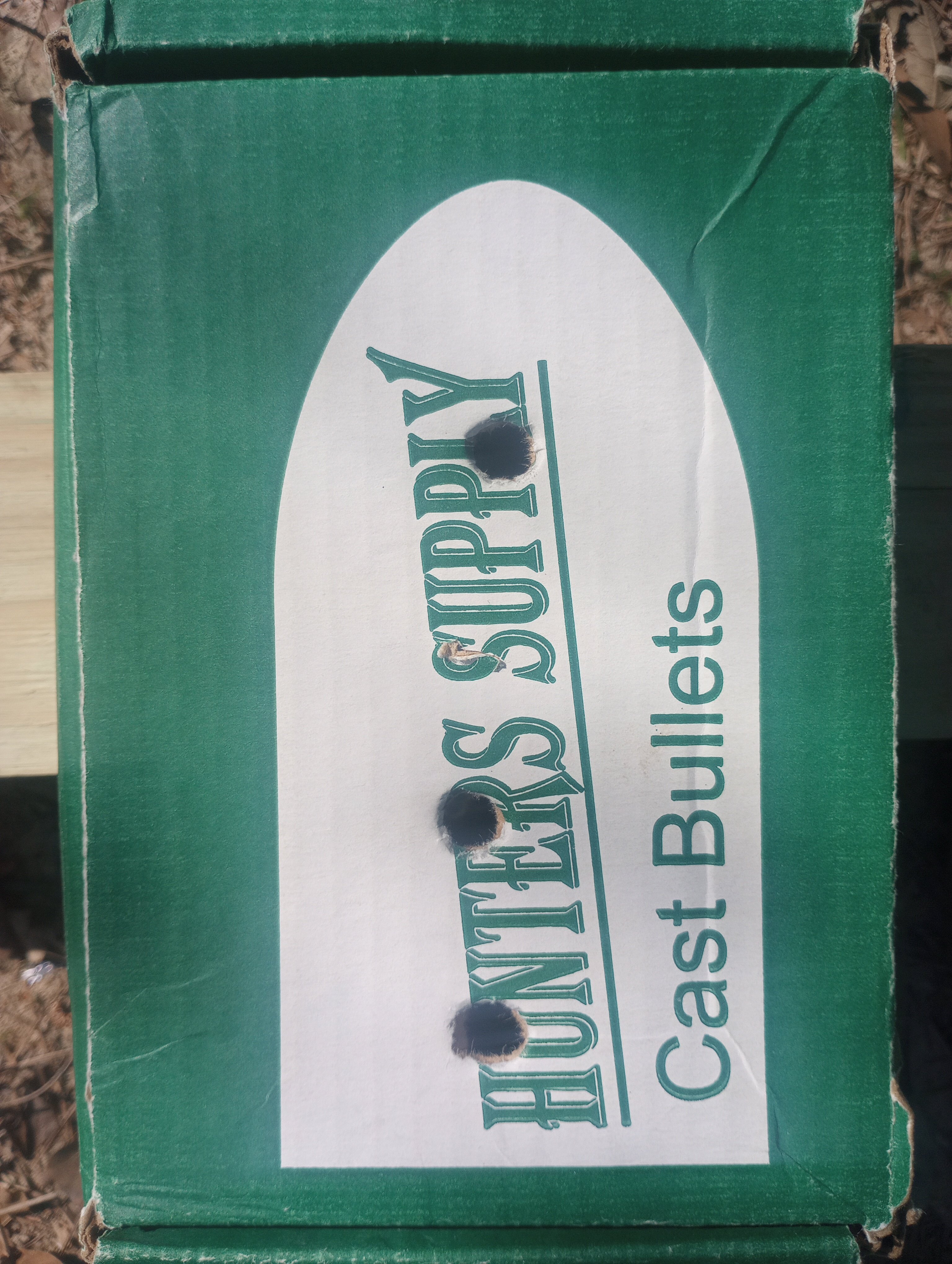

It didn't come like that I did that using junk hunter supply slugs shot it both times and 2 slugs got stuck in barrel I got them out it's still shooting accurate but then it started not too shoot accurate and another slug got stuck that was the second I'm getting some way better slugs and I cleaned the barrel very good
Do you know if Hunter Supply slugs are sized to .457? I see either .452 or .459 on the website. If you purchased .459 and they are not sized, the bullet could be .459- .461.
Reactions: anonymous_.457
I clicked on cast lead bullet instead of air pellets/slugs:
I still wonder if their slugs are as-cast or sized. I couldn't imagine selling them without being sized, but companies do. Bummer that you are in this situation. At least none of the bullets I shot as-cast got stuck. Only thing that happened to me is they didn't group well, forcing me to size someone else's product.
They said they hand size the 310 grain I finally got the slugs out and got it to shoot good im thinking about buying the scba tank and altaros booster pump
