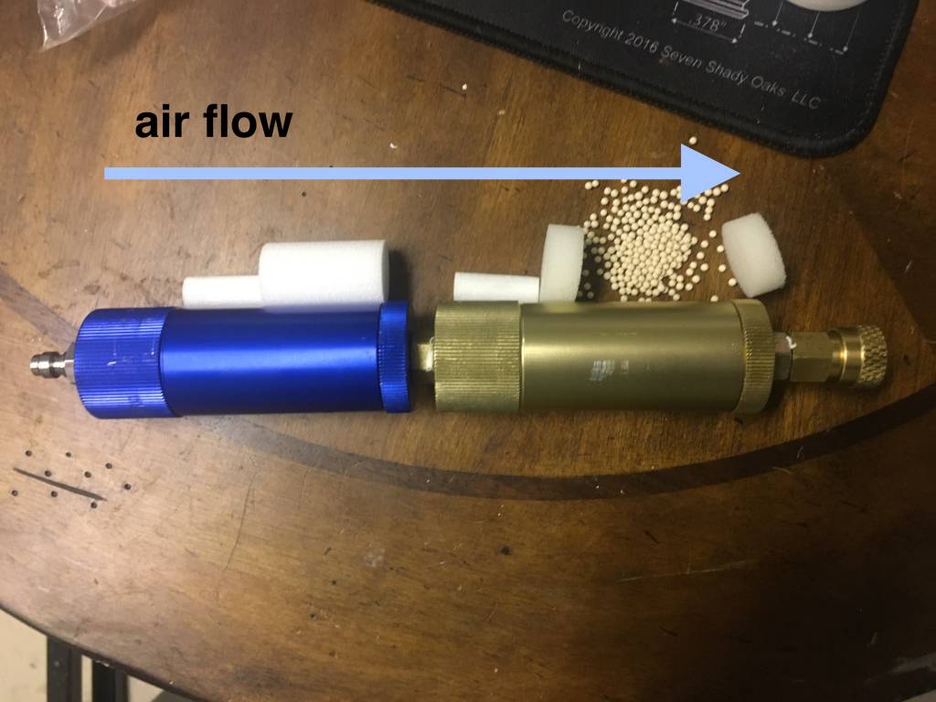

Any way you could post a picture of how and what kind of filters , fitting your using ?
 i bought two of these:
https://www.amazon.com/gp/product/B07M8LBMN4
the first is filled with these:https://www.amazon.com/gp/product/B084P943ZT larger filters
the second has the included smaller filters, and in between molecular sieve: https://www.amazon.com/gp/product/B07W62755W
i took the foster fitting off one, and a nozzle off the other, and screwed them directly into each other to make a longer solid filter.
in order i have pump->hose->filter with fabric only filters->filter with molecular sieve-> gun
