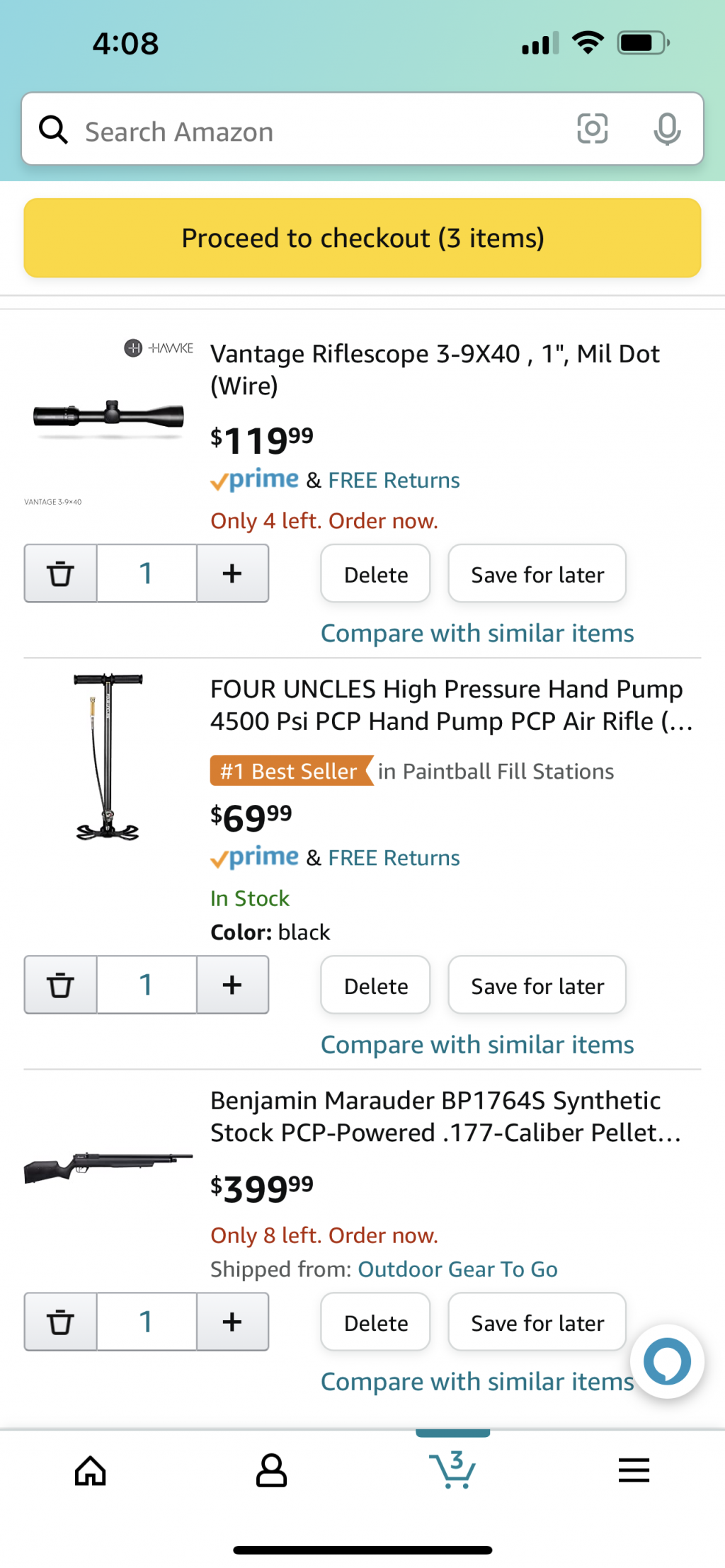

My picks for you are a Benjamin Marauder, Four Brothers hand pump, and a Hawke Vantage scope.
This package comes in way under budget and these items are tried and true
