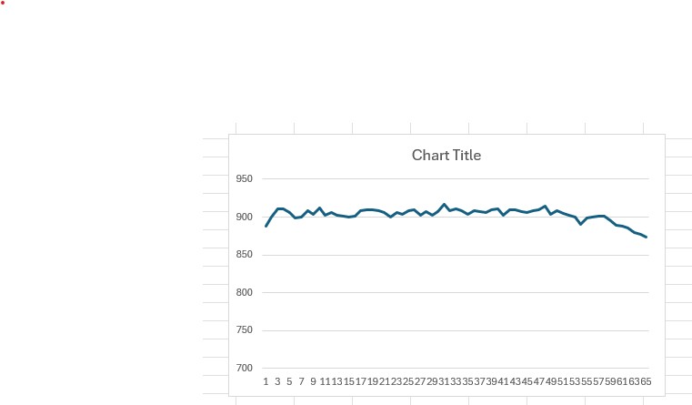

This would be considered the efficiency of the gun, I assume. My Avenge X 25 cal will get 50 good shots with a 25 grain pellet. Over those 50 shots the pressure will go from 300 to 150 bar for a 3 bar/shot air usage. Does sound about right? I’m sure that all guns are different with different valves and all but does having a good tune also translate to a more efficient system? I get a SD of 4 for those 50 shots at an Average velocity of 906 FPS. It seems that no matter how I tune things over velocities from, say 880 to 920 FPS, the SD is always right around 4. I’m seeing pretty good accuracy at 25 yards with the AEA 29.5 grain pellets (I didn’t chrony those but will at some point) and tomorrow I’m getting to the range to try some 50 yard work.
Tony
Bar per shot also highly depends on the volume of the tank/tube. Your tune sounds extremely efficient for the gun so I wouldn't focus too much on that. Looks like you are in the right track to very good results. I'm excited to see how those pellets perform. I hear really good things about the AEA pellets. Please let us know how they do at the 50 yard range.

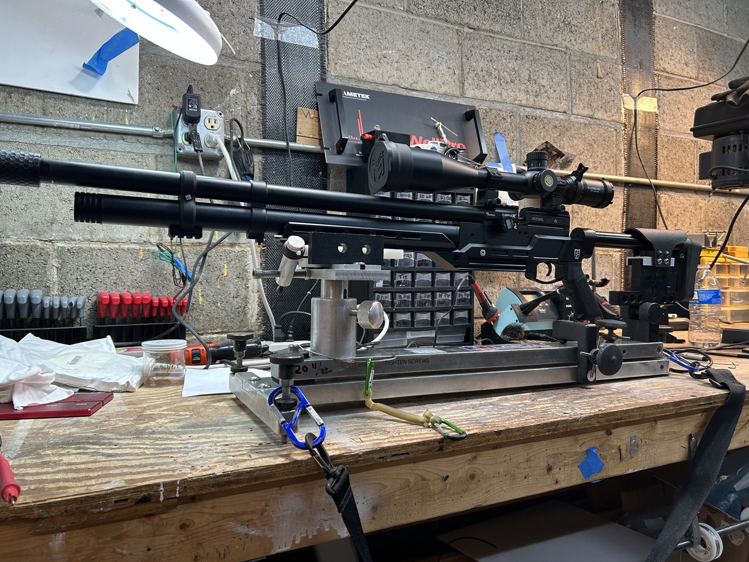

Damn that set up looks good. One of the best looking avengers I've seen. Great build.

Thammer,
Thanks! That rear stock is an Ace/dDoublestar that I’ve had on different builds for years. The length is perfect for me. I can’t handle the rattling around on the M4 type adjustable stocks. The two I have are both screwed down tight where I need them. I made the rear bag rider.
The rest is a PQP lite model. Kind of almost cheating because the gun is sitting in an artillery cradle. The rimfire rifle has a 0.75 ounce trigger so I get things all lined up and then wait for right condition to touch off the shot. No other part of me is on the rifle But my trigger finger. You’d think that every shot would then be an X but noooooo!…..not that easy.
I really like the Saber Tactical stock. To me, the AV tactical stock with the tube looks clunky and the ST really streamlines the look.
