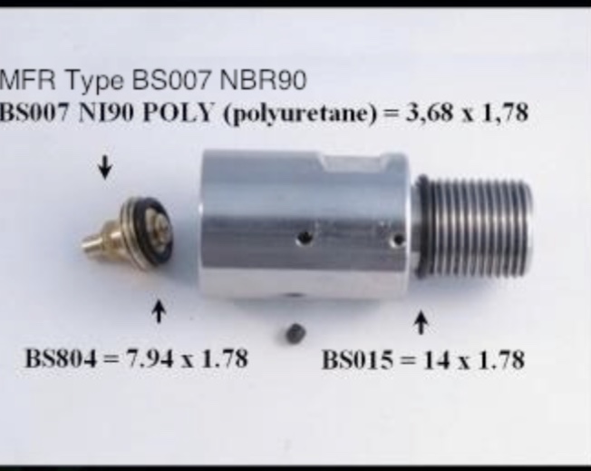

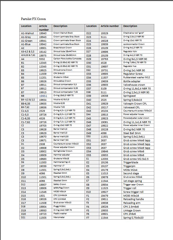

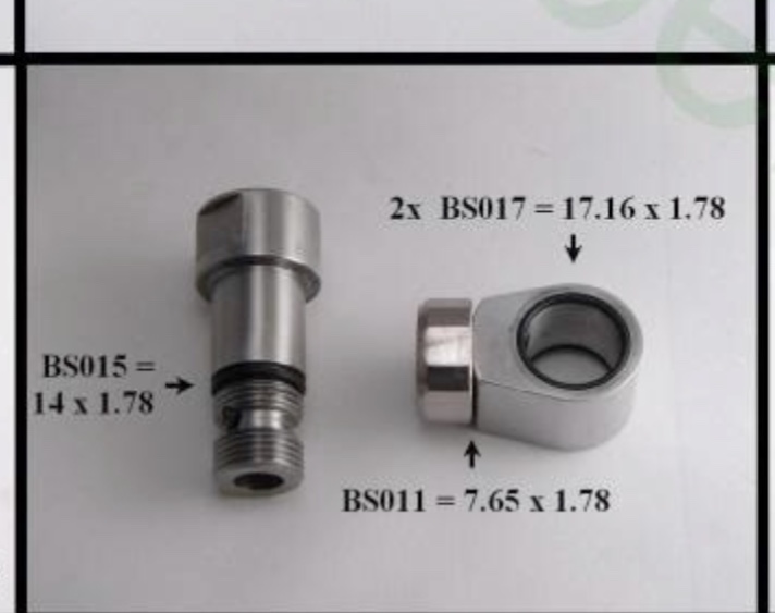

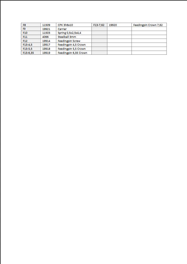

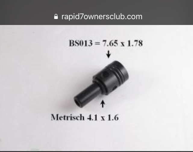

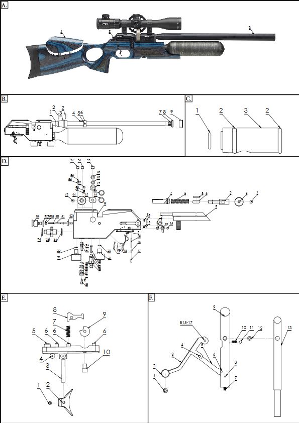

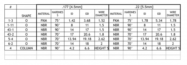

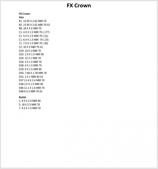

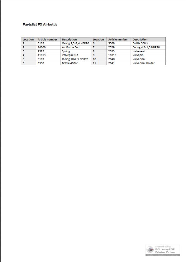

FX Crown O'Ring Database & Parts List / Dirte
FX has released their Crown parts list. Here is a list of the metric O'rings.
FX I

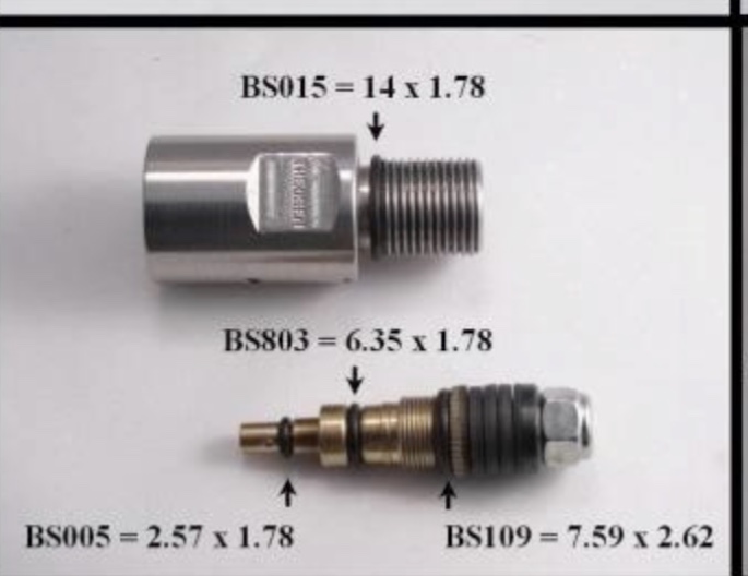

HW 100
Here's the full list of factory O-rings and the two recommended alternatives (bolded)
O-ring HW 100, 37.1 x 1.6 Cylinder clamp 2682C
O-ring HW 100, 15.6 x 2.5 Barrel clamp 2682B
O-ring HW 100, 32 x 2 Magazine 2603A*
O-ring HW 100, 13 x 2 Adaptor A 2704
O-ring HW 100, 2.57 x 1.78 Adaptor B 2703B
O-ring HW 100, 3 x 1.5 Valve stem 2655D
O-ring HW 100, 12 x 1.2 Breech block main (12 x 1) recommended 2658
O-ring HW 100, 5.5 x 1 Breech/probe seal .22 2659A*
O-ring HW 100, 4.5 x 1 Breech/probe seal .177 2659A*
O-ring HW 100, 4 x 1.5 Probe buffer 2618A*
O-ring HW 100, 2.57 x 1.78 Main valve inlet 2665D
O-ring HW 100, 7 x 1.5 Main valve outlet 2666
O-ring HW 100, 2 x 2 Main valve internal (2.57 x 1.78) recommended N/A
O-ring HW 100, 7 x 1.5 Regulator piston 2668
O-ring HW 100, 10 x 1.5 Tension adjuster (sometimes omitted) 2672
O-ring HW 100, 8 x 1.5 Barrel 2679

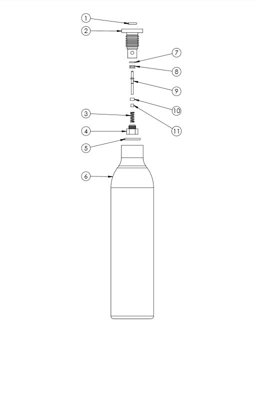

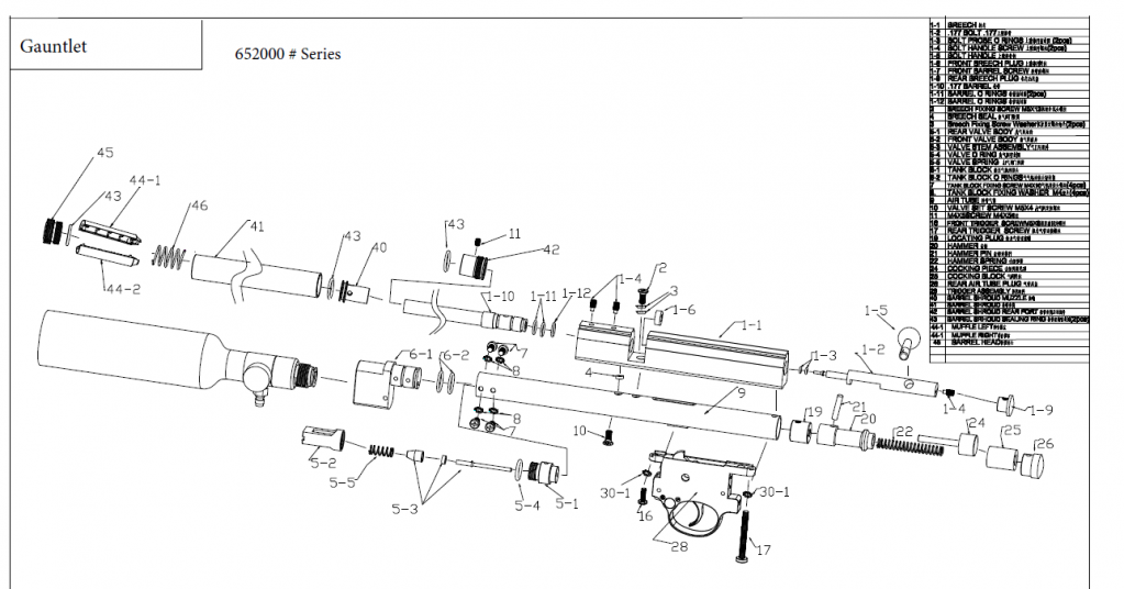

Taipan Mutant / Veteran per mughram
Simplification of the manometer for the front plug 9.25 x 1.78
Friction ring of rotation of the cap 13 x 2.5
Filling nozzle 2 pcs 4.47 x 1.78
Check valve 1 pc. 4.47 x 1.78
Sealing the front plug on the tank 1pc 23 x 3
Filtering of the filter 1 pc. 9.25 x 1.78
Filter removal 1 pc. 7 x 2
Piston seal 1pc 2.9 x 1.78 PU
Piston seal 1pc 6.07 x 1.78 PU
Seal of conical bush 1 piece 12,42 x 1,78
Sealing on the tank 2pcs 23 x 3
Sealing on the tank 1pc 23 x 3
Seal on the valve body 1pc 13.5 x 2
Seal the trumpets on the barrel 1pc 11 x 2
Seals of breech on calibers:
4.5mm -4.47 x 1.78
5.5mm – 5.28 x 1.78
6.35mm – 6.07 x 1.78
All not mentioned rings NBR-70
