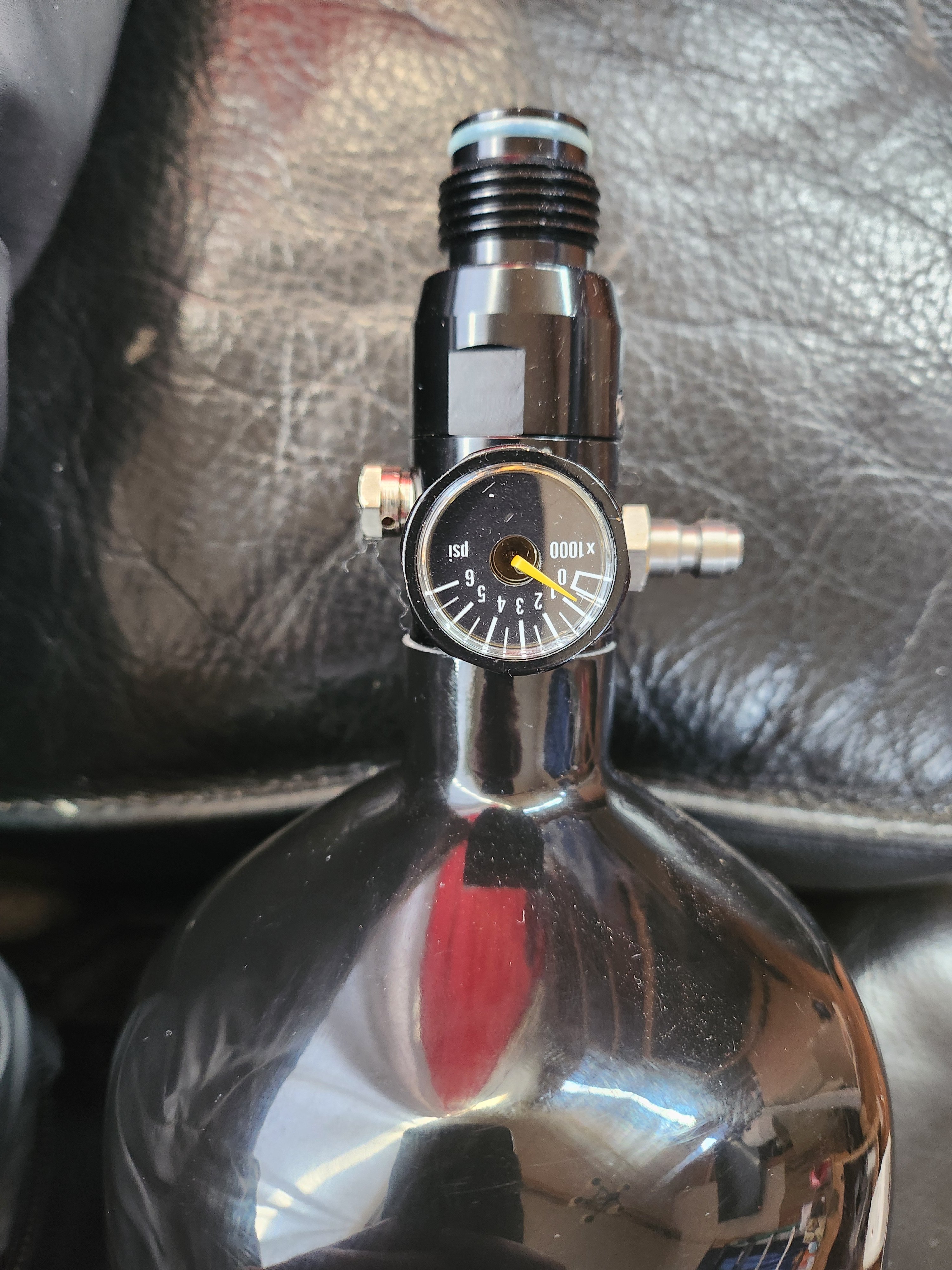

Hello,
I am seeking some quick advice on how to utilize this cheap pcp tank I got. I am concerned with using this as a fill tank, not a constant feed air supply. Upon getting it to hold air I realized I am missing the component to allow me to use it as a fill tank. Can someone tell me what those are called? Maybe provide a link? It seems to me that the top half of the block is exchangable for one with a fill valve and handle, or would it require another component in addition to what's here?
The tank is partially pressurized, kinda an oops on my part.
I finally have a chronograph on the way as well as the 110v power adapter for my cheap compressor so I'd like to get this tank into service.
On another note, it seems this one may regulate as 4500 input and 800 output. In relation to filling small airtubes to 2200-3000psi, have I selected the wrong product? Need a whole new valve setup?

You need a valve on the tank to open & close off flow of air to whatever you're trying to fill from it and then, for maybe refilling that tank. You'll need to depressurize the tank, remove existing "valve" & get the width & thread pitch dimensions of the neck to find a valve that fits. An 800psi outflow isn't worth much for the airgun application too. Someone might chime in about WHERE to find a valve. The male foster fitting on tank probably has a one way check valve & is for recharging it I think.

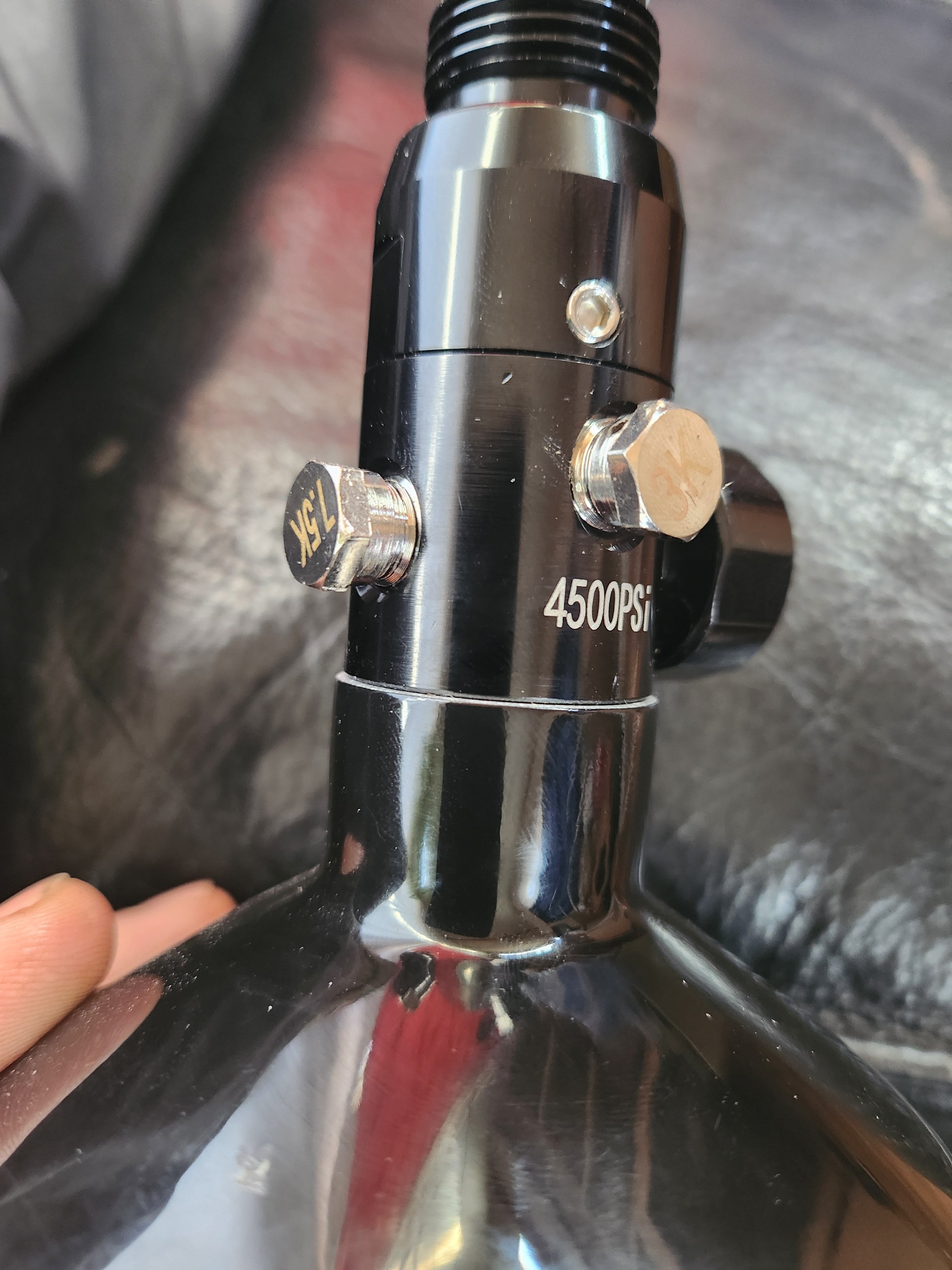

First off, that is a regulator for a gun with a G1/2-14 fitting on the top.
You need an HPA or PCP fill station
They *usually* are not regulated so when filling a gun from a tank be careful to not overfill if you gun bottle/tube is rated less than what you have in the tank.
There is a regulated fill station on AliExpress if you want to go that direction.

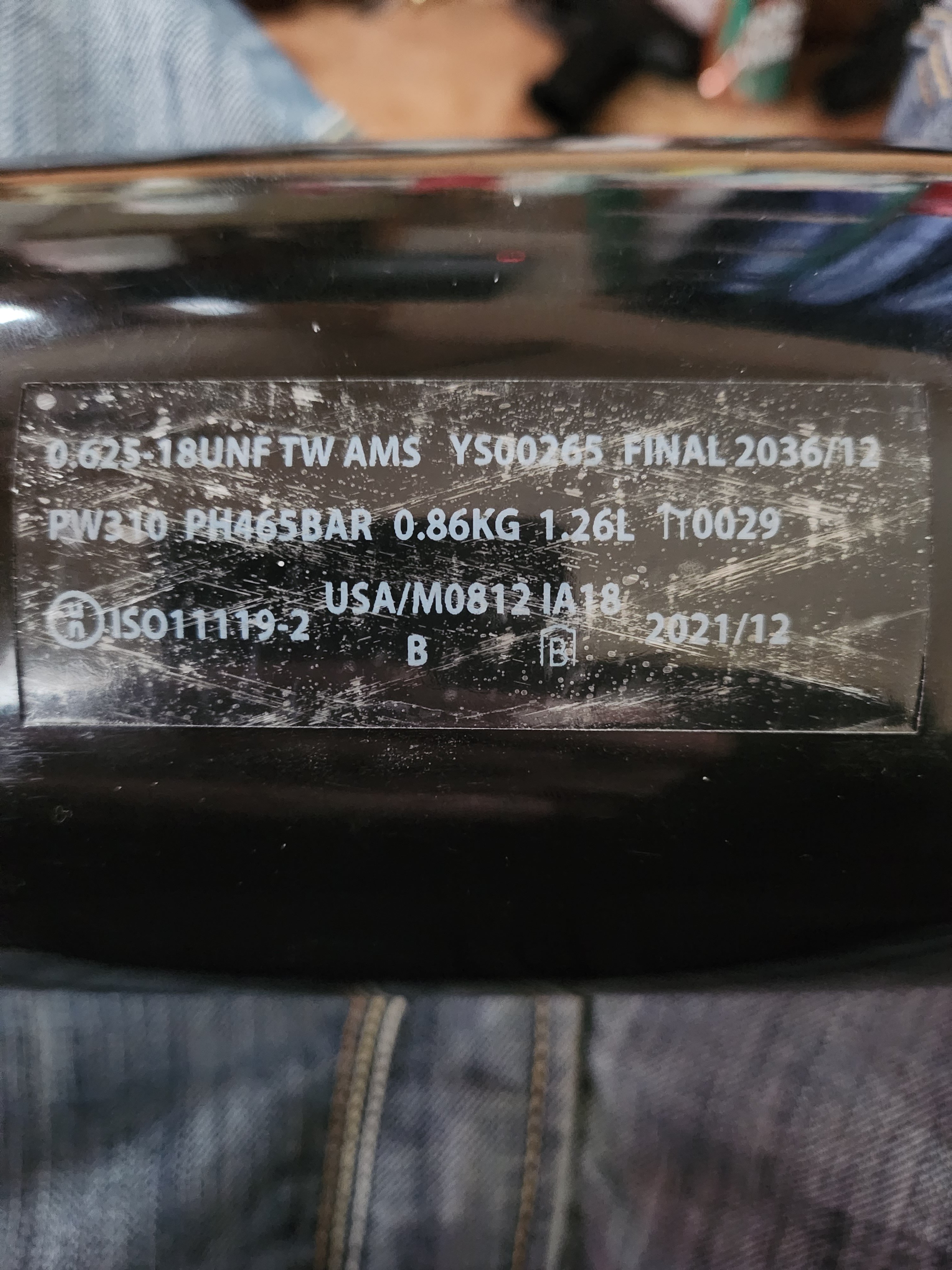

Please check the max fill pressure on that tank.
It says 465 bar, which is over 6000psi. The lower valve block says 4500psi. Considering the tank says 465 bar it begs the question: Am I legit able to fill it to 465bar/6000+psi if I procure a valve capable of that? I assume it would require a very powerful compressor which I won't be getting, but it's possible, right?
