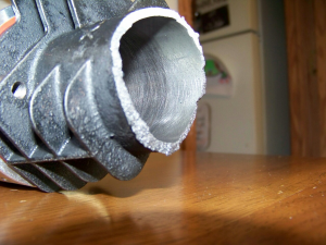

So, full of confidence i went to disassemble the double piston compressor and here is what i found wrong:
Replaced those 2 screws with anti corrosion coated new ones. Replaced HP segments and overall cleaning. Happy ever after.
Now here is when i ask for opinions for why do you think the 2nd compressor exploded.
My thoughs are it was caused by a VERY stuck high pressure one way valve that was full of carbon (black) particles just like in the double cylinder. The oil i use is has the manual asks (iso100). The truth is that in every of the three these particles were present.

I agree with worriedmans suggestions but I use Nuvair 751 oil. I don't know if they ship to Portugal but I get it shipped to my house. Your pistons seem to show signs of detonation which can happen with cheaper oils with a lower flash point. Detonation would damage the second stage piston like your pictures show. I would invest in some better oil.
