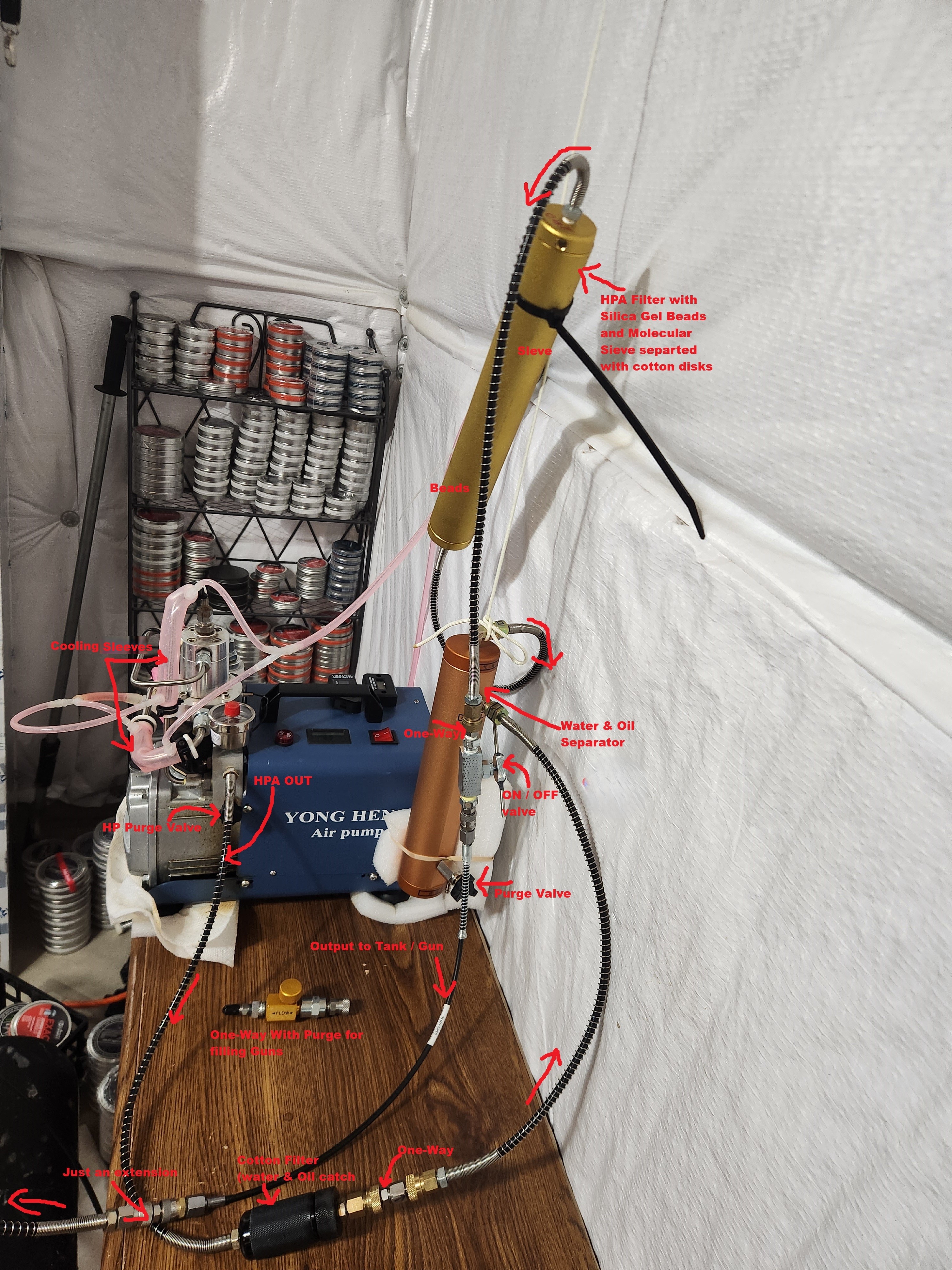

Here is how I get it done. The two big filters stay pressurized most all the time. I check them twice a year and if the indicating beads are 1/2 or more changed color, then I change all the media. The media filter is filled about half and half with indicating Silica and molecular sieve with cotton fiber discs top, bottom and center about 1/2" each. I almost never fill a gun just my 9L tank from 220 to 310 Bar once or twice a week. I purge the HPA Pump every 5 or so minutes during fill and the Separator at the end of a fill; not long enough to loose all the pressure in the 2 filters. I open the purge valve just enough to see if there is any water present. The cotton in the small black filter seems to do most of the work! I dry that one after every fill.
Maybe this winter I'll get around to hanging PVC from the ceiling to clamp the 2 big filters to.

@Lynx 1. There is a one way valve instead of a PMV. Keeping the filter pressured all the time saves the compressor from having to fill them from empty every time.
2. You can turn the set point higher and open the bleed valve at the desired pressure. Or turn it back on after opening the valve, it's an abrupt stop.
@JachHughs Yep it's backwards someone had a bad day or you just have the whole thing upside-down. It should be semitrical so in & out is only the label.
