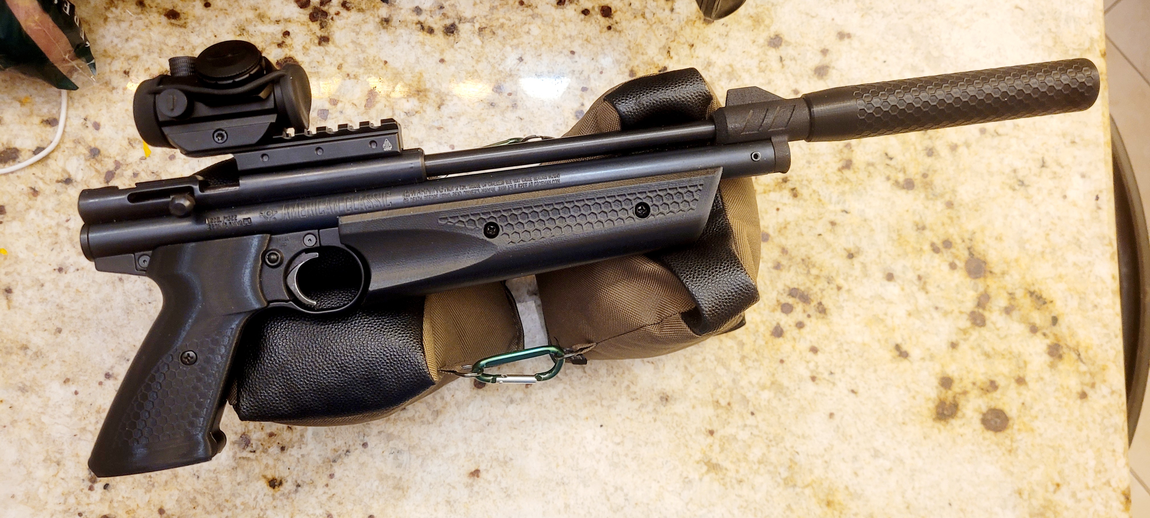

I picked up this 1322 two weeks ago now there's a bunch of money in it. (Folding stock on the way) but the pumping is annoying and accuracy at higher powers took a dump (it has piston, spring and port work)
