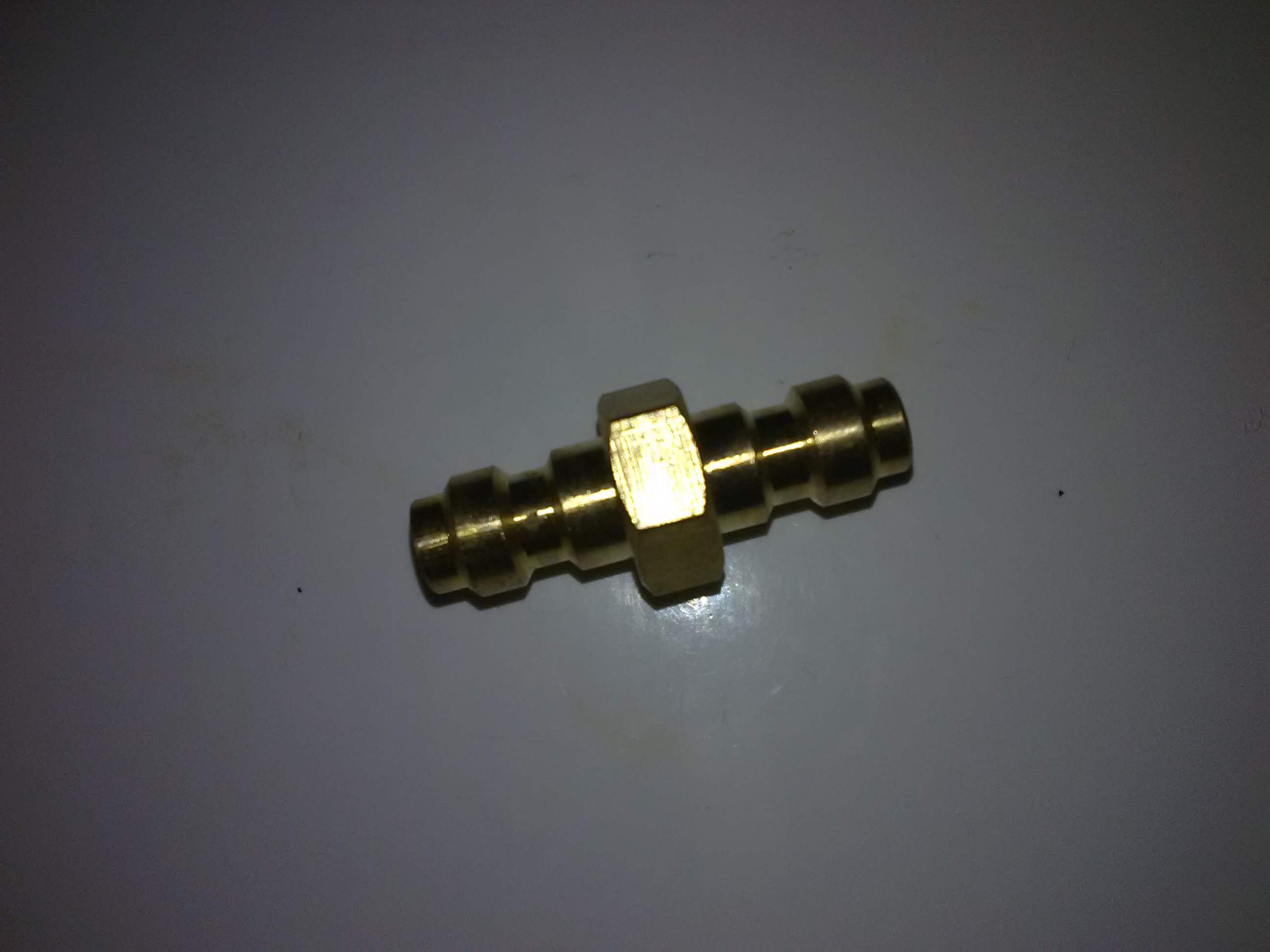

How did you connect the whip from the orange one to the black one did you use some adapter.
