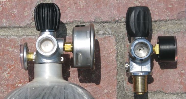

imo, do not get a valve with mini restricted orifice in it. It will cause longer tank fill times, more heat, and more stress on your small cheapie compressor.
If you don't have the capacity too throttle your valve correctly to not over fill your gun tank, then use a restricted orifice fitting in your tank to gun fill hose. So you can still fill the tank unrestricted. Mikuni carb jets will fit in many hoses/qc.
You can barely see the almost microscopic orifice in the valve on the left, much better off with the valve on the right with much larger orifice. You can put on any gauges you choose if correct valve doesn't come with gauges you like..
jmo
I would have to agree with you on it being best to have the orifice on the discharge side of the tank.
