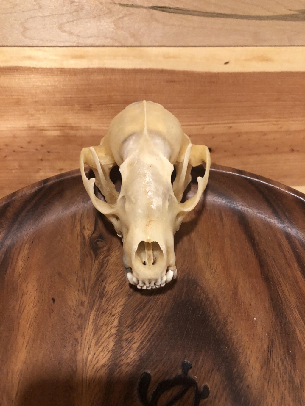

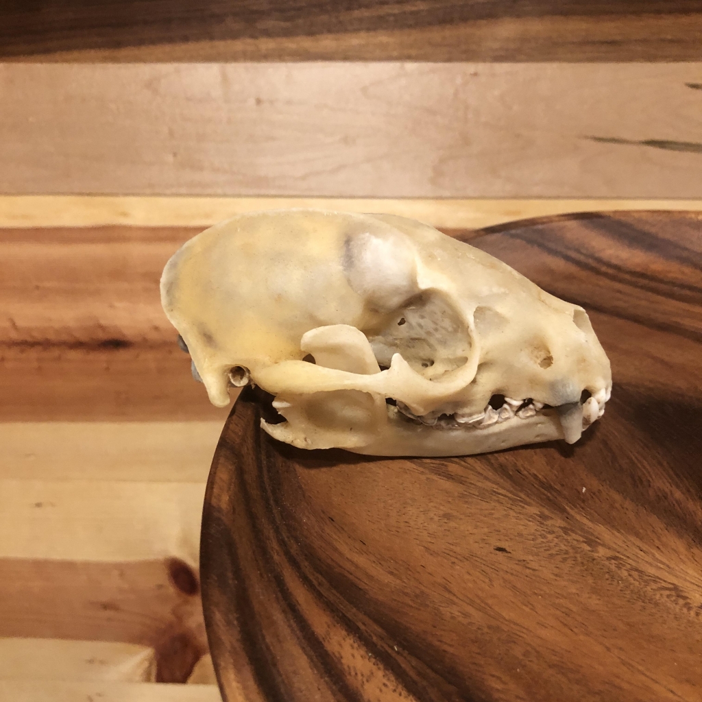

I used my .22 NOVA Liberty w/H&N Hornet and a shot to the temple at 25 yards with nary a problem.
The Hornet made a complete pass through the head so power was not a problem.

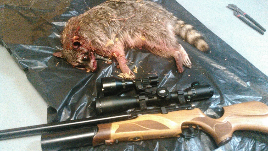

Its all about shot placement. If you shoot a coon in the ass with a 600 ft-lb 50 cal, it will walk away but will die a horrible death. If shot properly in the head, you can get away with a .22 @ 30 ft-lbs like how I did with this coon:
Got this one at 20 yards right behind the eye. If I had a choice of grabbing a .22 or .25 pellet gun to hunt with, I would choose a .25 as an all around gun.
