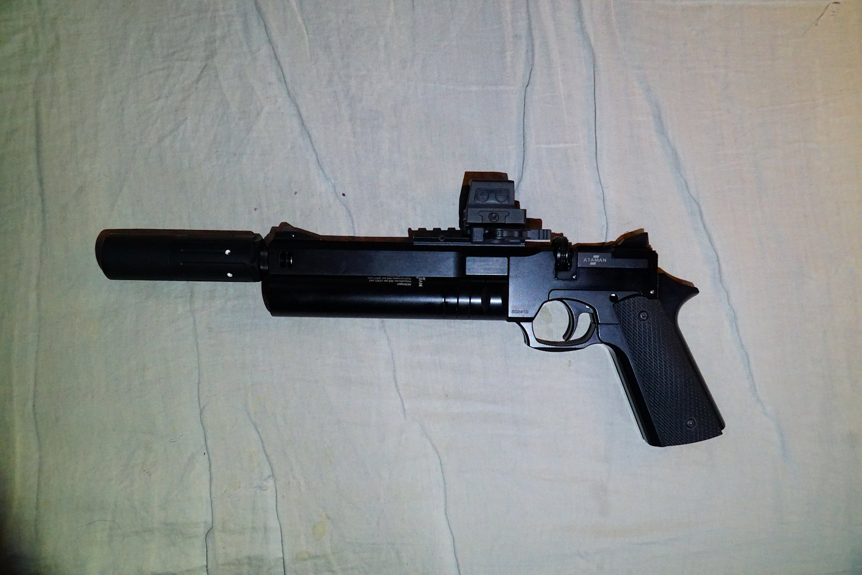

The Ataman AP16 (.22) has plenty of power and is adjustable, but slightly so. The trigger is also adjustable. Magazine fed.
Seems that they may not be currently manufactured, but I've seen a couple of locations where you can still buy new. Also, have seen used.

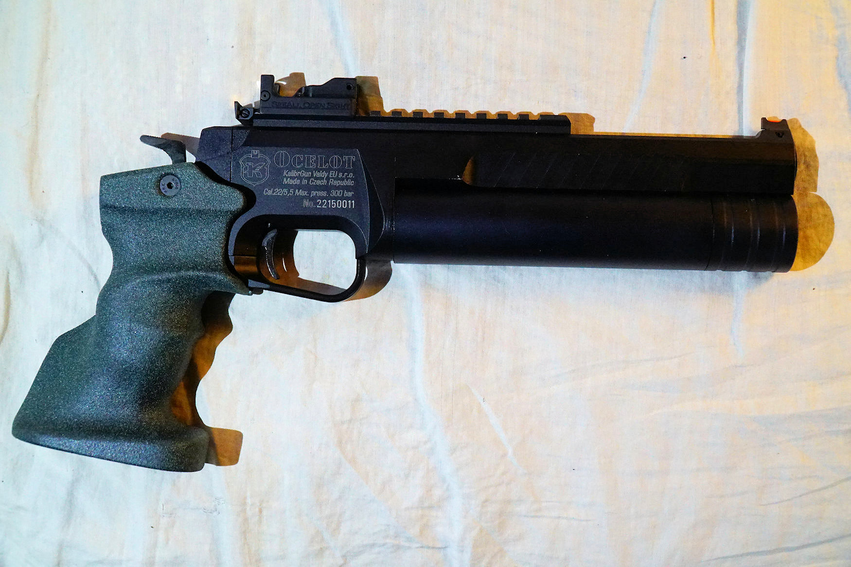

And the Kalibrgun Ocelot (.22).
You'll have to find this one used as I did. Also adjustable, trigger and power. Single shot.
