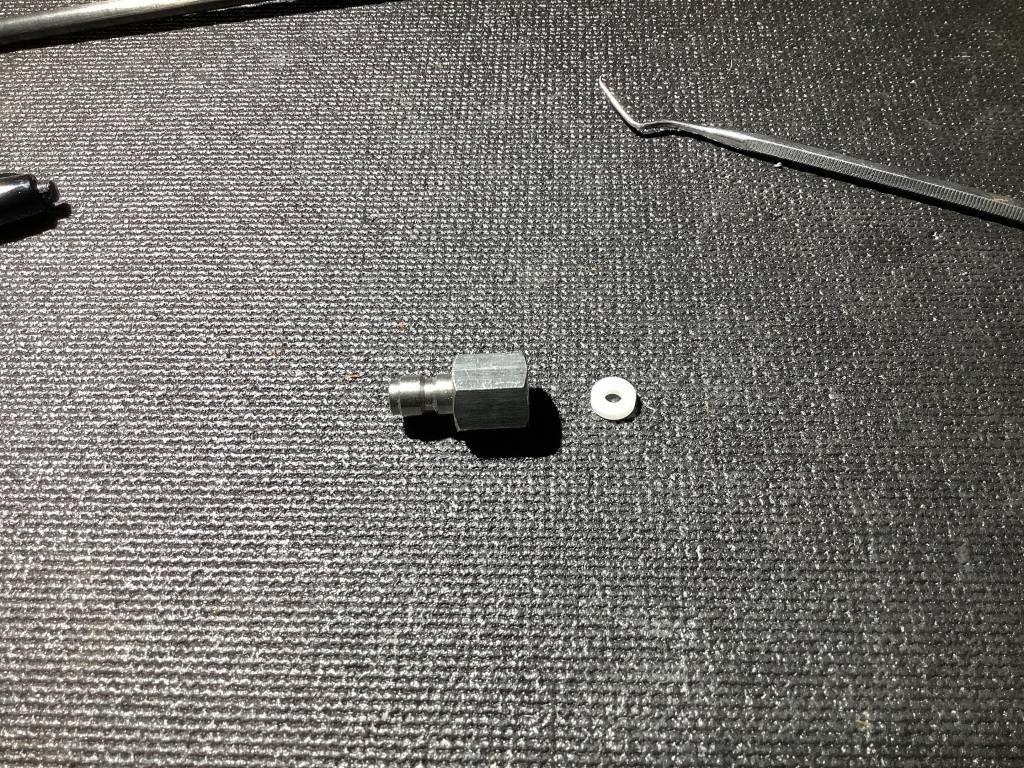

Anyone know where you can purchase these in the U.S. ? And, no, they aren't mints.
They are "O rings/gaskets" used to seal a PCP gauge for instance. They are used in the newer Kral punchers to seal the gauge. It is Kral part number AT 26 and Kral calls it a manometer O Ring but it isn't actually an o ring. It's a flat "plastic" ? disc that goes in the bottom of the gauge hole and the gauge screws down against it to seal the gauge.

Thanks for the offer. After thinking about the picture @Vetmx put on here, I went looking through my pump spare parts and found that a kit to repair a pcp pump that I had actually had two of those in the kit. Now I'm back in business. I'm still going to call PA and see if they have a few more for spares. I like that setup a lot better than using an oring in there.
