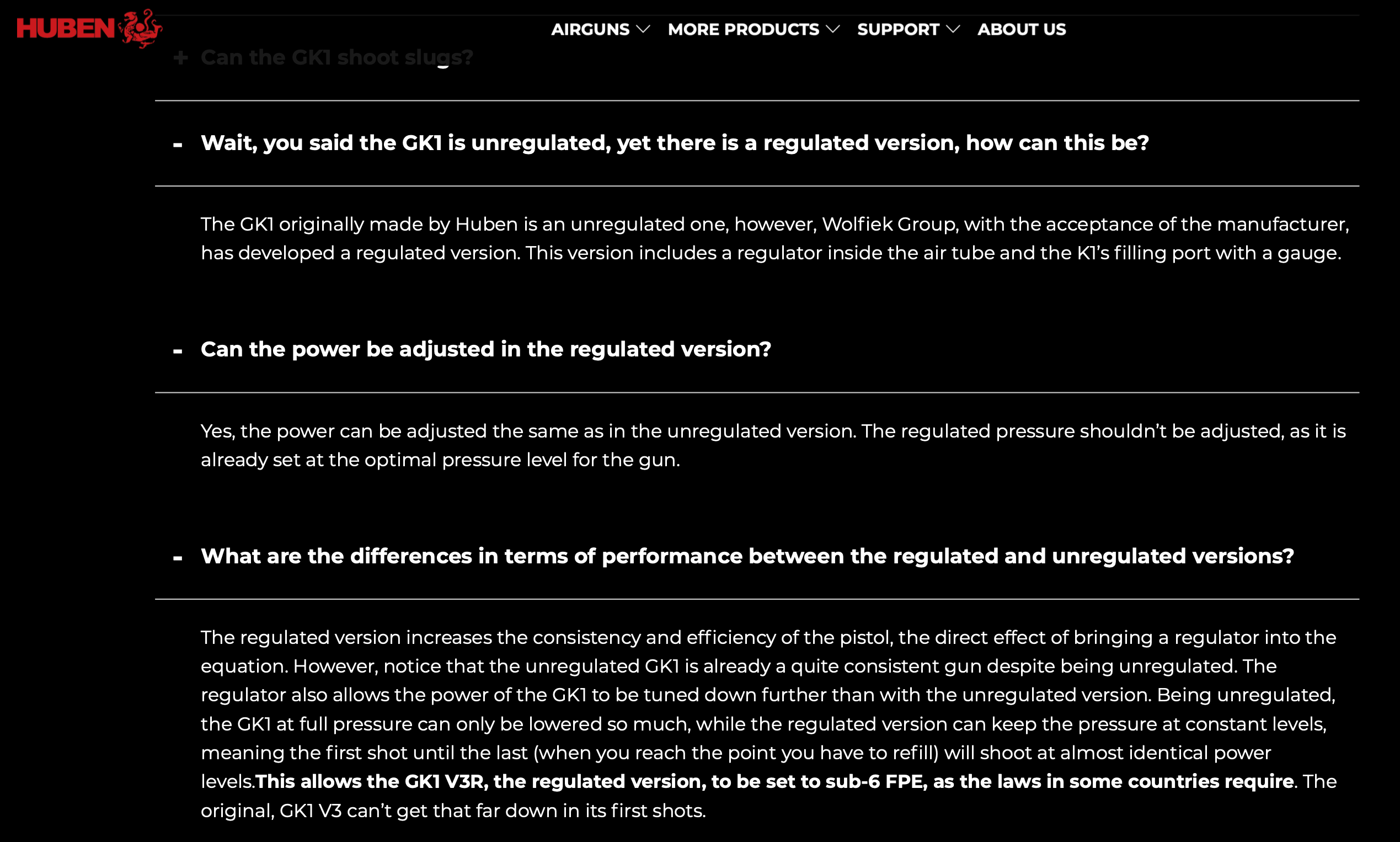

Have regulated GK1s not become reality yet? I've heard they were coming out for months now, and this is on Huben's website right now-
What would you call monkeying unregulated PCPs to find the optimum charge pressure to return the best powerband?
That isn't a Huben factory product but a conversion made by a shop, that isn't Huben website either.
