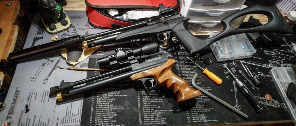

I've got two... They both make a ton of power... but there's no real consistent velocity to speak of. Result of a tiny air reservoir, and a valve/hammer combo that is not tuned whatsoever. I threw a regulator in one to fix it (turned power way down). The other I just turned power way up, and for some reason I shoots really well, but only using .25 JSB kings.
I do like them for their accuracy and simplicity. But the wood grips they come with are HUGE... If you opt for the synthetic grip with detachable stock, the grip on it is too small.. ?? why I don't know.
Top is .177, bottom is .25.... The .25 does not come with a mag. The receiver is not machined to accept one either.
