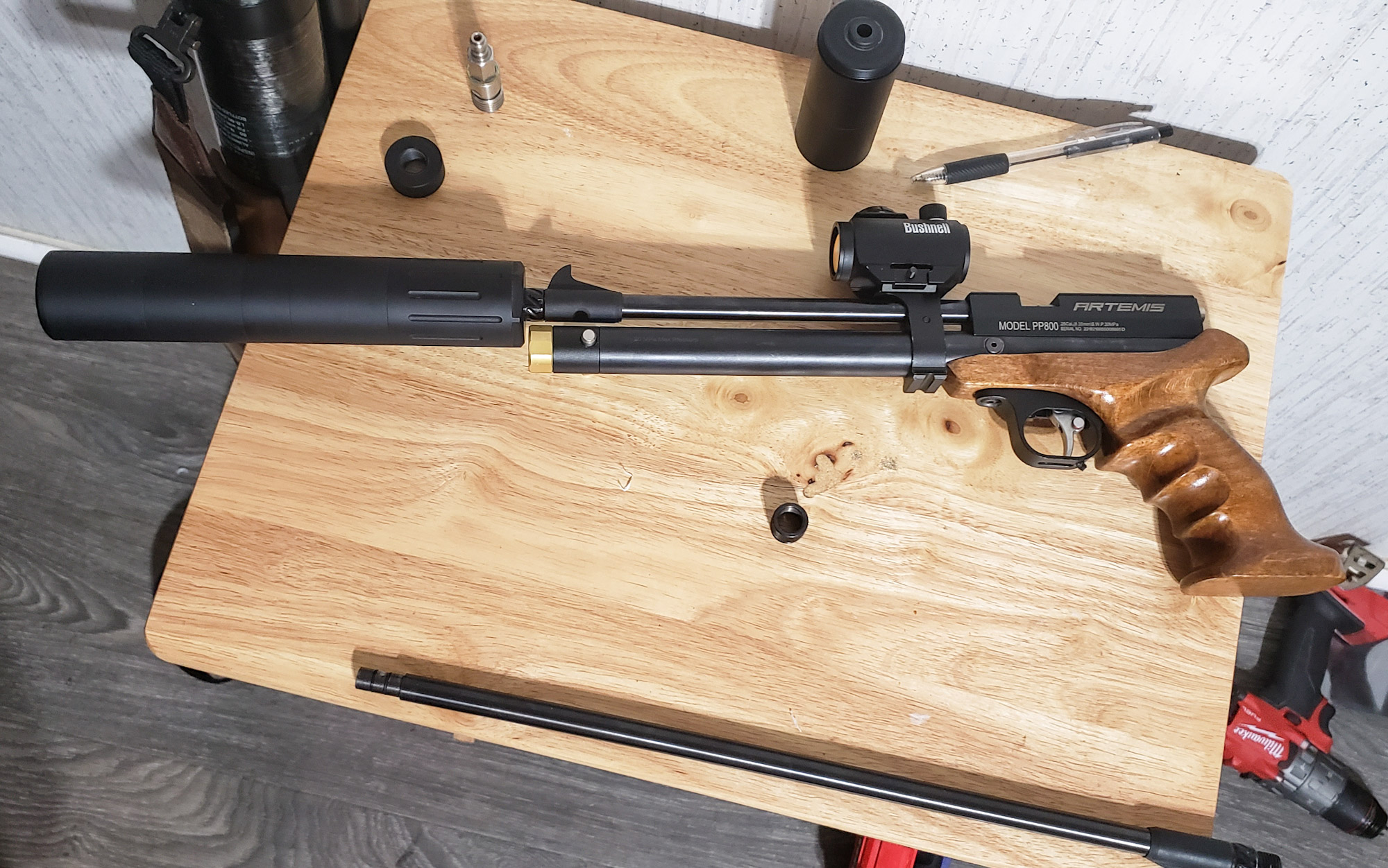

I own one bandit and pp800 (the same gun basically). While decent guns, they have wild power fluctuations. And the grips are very large in wood and rather small in synthetic. I fixed the wood grips on mine

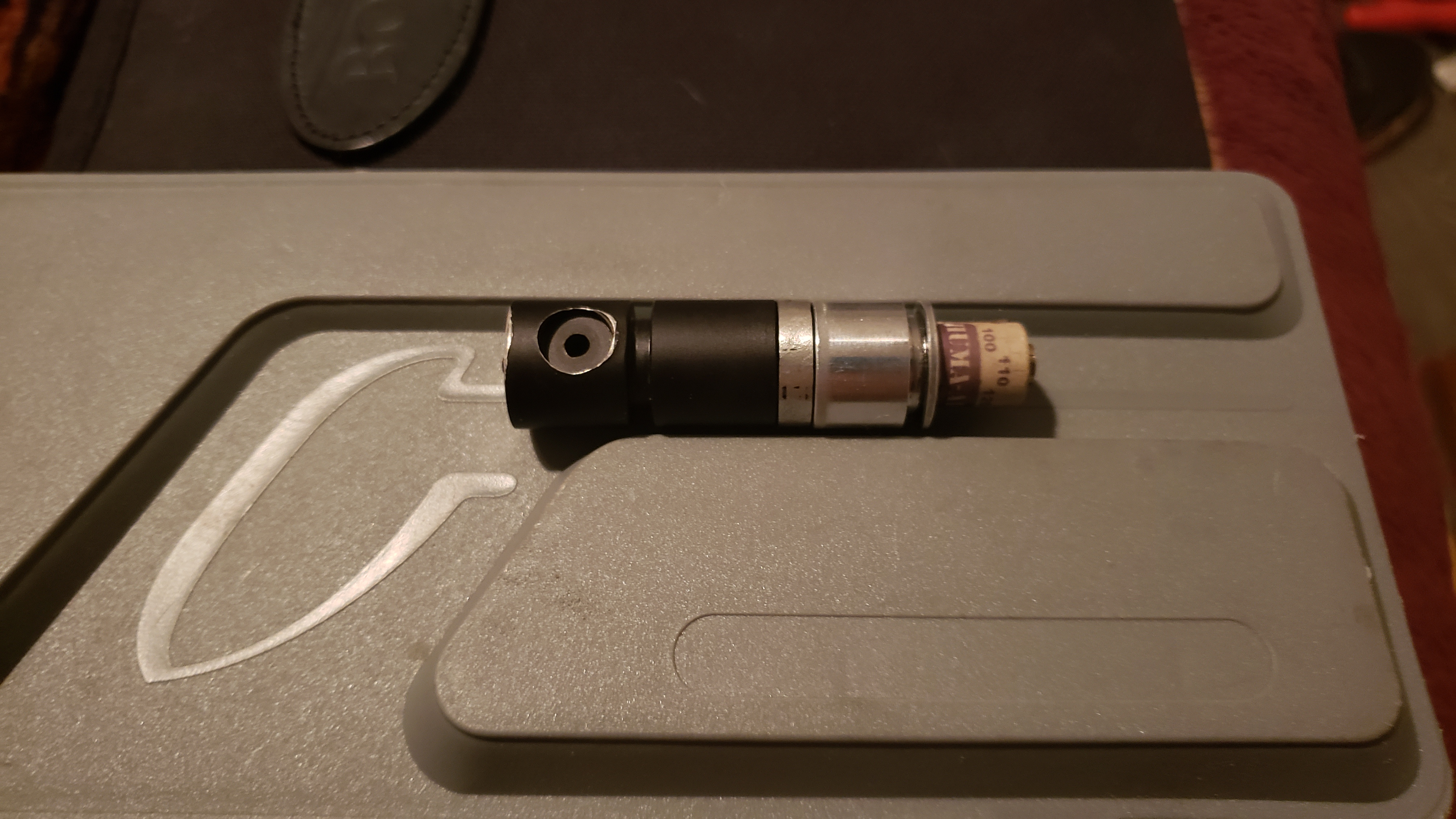

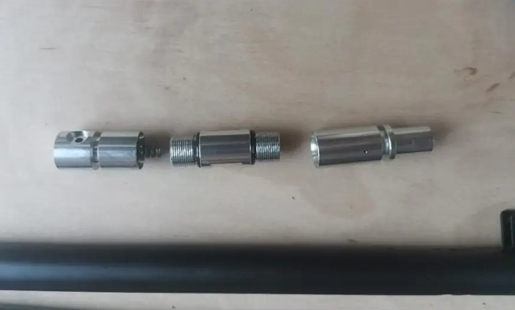

Also the pp700 has nearly double the air capacity as a regulated pp800. The 700 even has more capacity than an unregulated pp800. The regulator takes up valuable area inside the air tube, and quite a large bit, at that. The regulator on the 700 is built into the receiver block, not the air tube.
Below is what a regulator looks like in the pp800. The valve body on the far left normally has a small end cap. Here the plenum and regulator replace it, taking up almost half of the 50cc air tube. The pp700 has 70cc's of volume in the air tube, and the regulator takes up none of the space in it.

Regulator controls the pressure at which the gun operates, so it is typically much more accurate and predictable. And you tend to get more shots like this. *so long as the regulator isn't taking up a huge amount of space inside the air reservoir* like with the pp800.
Pp800's originally weren't regulated. Just look up airgun regulators and you'll see various photos of them. They're various shapes and sizes, but most are pretty similar in design and function. And most need a plenum as well. A plenum is just an area where regulated air can be stored so that there is enough that the gun can produce adequate power. High pressure air goes into the reg from the reservoir and then gets stored as lower pressure air in the plenum. If the space for regulated air to be stored (plenum) is too small, the gun might not make enough power. But since the pp800 was never designed for any of this and it was an after-though, it's pretty poorly implemented.
Now, one of mine is regulated, but I deleted the plenum and did some custom work to the valve body to make it work. The regulator in my 800 takes up very little space in the tube. But it's custom. What I did to make it work like that is not really beginner stuff.
And mine still holds about 40 percent less air than a 700 and makes less power

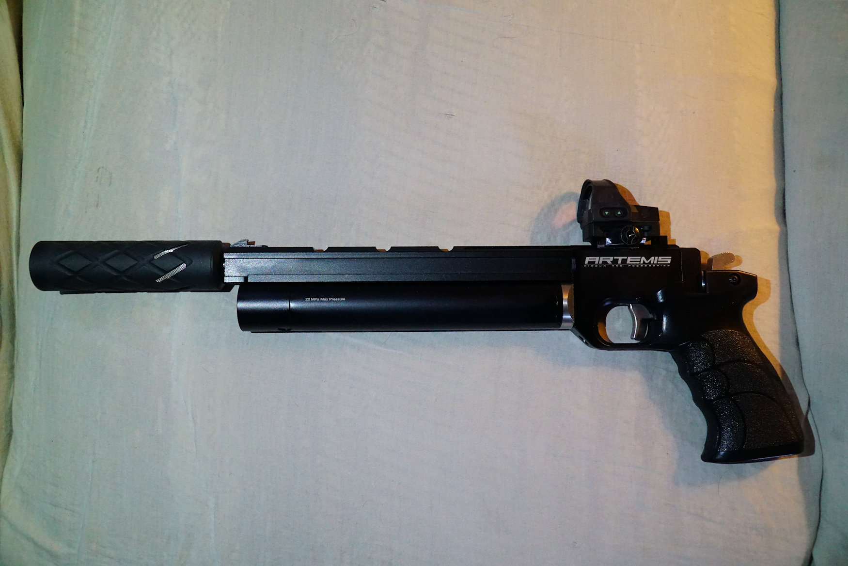

Agreed, the PP700S-A is a very nice gun, especially for its cost. Though it's a single shot, that's not a problem once you start shooting and hitting those bulls eyes ! Easy to shoot, very reliable, few parts, so in the unlikely occasion of it needing repair, it's pretty simple and parts are available.
Mines got an older Sig Sauer red dot sight, and a 0DB suppressor on it.
Mike
Mike

As noted, I assume that you mean the muffler, a 0DB (zero DB) on the end of the barrel ? Actually, don't recall where I bought it. I do know that's from a normal shop here in the US.
Just a hint though...the Huma (Mod30mm or Mod40mm) suppressors are a VERY good choice for sound reduction. Plus, they are adjustable. They are made in sections, and can be made longer OR shorter...as you like. I'm slowly switching most of my guns over to the Huma brand.
I don't recall where I bought the adapter either. It's either from where I bought the gun -
Or possibly DonnyFL .
Mike
