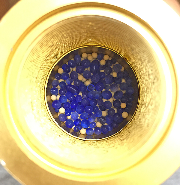

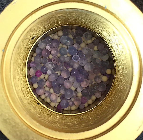

The big gold filter contains13X molecular sieve to absorb as much as possible the remaining water vapor. Colored silica gel is put at the end to indicate whether the molecular sieve need be replaced.
Deep blue means no need to replace :
1563275022_15328658665d2daf0e79a4d7.20378545_silica at inlet after 6 days.jpg
Turning pink, need to replace :
