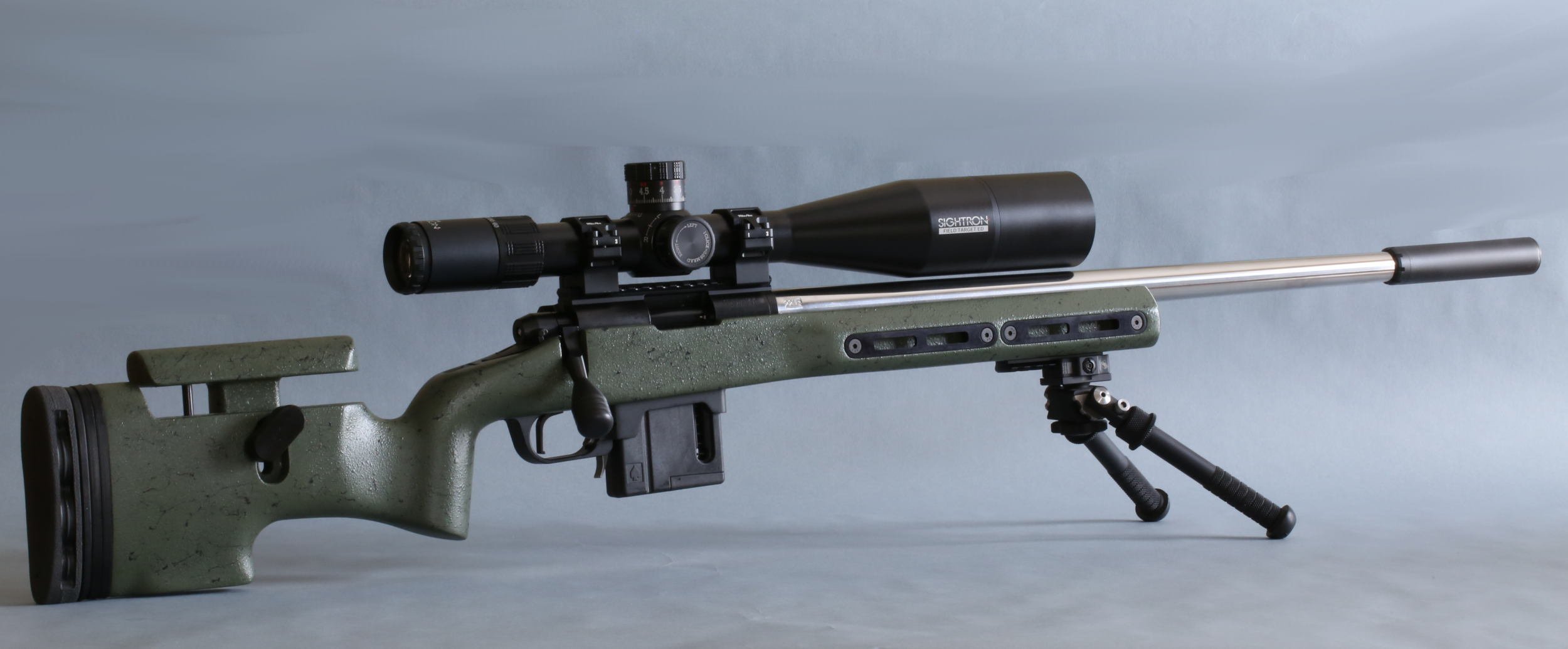

One of my Vudoo rifles with a Sightron S6 10-60x56.
So about $4000 for the rifle and $1800 for the scope. If you go to PCP in .22 cal. or higher, and spend that type of money you could be pretty close to your goal. You will probably be shooting slugs though and not pellets.

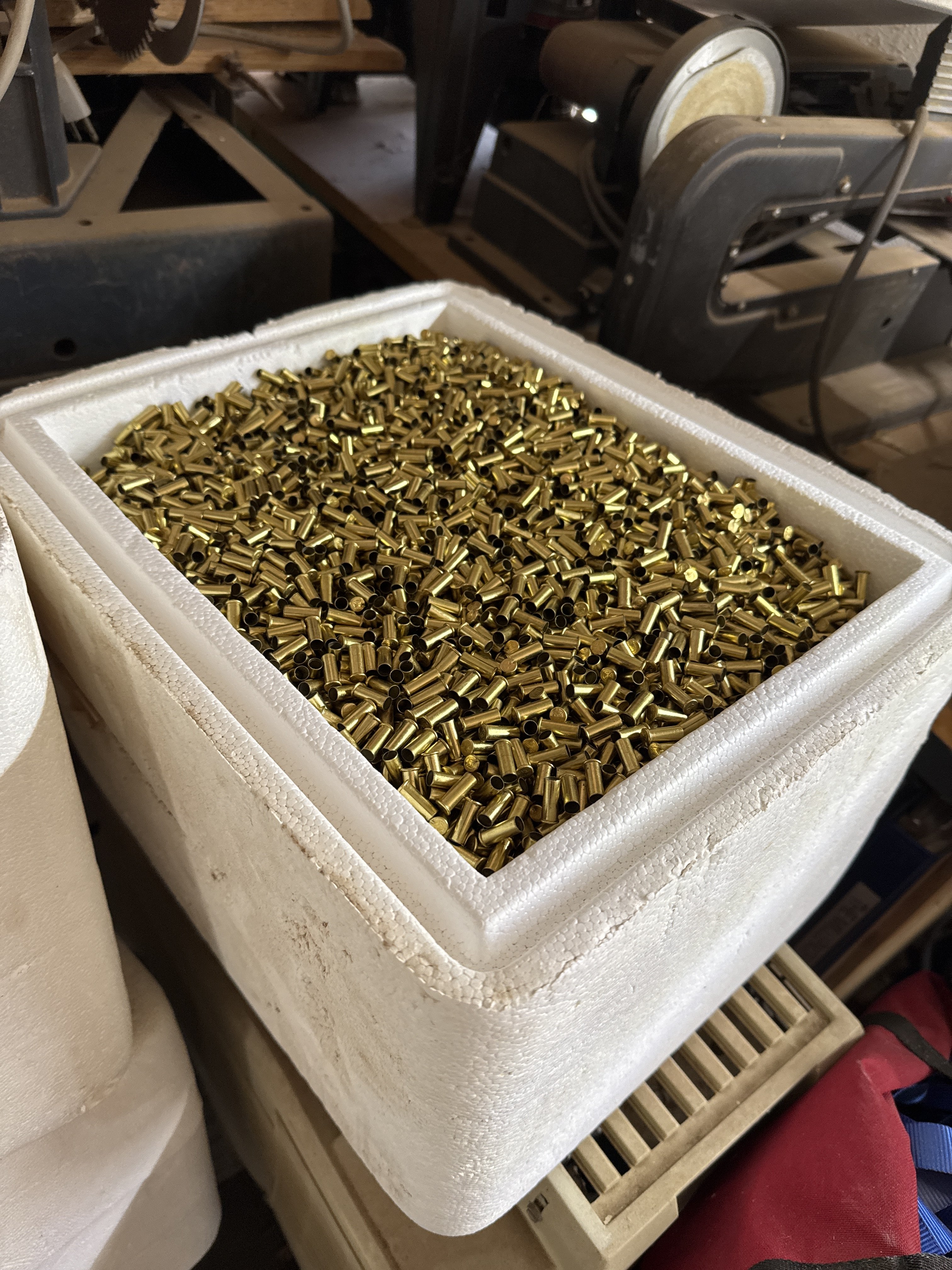

The gun isn’t the expensive part. Feeding the beast is the expensive part. This is the brass from 2024.
The $6000+ rig is not trivial. I shoot mostly Lapua Center X, Long Range and Midas+ so I agree the ammo cost, even if you can find them, is not inconsequential either. However, with your accuracy request you will probably need to be shooting slugs. The cost savings, particularly as your find the need to be .22 or higher, is going to dissipate pretty quickly. Quality slugs, particularly over .22, are increasingly spendy as well.
