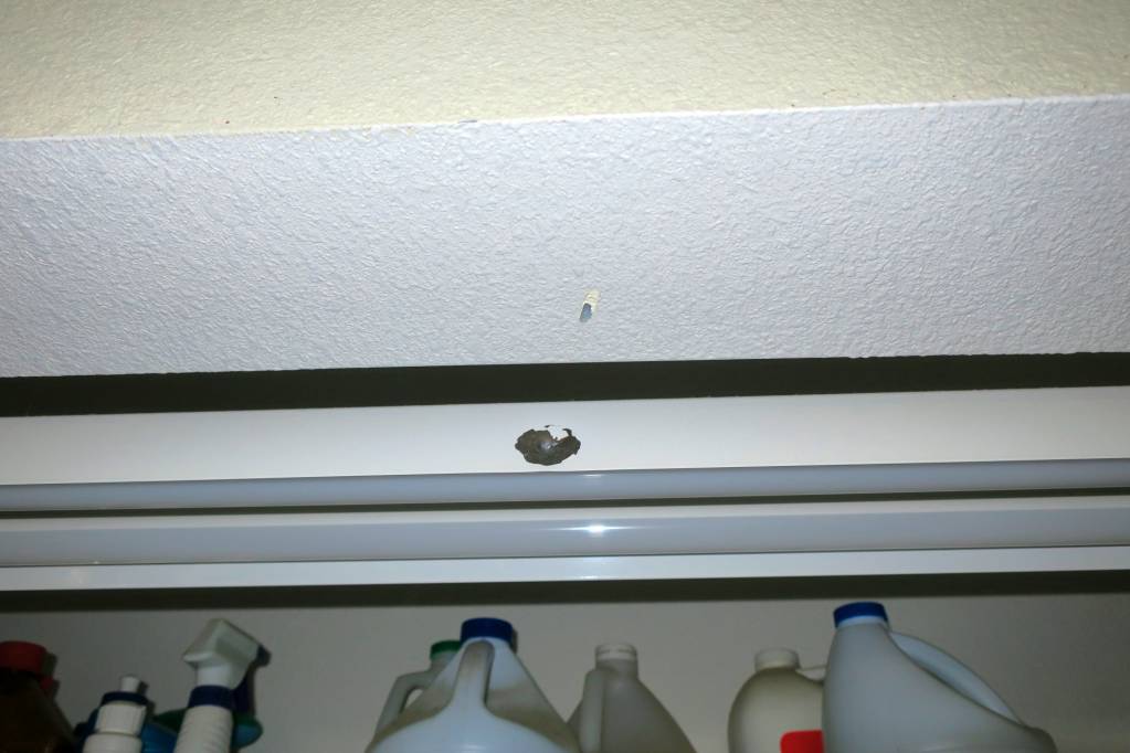

Like LMNOP I dry fire (without magazine in place) 2X before ever putting a gun away (and it is the last thing I always do right before packing up a gun which I have sold, or one which I may have to send in for service). Also like LMNOP I verify after dry firing that I have a dead trigger.
One thing I do which is different - I don't refill the gun's air before putting it away. Someone some time ago mentioned to me that storing the gun at full pressure is hard on regulators (and I own 99+% regulated guns). He said to store the gun near or just below the regulator set pressure, and that will prolong the service life of the regulator. Not knowing any better (then or now) that is what I have gotten into the habit of doing. This other guy knew a whole lot more about airguns than I did.
Have I been perfect in regard to my airgun safety? Well, no...
This is a (now customized) light fixture in my garage. I do know that whenever I get a new gun, the first thing I now do is dry fire it (without magazine in place) in a safe direction. (New gun, however, was not the cause of the above incident). And I take seriously the responsibility of knowing the status of my air gun, just as I would with a firearm. These things are not toys.
