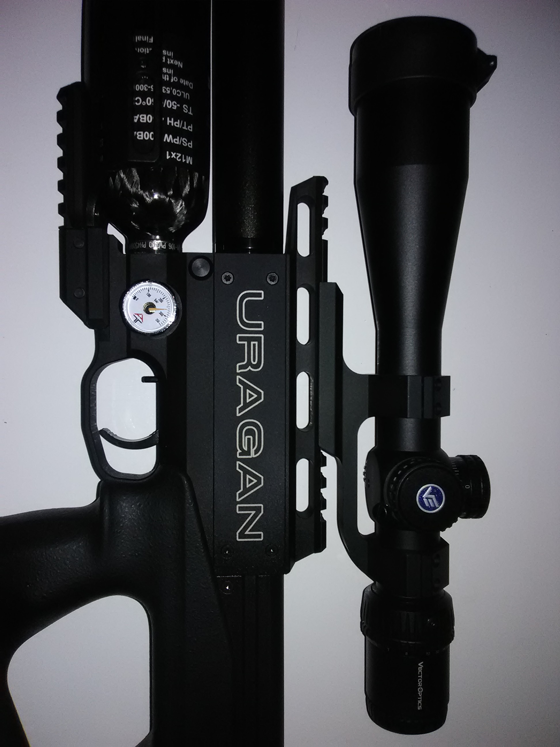

Vector Veyron 6-24x44 FFP (Non-IR). Just bought my third from Optics Warehouse (UK) for $261, to-my-door. Super compact, lightweight, quality built and clear, bright glass. I use the WestHunter cantilever mount (pictured) since the compact size makes eye relief and scope mounting, with standard rings, awkward. Bushnell scopes also feature clear, bright glass. WM

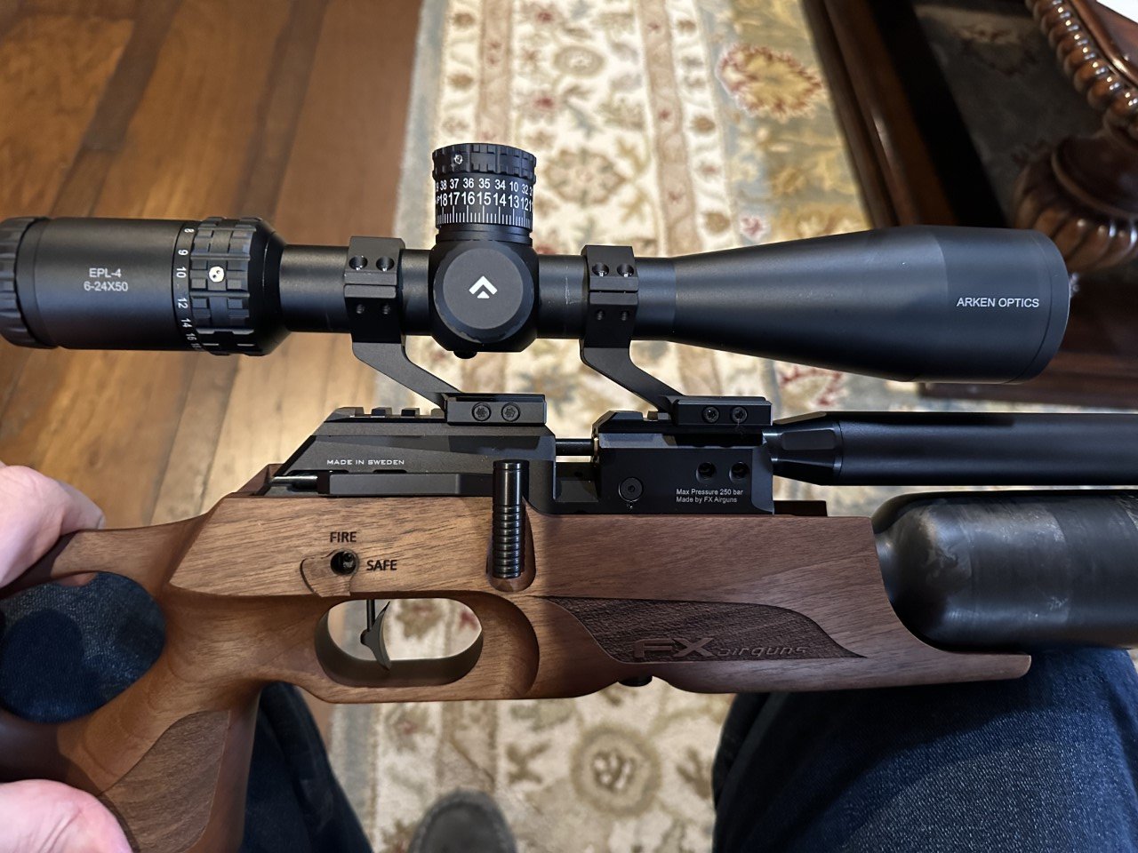

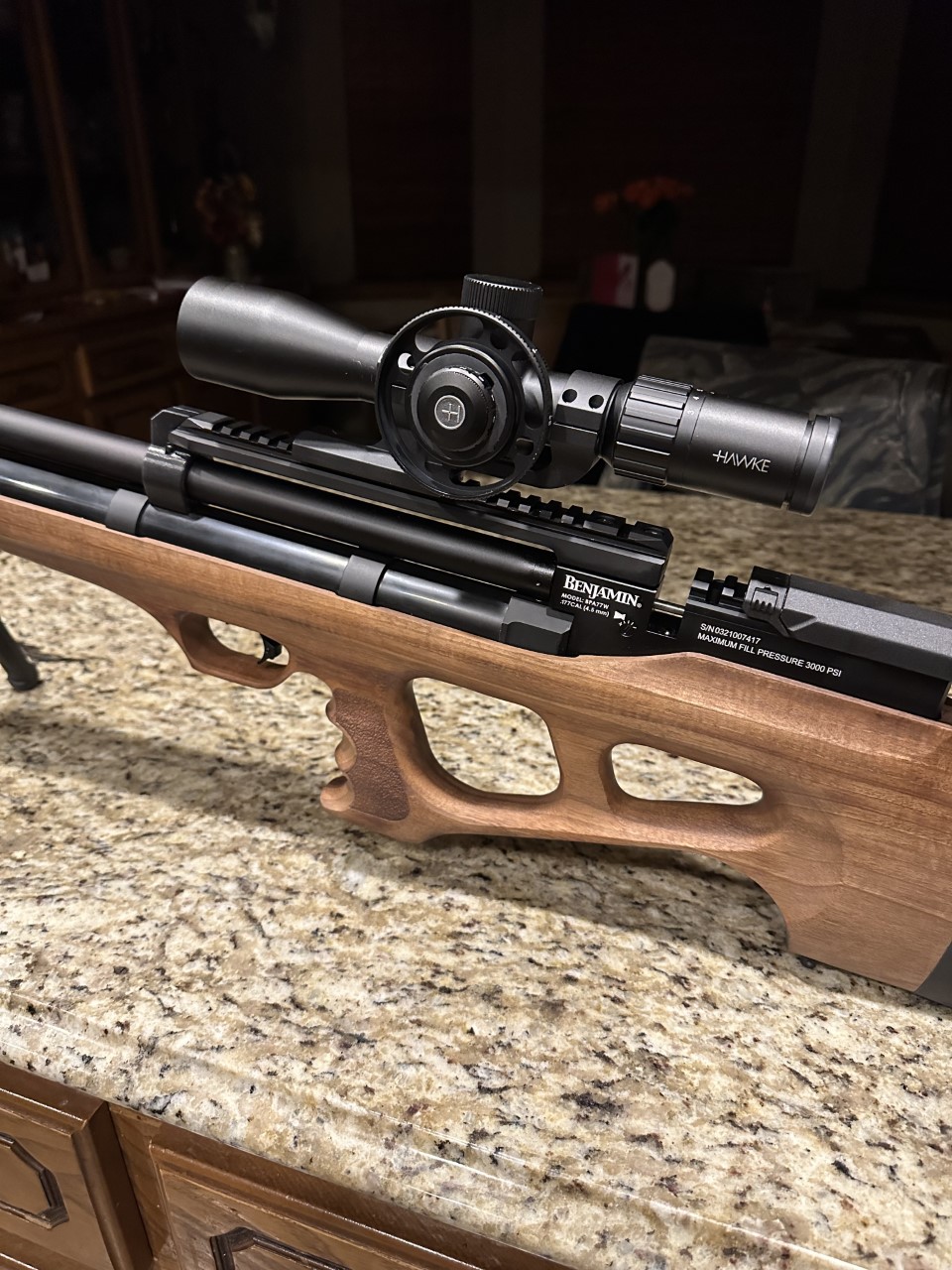

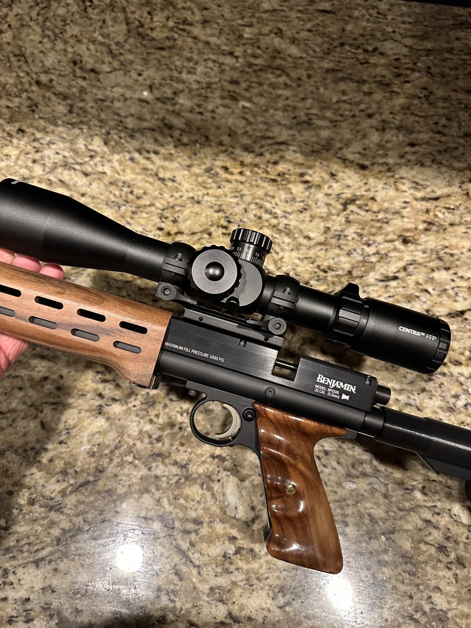

Expect to pay more for first focal plane (FFP) glass. Japanese glass tends to be used in the best mid-range priced scopes. I have an Arken EPL4 FFP I paid $400. I mounted it on an FX Crown and it has really enhanced my enjoyment of the rifle. I agree with JimD to avoid the Bug Buster. I tried one but gave it away to my grandson on an M-14 Springfield Armory under lever I bought for him. I also use Hawk optics as well as a Centra FFP scope. Can't remember what I paid for them, but 300-400 bucks will get you some good glass that will perform. Obviously, depends on how much you spend on a rifle. Also, with a scope used on an air rifle I would make sure it had parallax adjustment down to 10 yards. I try to avoid cheap Chinese scopes. Philippines and South Korea generally make good scopes though. You can also find vintage U.S.A. made scopes on ebay (older Weaver, Burris, Leupold, Bushnell, Simmons, Redfield etc) Most of these are 1" tubes, but they generally have superior glass. I own alot of them in my collection of vintage rifles.
