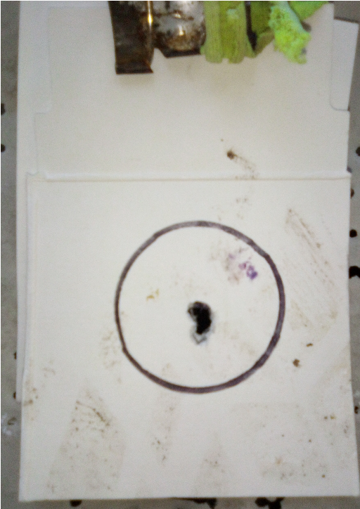

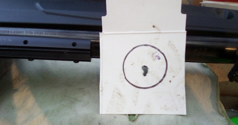

Was just shooting 10m on irons , cphp 22 with the ol'whamo gamo.. 5 shots
I guess good enough for sub 200$
Walmart.?
Then I posted that 50y the other day..
Oh come on Hateful! Let's kick up some dirt! Don't you want to have fun anymore?
A digital shooting match sounded fun to me. We seemed to be the perfect opponents. Cheap springers, iron sights and attitudes. We could take that $h!t on the road bro!
If you don't want a shooting match on the forum that's cool. I'll buy one and shoot it myself against a Hatsan. If you say it shoots better I'll believe you.
What model is it? Give me the specs and I'll buy one just like it.
I can't shoot 50 yard groups with a Hatsan anyway. I could put 10 shots within 1.5"-2" on a good day. I figure from your photos you have me beat already. So I'll forfeit the match.
LOL. I like your spirit!
