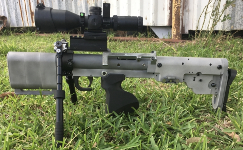

This is my chaneke.22 lr bullpup full suppressed

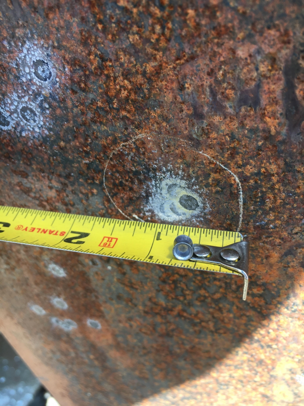

Once you have all the gear, including the compressor you will be able to shoot quietly and cheaply if you choose .25 caliber or smaller. And in my opinion you can have the same accuracy as the .30 cal. Maybe not as consistent in the wind, but definitely incredibly accurate. This group is at 130 yards with a .20 cal. Theoben. My lifetime best group so far, but if there’s ANY wind it’s impossible.😉
