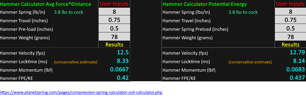

Attached is a basic spreadsheet that will calculate all of the above data. It may be useful to someone so, I thought I'd share a stand-alone of these calculations, available as XLSX.
Keep in mind this is a simple spread sheet meant to represent the relationship between hammer travel, hammer spring pre-load, hammer weight. No losses are calculated in the sheet currently, such as gravity, friction, angle of shot, and air resistance.
*edit* modified the spreadsheet thanks to @caliusoptimus for pointing out a flaw in a calculation, spreadsheet now uses both Average force * distance method and a Potential energy method provided by caliusoptimus.
-Matt
View attachment Hammer_Data_Calculations_V3.xlsx
-Matt
