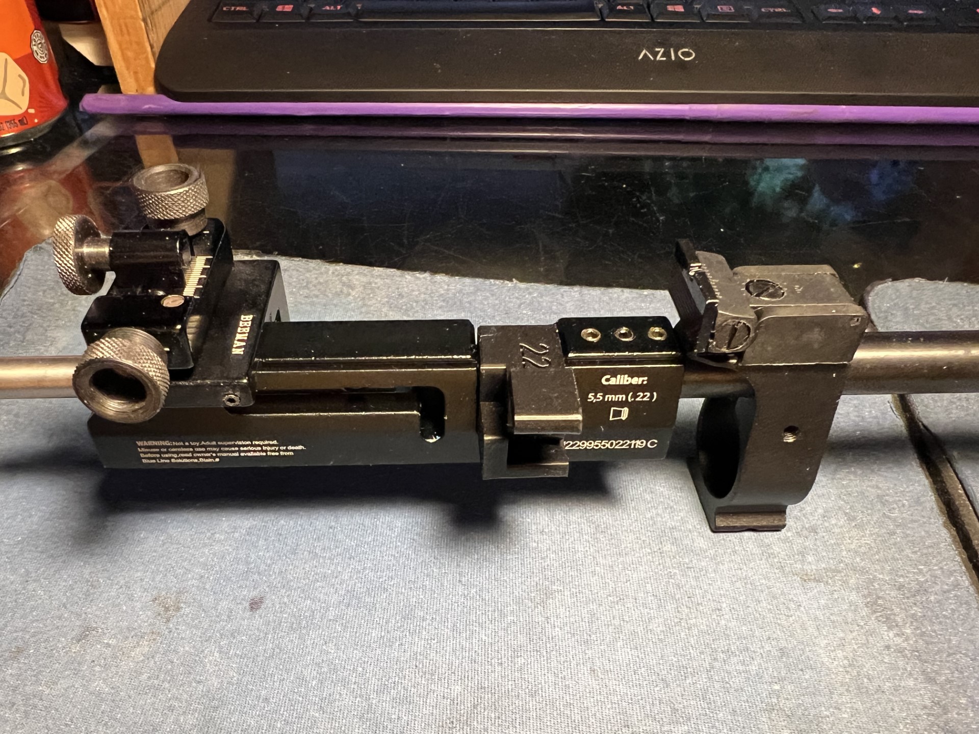

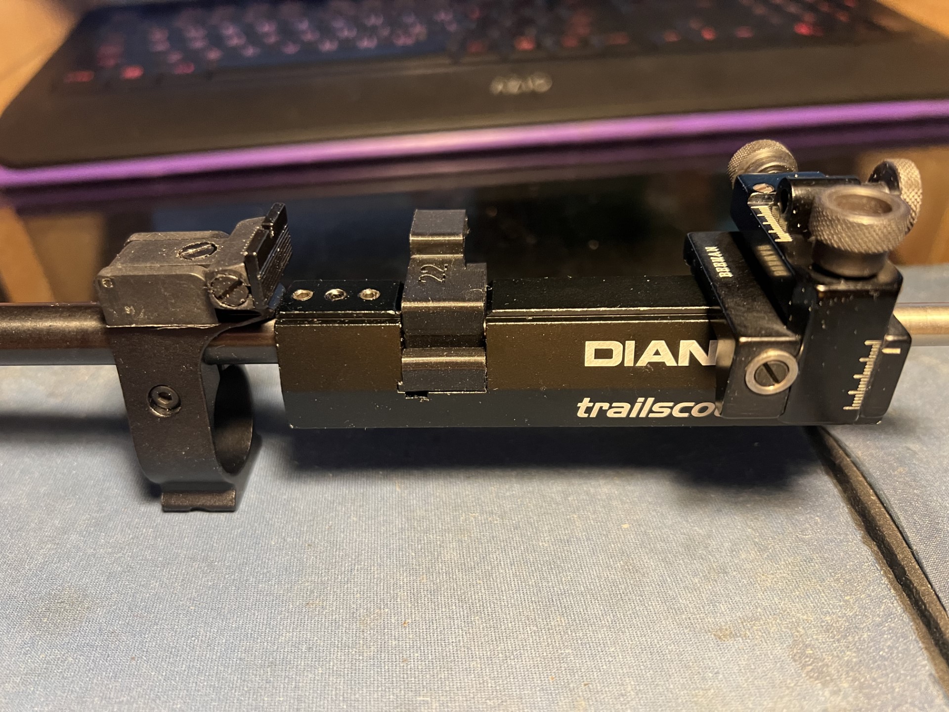

only for you i made up a mockup of the rear sight from Williams on a righthand Snowpeak breech with a Chaser pistol barrel and a Chaser rifle barrel band mounted sight
the lowest the William sight dead center in the peep will go is 17mm whereas the barrel band sight is at only 13mm off the top of the breech
and that my friend is a problem because it is damn close and what will happen is it could shoot low
that's all i can do for you if your sight as adjusted now to 17mm it might work
i hope you can see my thinking on this

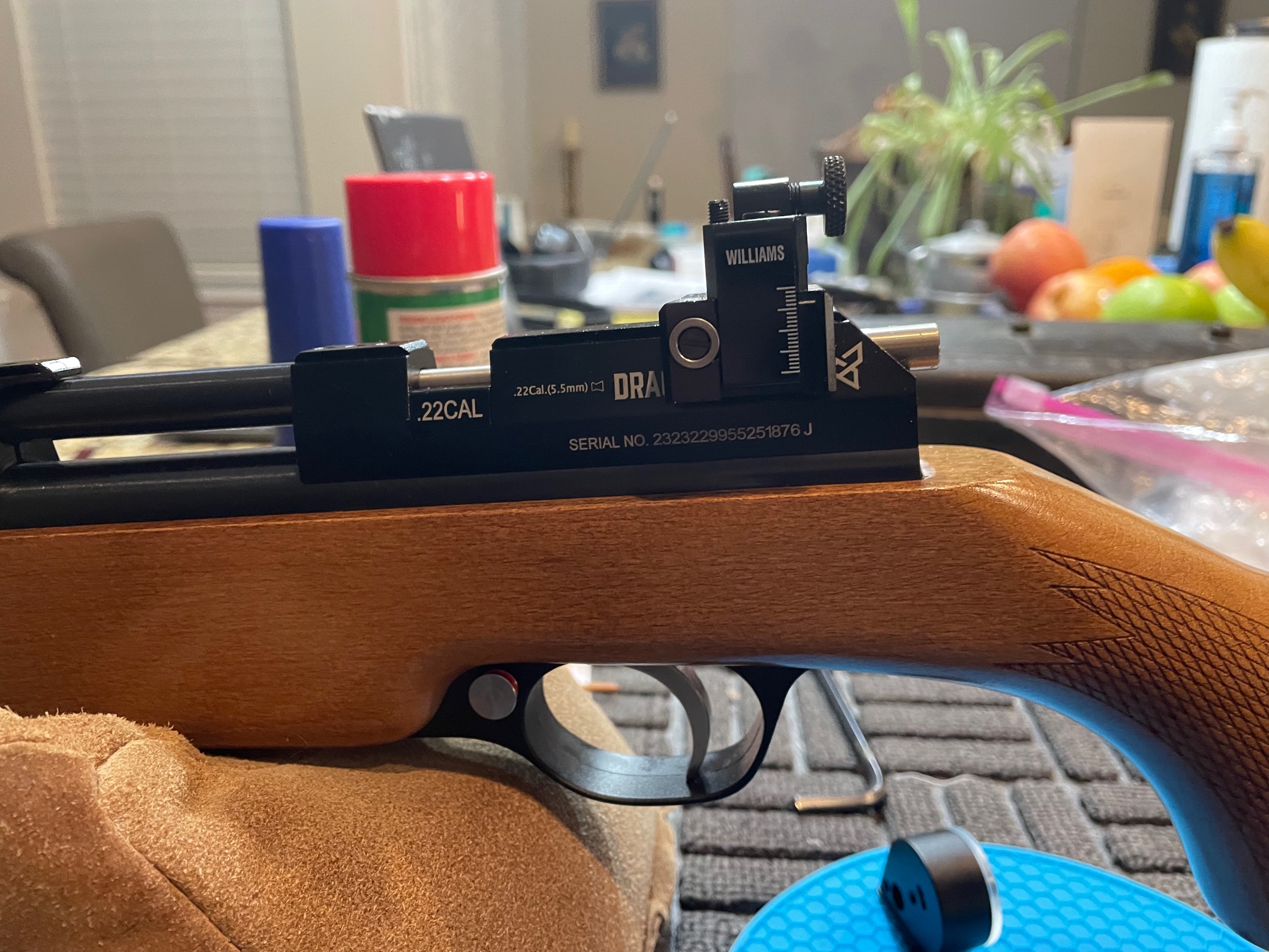

I believe it is the FD-AG sight Bear-of-Grayling shows above but I am not sure because I have multiple Williams' Foolproof sights on various rifles. I have mounted several on air rifles and I think they all work if they have a base that fits an 11mm dovetail rail. My best guess is that this particular sight is the AV-B70809 w/5D-AG.
My backyard range only goes out to 26 yards and most of my shooting is at 10-15 yards so my sights are set low on the elevation adjustments. My guess is there is plenty of adjustment left to go out to much longer distances.

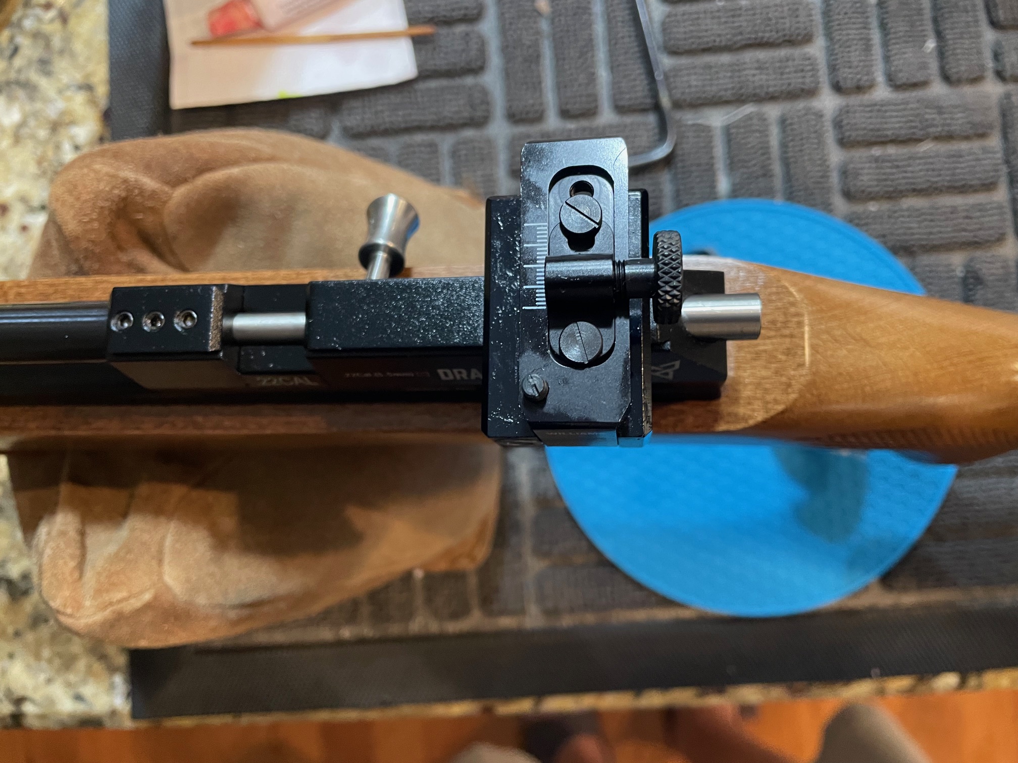

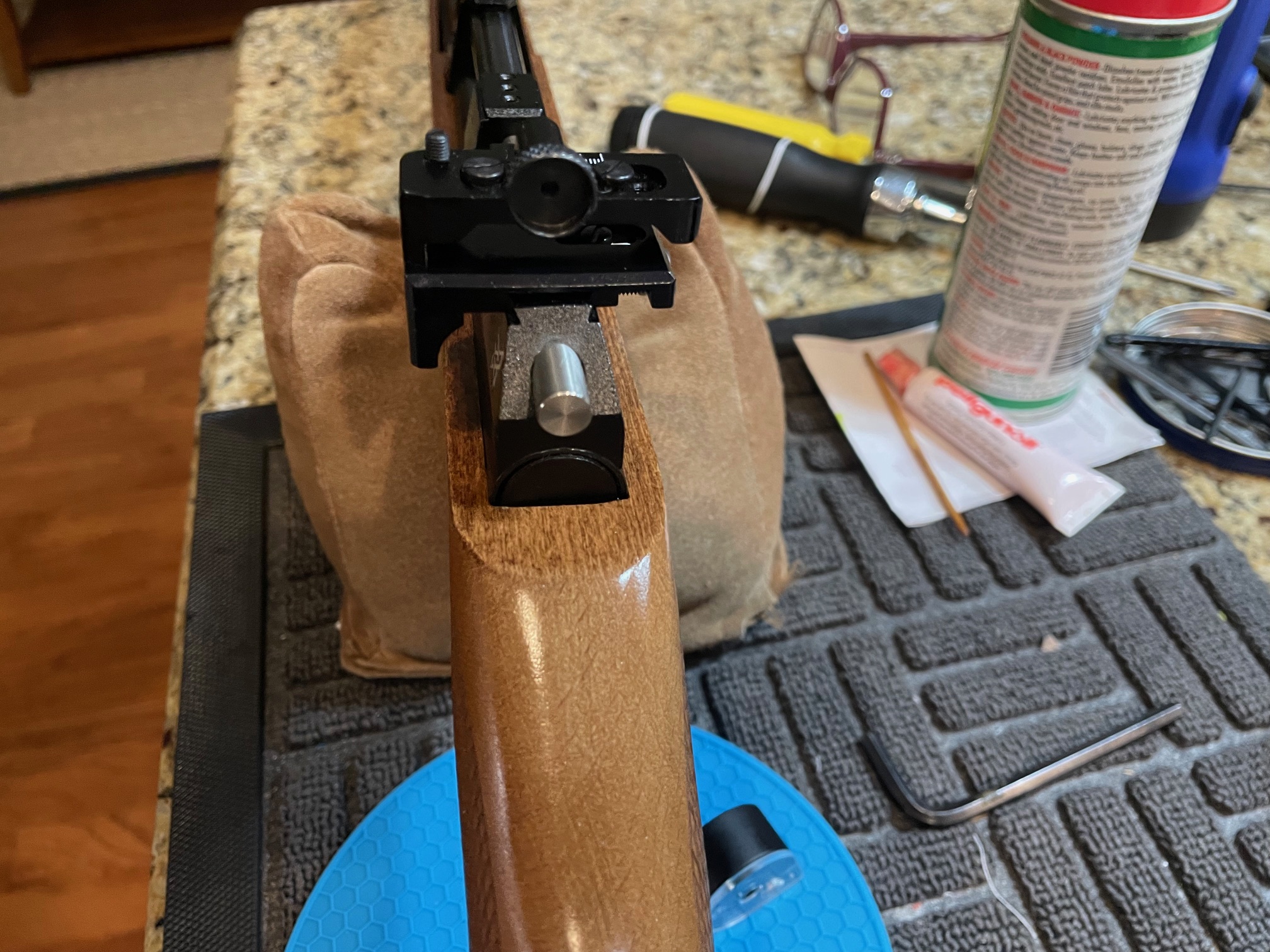

View attachment 448007View attachment 448008View attachment 448009
I didn't get a notice when this post came in, so I missed it. I'm glad to see that on a Dragonfly. Now I know for sure that it will fit. Thank you.

I assume that the peep sight is high enough to clear the magazine, but can you verify? Thanks.
It would be truly exceptional if you can't make a Williams sight work.
Following up on marflow's notes and mockup, keep in mind that a peep sight does not change the gun's line-of-sight. If you're sighted in with the open rear sight, the aperture will work as long as you can line it up with that. The big magazine may cut off some of what you can see below the aim point - but no worse than is so for any "notch" type open sight. And if worse comes to worse, ditch the mag and shoot in single-shot mode.
To put it another way...take a ruler and get a rough dimension from the gun's mount rail, up to your current line-of-sight. Then one of us can easily confirm whether it falls in the Williams peep's adjustment range.
