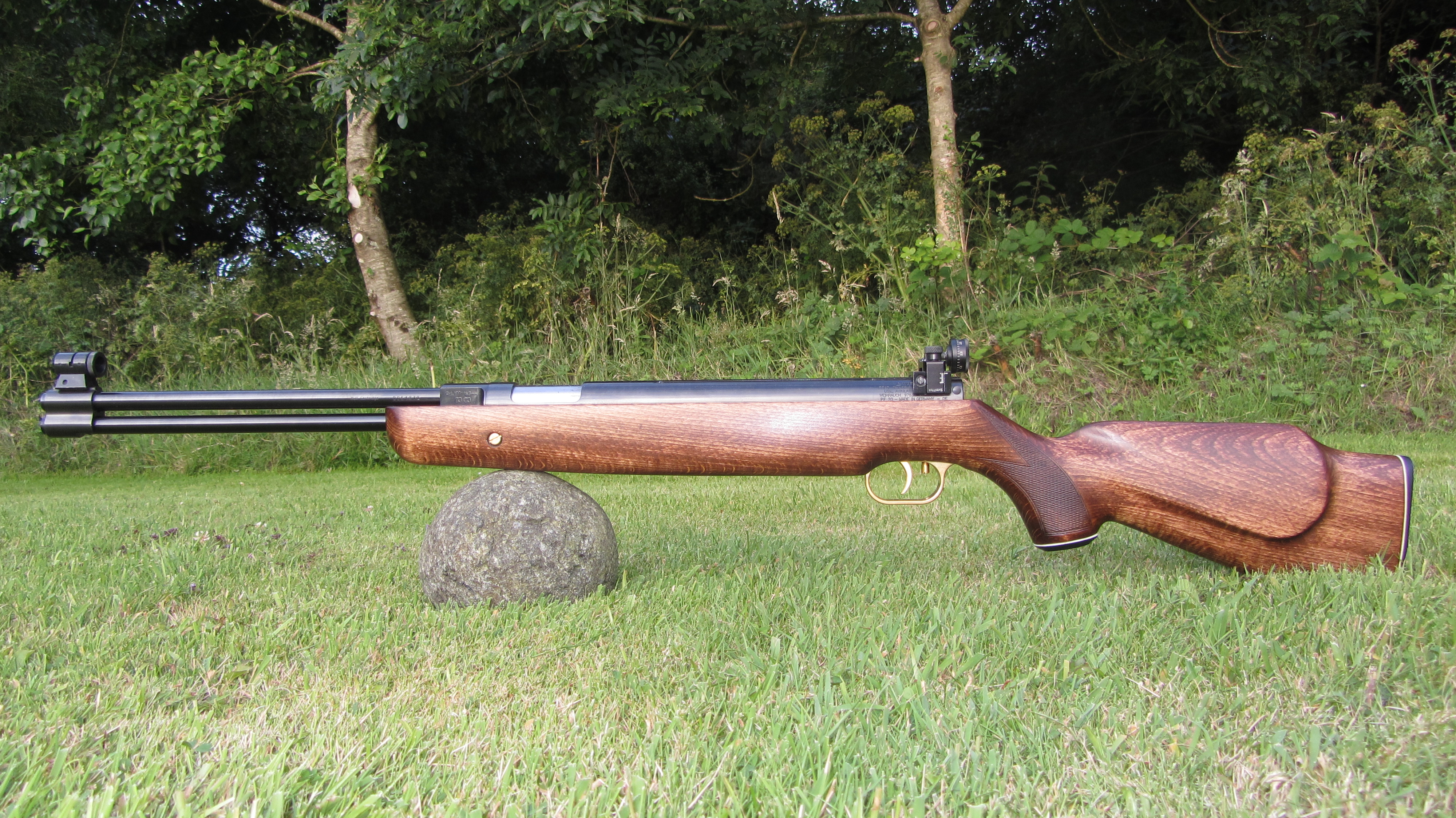

This is my hw50 (99) to me in the UK. If nobody makes them on this Forum and I am surprised. Then Join the Airgunforums and ask the question and get somebody to pop one in an envelope and send it to you. Very cheap and a nice neat job. and a very similar Forum to this excellent Forum. Not touting for members just trying to help. :)

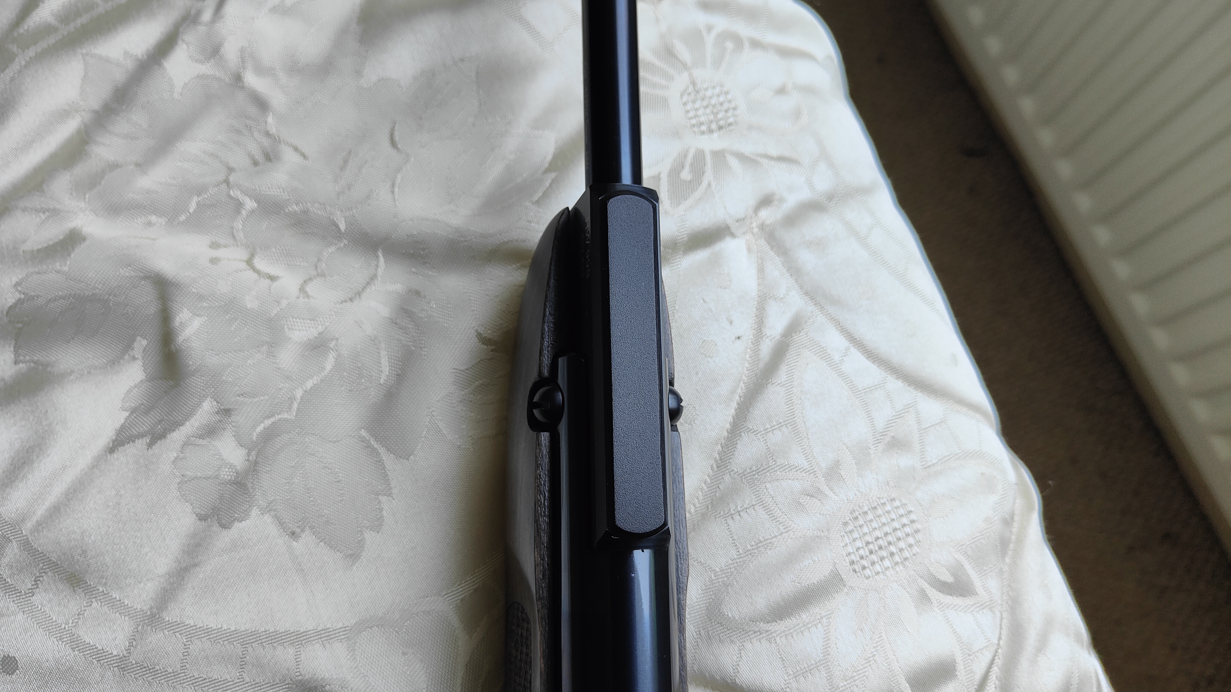

I asked a similar question a while back and a member replied that they removed the sight leaf and re-installed the original cover & screws; that's what I eventually did and it works great! :)
BTW, the above hole cover is about as nice a solution as I've seen 👍
Where can we get the above hole covers? That looks nice!

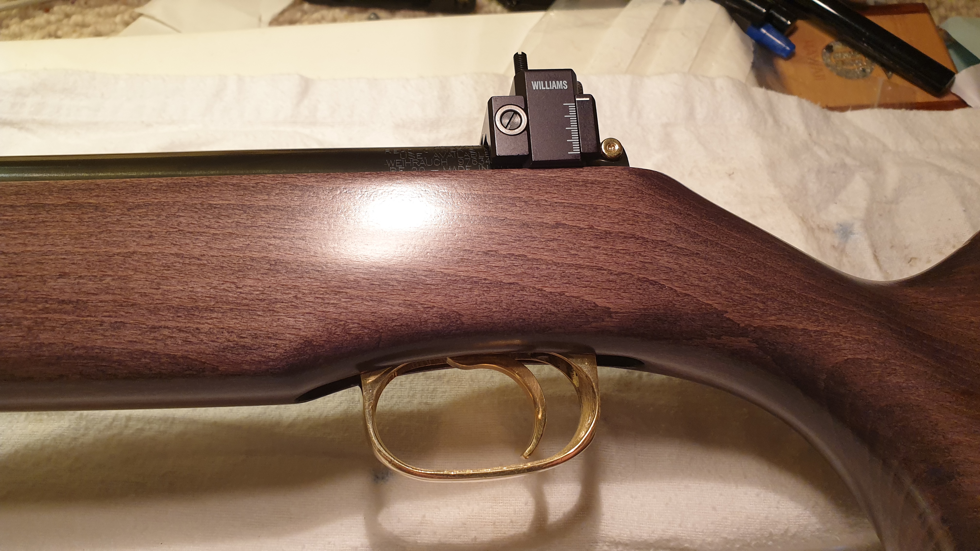

I'm feeling down...the Williams peep sight I installed on my HW50S has begun the creep...I can't tighten it enough to stop it without bending the light aluminum base. I will need to find someone with the machinist equipment/ability to drill and tap a stop pin in the sight base. Bummer too, it was cock for dolly on the rifle, I'm back to the less than ideal factory open sights ( for my liking at least ) for now. Just an early morning rant, thanks for taking time to read it...lol
Should not creep. I have had several most on 50s never ever creeps. You can lean on that little screw far more than you think you can. Give it a bit of wellie.:) be sensible about it but if its creeping odds are its not tight enough.
Hints:
1. De-grease all contact points thoroughly.
2. Take out the little grub screws on the side. File or stone flat the ends that contact the body of sight (they have kind of a sharp little ridge on 'em when new). Put a little dry lube (I like lithium grease) on the ends when assembling. This will let you put more tension on them without digging holes in the sight body.
3. Take to heart what the instructions say about going back and forth between the top and side screws. Work slowly and carefully.
4. IMHO, it's no problem if the base of the sight does bow up a tiny bit.

This. I’ve had one on a Diana 34 for 6 months and it hasn’t moved and that gun has a good deal more recoil than our HW50S. I used a toothpick to apply a small bead of Loctite to the rail as recommended by Hector. Let everything sit overnight before putting back together and shooting. Those small Allen screws are used to adjust the width. It’s the top screw that has to be snugged up. Good luck.

Thanks, for the suggestions, I'll give it another try, I was using the small allen screws to tighten the sight to the rails, That's where the pressure was coming from that was causing the base of the sight to bend. I was using the wrong part of the sight to put the pressure on to hold the sight in position. Makes sense now that I was doing it wrong.
