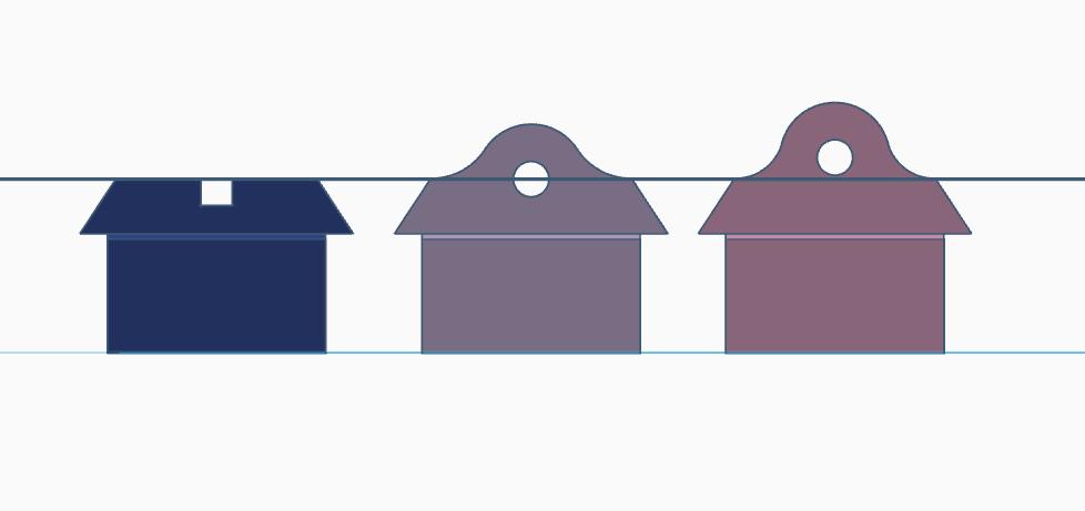

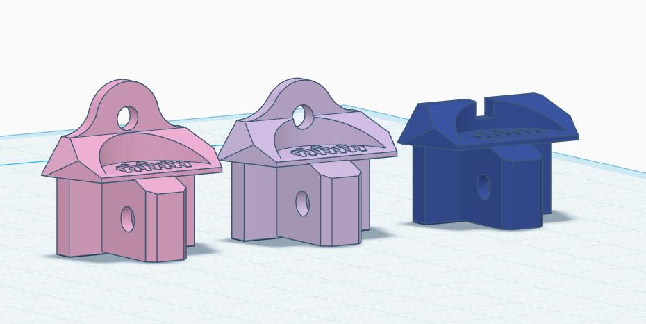

Any idea what a good aperture size may be? I'm working with someone that is 3D printing the rear sight for a Daisy 717/747. This would just replace the notched rear sight, elevation and windage adjustments would still be there.I am a very big fan of peep sights. I'll put them on most anything... But I've never tried them on a pistol. I guess it would be more of a ghost ring like these pistol sights.

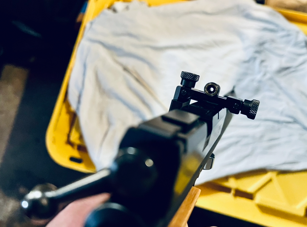

I am sure those particular ones would not work on an air pistol. You would probably want some sort of elevation adjustment. And then you have to fart around with the front post too. I was able to rig up an acceptable solution on my Gen 1 Mrod using a Williams AG FP TK rear sight and then 3D printing a front sight that would attach to the muzzle end of the shroud. Getting that front post the right height to get maximum adjustability from the rear sight was a lot of trial and error, but since I was printing them, I could run as many as I needed until I got it right.
But all that said, I am not sure that a Williams or similar off the shelf aperture is going to be large enough to use on a pistol even if you remove the smaller screw-in aperture it comes with. And it is a little pricey to find out.
I used rubber cement (very removeable ) and brass washers glued to the 717 rear sight . still in progress to find the right size .Any idea what a good aperture size may be? I'm working with someone that is 3D printing the rear sight for a Daisy 717/747. This would just replace the notched rear sight, elevation and windage adjustments would still be there.
