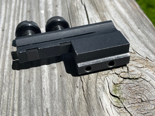

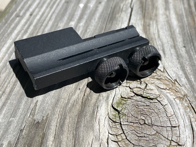

I thought I had some limited experience with peep sights, but mostly because of the battle rifles I used during my Army career. But recently a member here (Beard Of Grayling) got interested in improving the Williams Foolproof Sight by designing and crafting an extension, iris and sunshade for it. It was never intended to be a production item for profit and only a few were made, which he made available to members. I was one of the lucky ones and it has been a revelation to me how much difference an extension, reduced iris size and sunshade can make.

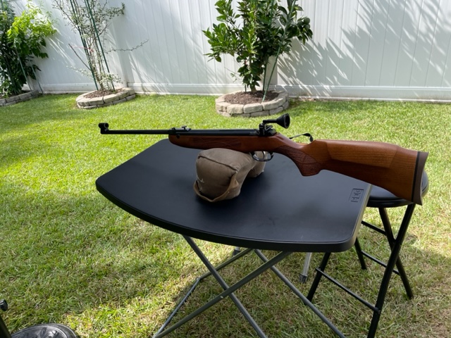

Here it is on my HW30S, which I just bought when I knew I was going to get the package from him.

Thank you sjs. It’s appreciative members like you that were the driving force needed for me to make some extensions up. The eye shade and small iris really do make a huge difference to the Williams sight. Especially for target/plinking. Don’t think you will find a better/cheaper sight than this. Not many to pick from is partially why they are pricey. But the popularity for the diopter/peep sight is growing. Maybe more options will become available. Hopefully not China made versions. I think the Williams is still U.S made. Thank you for your kind words.

Just in case of interest, I posted the Williams “Eyeshade ONLY“ in the classified. The shade makes to much a difference to me not to offer it to everyone.
