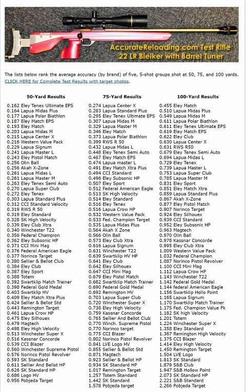

Very good point Mike! I'm glad you brought this to light. Ha, I want to poke my eyes out when I look at my 100Y EBR practice targets, lol.
Azuaro, yeah I believed you but I was wondering if Jiikuu had seen anywhere close to how consistent a good rimfire could do at 100Y. As it seemed he meant a PCP air rifle with slugs could do "anything" a 22rf could do. I must have misunderstood???

Now let's talk about the bullets...I don't see any limitation for an airgun slug to be manufactured with a similar or even higher BC than the average .22 RF bullet, you make a G7 or a closer profile slug with a good sectional density (40 gr. - weight) and you are already there regarding bullet design. Loading the much longer new slug into the breech or into a magazine or the airgun is another story....Lastly, push the slug at 1030 -1080 fps (Average velocity for Lapua and Eley best BR cartridges) and you are NOMINALLY ahead of the game...Note: ELEY Tenex uses 40 grains with a BC of .150 and Lapua Center-X 40 gr. with .132 BC and both cartridges have similar benchrest precision.

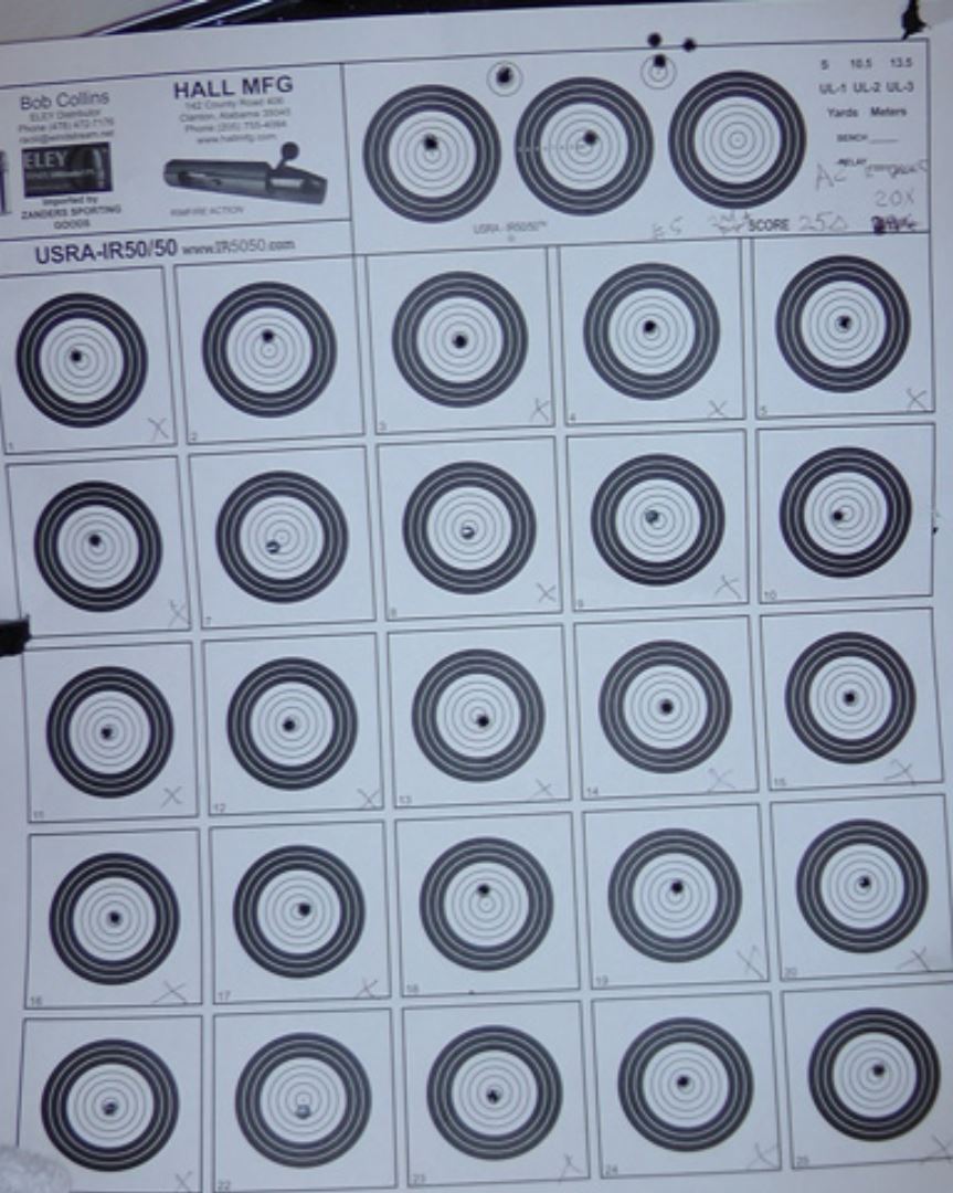

Now, there is an issue that is worth mentioning: The .22 RF with its current bullet profile was designed for shooting at 50, not 100 meters...We BR shooters push the envelope to 100 to magnify the errors, if it performs very well at that distance it will be a killer at 50 M and shorter ISSF distances...
G1 and G7 projectiles and for that matter all the G's in between these 2 profiles perform better at LONGER distances than 50 M, at 50 they are not fully stabilized in general but the rimfire bullet is...So when we compare the .22 RF with the .22 Air at 100 M under identical parameters and giving the airgun the advantage of shooting a G1 or G7 slug, we are putting the airgun ahead of the game...Or so we think!
